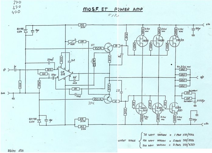

Yes maf_au you're on track. generally when I design an amplifier I include drain down resistors for the power supply. They only need bleed 5 mA or so .. so that by the time the lid is unscrewed they're as good as discharged.
A8 - you designed this unit? So the pins 1,5 and 8 can be relieved of components to implant a OPA627?
Sorry I don't know the design so without a schema.. I'm working blind.

You're doing well. If you can permanently fit 22k 1W resistors across all your PS C's that would ensure some safety. They won't degrade performance.
The components on pins 1,5,8 can safely be removed if you want to use a OPA627. The 3K3 at the input filter may be picking up excess hum and noise, depending on the layout. Replacing with 1K or a parallel equiv might be worthwhile.
I wouldn't use an OPA637 in this cct.

Hi maf-au,
The 330uF are substituted for the 220uF in the input leg of the feedback loop. If they fit they'll be OK though you may have a slightly different thump at on/off than before.
One weakness of this type of driver stage design is that as the driver transistors get warmer for whatever reason, the design tends to deflect more current to the stage and turning on the output harder. It's only minor but a point. I have a similar design here I've been assessing. So instead of the bias having a neutral or -ve tempco, it's slightly +ve.

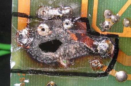

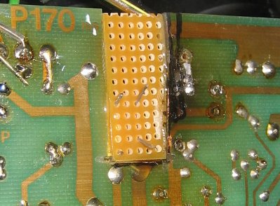

And here is the new piece inserted.
It's not pretty, but it should work ok, and it's a lot better than what was there before...
New caps are installed, just have to drill some holes for the MOSFET, line it up, do the point to point soldering with the other components effected by the burn, repair the pcb track I cut cutting out the damage.

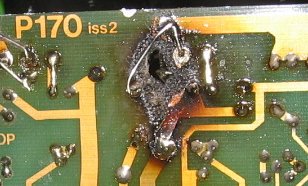

I've identified the components that link pins 1 and 5 on the LM318, and I think I can isolate them from the opamp without removing the circuit board again by using sidecutters. This has the added benefit of being able to easily reinsert them if things go awry with the 627's in place... Of course, I won't play with the 627's unless the amp powers up and plays normally with the 318's.
Any advice welcome, I'm a newbie at all this...

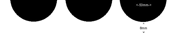

Cap support
This is what I'm thinking:
A block of nylon 15-20mm thinck as per the image below.
I can attach it to the floor of the amp with tek screws from below, lay the caps on it and ziptie them on. Probably drill holes in the nylon to pass the zipties through.
Michael

Topview. You can see the breadboard insertion, and the dots marking the cut points to detatch the components from the LM318 ready for the 627's
There's still a small amount of burnt board there. but it's not bad, and it's isolated. I didn't want to cut through the last remaining mosfet point...
Powerup in 15 minutes. If you notice something bad reply quick 🙂

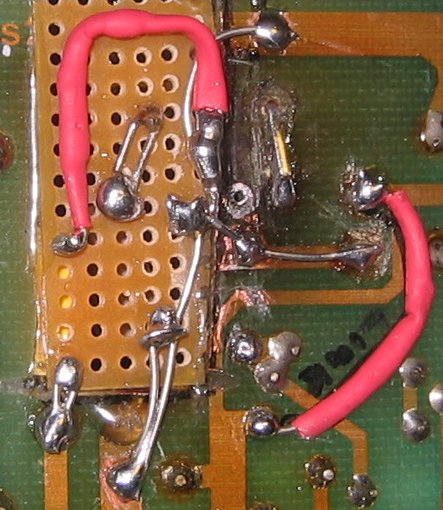

Bottom view.
I've checked and double checked this against the same circuit on the other channel, (it varies from the schematic because my amp has had it's mosfets replaced)
I'm no ace solderer, but I think the previous repairer was using a blowtorch! There is flux spatter all over the place, and he must have got solder at a discount - some of the powersupply connections are loaded with great gobs of solder...
