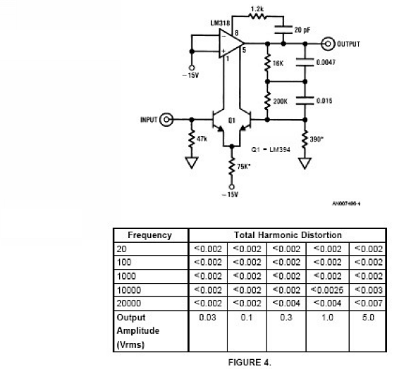

It's surprising that this LM318 circuit sound better than many others preamp, the LM318 are very good but an old op-amp and prone to oscillate, so most guy's said it was obsolete. Maby this circuit could be mod to do a good I/V amp for TDA1541.

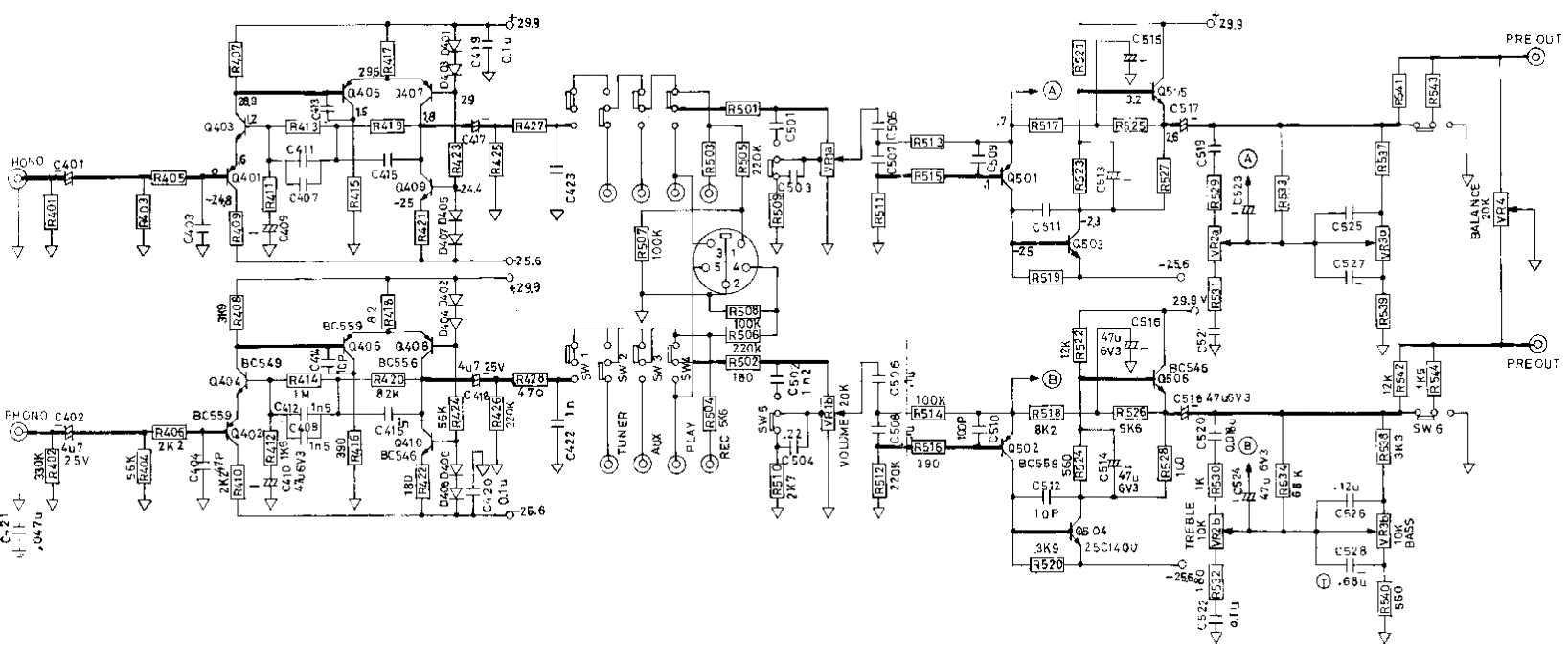

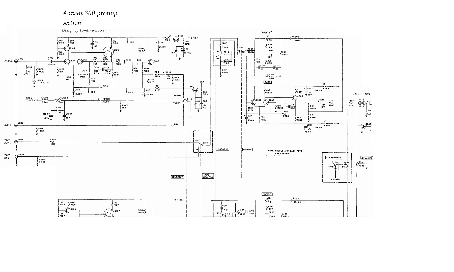

Tomlinson Holman design the first version of the Advent 300 and the first version of the Nad 3020. The phono input was unique. They have both an excellent reputation.
Here is the circuits of a LM318 phono but I never try it, and of both Advent 300 preamp section and the Nad 3020 preamp.

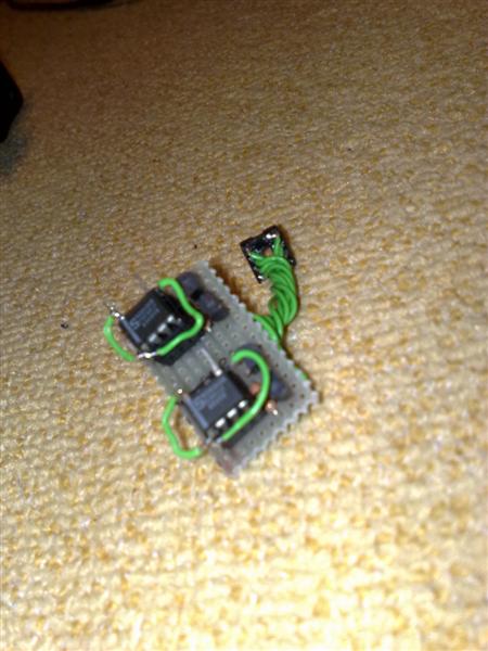

I made a small piece of veroboard to put 2 IC sockets and the LTP with BC550 (including the 33k LTP resistor). From there it goes to one IC-socket dual-type (for instance NE5532).
Now I am able to test my LM318 + external LTP on sound and noise quality in any standard preamp like a NAD. On the picture you see the 'adapted' NE5534 with some pins put aside and the pieces of wire.
When put in my standard NAD preamp (using 5532 in the line-stage, some feedback around it including tone-controls): LM318 or adapted NE5534 in this setting are problemfree and without noise. The LM318 can be got to oscillation though by twiddling with its position and/or the wires. The NE5534 just seems to play never minds its position etc.
So again: the IC + LTP can not be the source of the higher noise-floor.
