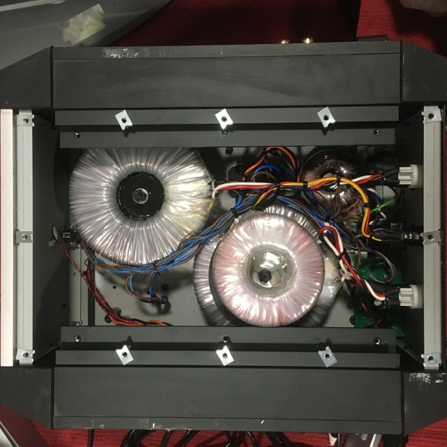

I’ve been fortunate enough to have been given this amplifier for free.
It does however blow the main fuse when switched on.
I’ve tested it with the PSU isolated and it blows the fuse almost immediately
I’ve tested it with only one channel (dual mono) and it blows after a minute.
There doesn’t seem to be much in there. 4 transformers. A pcb for the LEDs and two relays. Both potter and brumfield T92P7D22-12.
Advice gratefully received.
Andrew

The fuse is the correct, slow-blow, one? Big transformers have hefty inrush currents, you need the fuse to handle this. From what I can work out this unit has two big PSUs and a preamp PSU, all independently fused?

Quite likely those relays are part of an inrush current limiting circuit, and they have welded closed
I thought something like that.
I took them out and tested them. All switching ok and current flowing when they do.
There aren’t schematics available so scratching my head a lot.
Try with the transformer secondaries disconnected from everything. If the fuses still blow, either the inrush limiting circuit is not working, or the transformers have a primary side short

I have discovered an in rush capacitor showing signs of blackening.
Going to check that. If that doesn’t change anything. Then I guess it’s fair to assume the latter. Primary side short.

Changed the cap. Switched it on. Lit up for 10 seconds. Switched it off and on again. Ok.
Switched it on again. Tripped the main fuse.
I’ve disconnected the main pre-amp transformer.
This leaves the two main toroids and the small one which powers the LEDs and switched the relays.
If I switch in with one mains toroid connected it switches on fine.
If both are connected then it trips the mains again.

If you find ANY of those Rifa caps, change them! especially if they look "cracked" on the outside. These very commonly fail and fail as shorts - and usually go up in smoke quite spectacularly
I’ve replaced like for like. Though I read about them after I ordered them.
I’ll have to wait until Xmas to buy suitable ones.
Currently I can switch it on with both mains toroids connected. Pre-amp disconnected.
I’ve not left it on for more than 10 seconds. As I’m a little loath to keep checking fuses.
Both secondaries for the mains toroids are +-51v
Which suggests they are ok. I do t have a schematic. The toroid for the relays and LEDs seems fine. Which leaves the pre amp toroid and any issues with the inrush.
