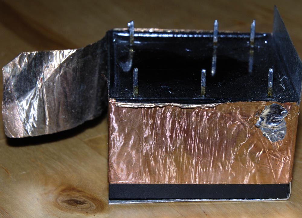

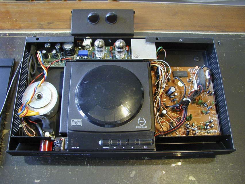

I own a Musical Fidelity CDT Player. It has a signal transformer in the begining of the tube output stage (see enclosed pincture. It's is a cube shielded with a metal sheet). One channel fails.
Temporary I have solved the problem connecting the stage without the transformer. I have inserted one capacitor and one resistor (the signal was too high) in the signal path and the player works again.
I would be interested in the service manual of schematic.
Does anyone know the transformer specifications?. Does anyone know what is the CD mechanism?

Is it definately a transformer? Would not surprise me if the shield was the hiding place for some op amps.
WRT modding, these units are notoriously quirky, if it works otherwise, I would leave it alone.
No. I think the shielded "brick" has two transformers inside. It has only three input terminals and three output terminals. One is ground and is common.
My "brick" has one channel faulty. I have tested the other one connecting a sinus wave signal and checked the output with an oscilloscope. The output signal is lower than the input signal.
Maybe the only purpose of the transformer is to supress any DC offset.
Without the transformer and inserting a capacitor in the signal path (before the output stage), the tube oputput stage and the CD work.

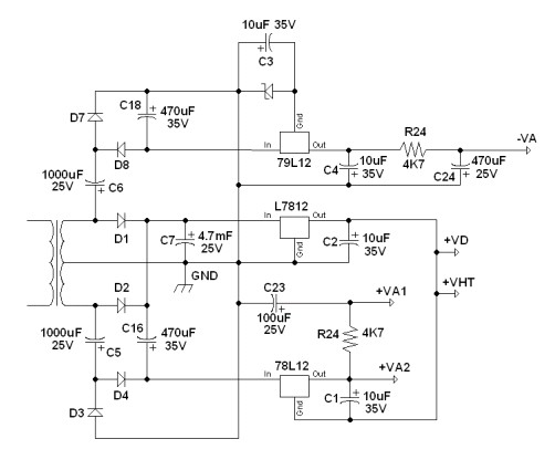

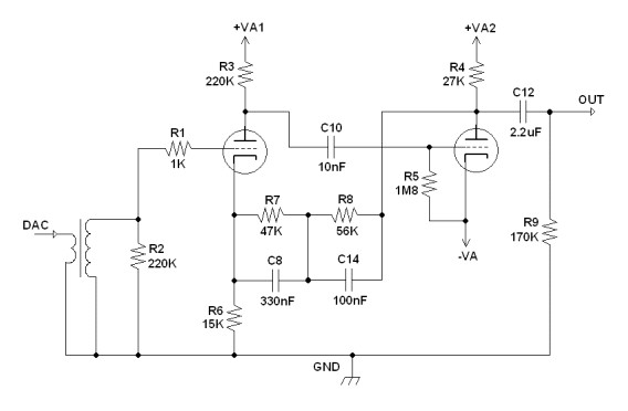

unfortunately I dont have the service manual. I have only these two schematics posted on audiostereo. Maybe tomant could help you, send him a private message (PW) via audiostereo.
If you want to tweak the CD I suggest you to bypass the trafo and NJM4558 opamp. I can send you a LC7881 datasheet.

regarding the schematic for the output stage;
does anyone know voltage for +va2, -va, +va1?
and what model valves are used?
plus any information on the input transformer?
thanks

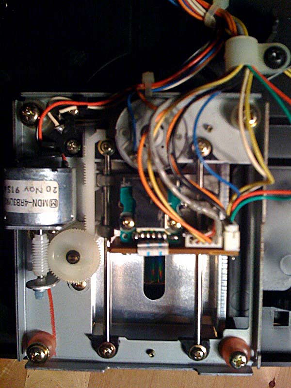

I often read it is a Sanyo SF-90 5/8 pin. There are several models of that player the one you (and I) have with the plastic lid is the older one, newer versions had a glass lid.
Mine has a spring loaded opening mechanism, I also read about hydraulic opening mechanisms (and their failures).
My CDT has a Sanyo SF-90 6/7 Pin laser pickup. Be sure to carefully check the pictures on the net before you get an exchange part, I got one from here: CD SF-90 6/7 PIN G?OWICA LASEROWA - www.100hz.pl

I think the CD mechanism is a Sanyo SF-90 5/8. Does anyone know any details about the transformer?.

The only fault on my CDT is the transformer. As per today I have not replaced it. Do you have any details about the transformer?

Transformer replaced
Following Per Lundahl's advice I replaced the faulty Musical Fidelity transformer, choosing this http://www.lundahl.se/pdf/1570_0xl.pdf
It's necessary to build a small PCB in order to adapt the pins of the new transformer to the holes of the output stage PCB.
The sound should improve because I am sure the Lundahl transformer is better than the original used by MF.
