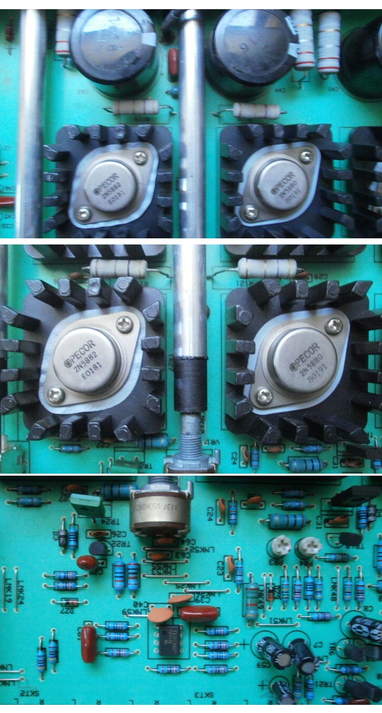

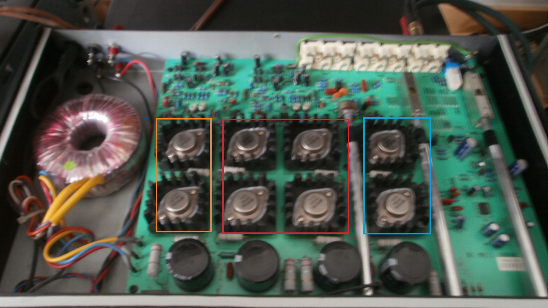

Overwhelming temperature on the Toroidal
The first 2n are hot the next 4 are burning and the final 2 are cold.
After 2min the amplifier shuts down and the fuse is blown.
Saturday I went to 3 electronic houses to see if anyone could help me with this problem and all of them said NO, of course with various reasons to that.
Should I change all of the 8 2n's?

It sounds like you have some transistors failed and they are causing a heavy load on the supply. It looks like someone already did replace them - MF usually rebrand the transistors. You may be better using some more rugged transistors like MJ15024/5 or MJ21193/4.
Chances are the driver transistors also failed. These amps are not really well designed to be honest - those heatsinks are far too small.
