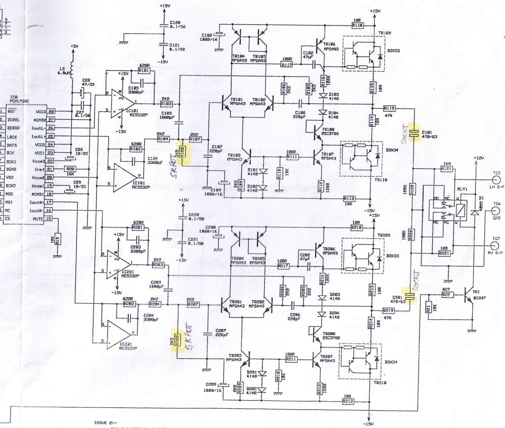

Can you explain what the C36 ... C42 capacitors are in the top middle of the double-page schematic, or what they are connected to? (ground at the top... ??? at the bottom)

They are all part of the power supply, decoupling smoothing caps together with the massive chokes, don't worry about them, there is no room for improvment in this area, just listen and enjoy now that you have finished all my mods.

I suppose I was asking because I was confused a little when I started looking at the board and comparing it to the schematics.
C37 has been replaced with a 29ohm R.
There is also a 100uF C straddling R26 (to the right of IC10).
Both of those changes look a bit 'ghetto' on the board, i.e. the design changes had not been made on the PCB.

I know this post is so old, so incredibly old but I got an old a3.24 and thought I'd give the easy part of this mod, as was the first post of this thread. Anyway after installing the trim pots and shorting the output caps I adjusted the dc to zero, and it has no audio output. I took the jumper wire off the cap and now it works. I noticed this dac has lower output than my Yulong sabre and the board on this MF says version 3. Did they make changes or what do you think the issue might be?
I swapped the caps for 220u / set the dc and it sounds far better than it did but sure wanted to try it capless
As per the diagram, it worked fine for me shorted cap, now dc coupled and the 5k trimpot in place of the 2.2k resistor adjusts for dc offset.
Set the trimpot for 2.2k before you substitute it for the 2.2k resistor.

I get zero output with the cap shorted, but normal with it, I installed 220u film and definitely a huge improvement but could still be more transparent. The $500 D18 Yulong just kills this a3.24 in every way except maybe in the looks department.
Just noticed on your schematic it shows 470/63 the caps on my rev3 board are 470/16 did they perhaps make an output voltage change?
