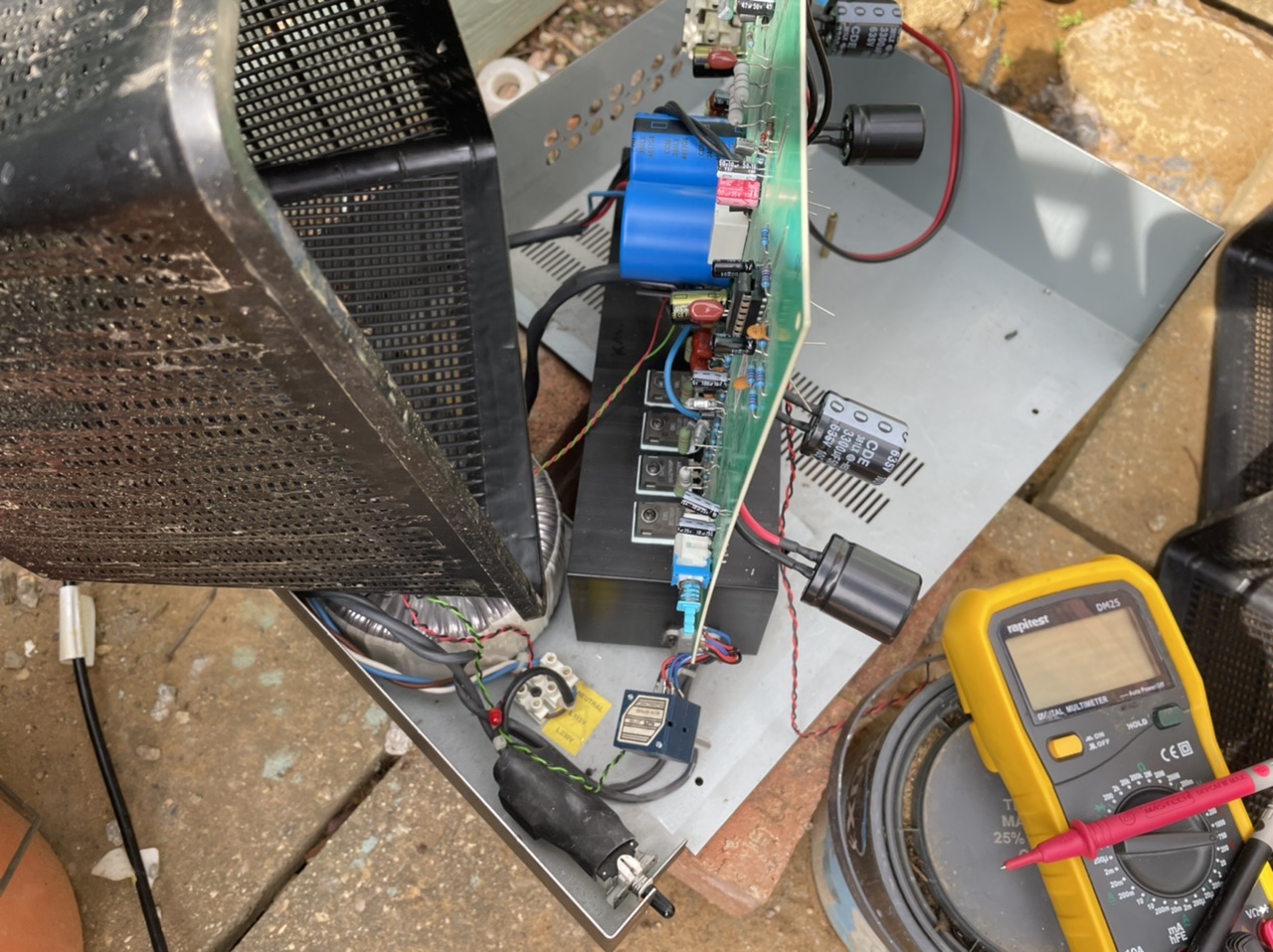

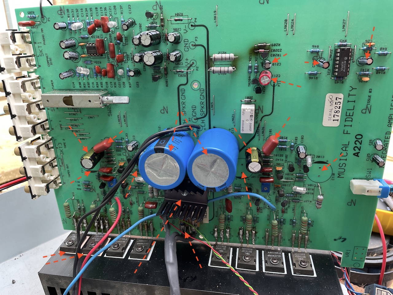

Update - all installed including 0.22 MPP (will try 1uF later). First non limited start outside.
I accidentally ordered caps with too wide pins for the 3300uF so i had to get a little creative. Will shorten/fix on the full install.
Currently sitting running into 8ohm resistors.
I love the smell of hot load resistor in the afternoon.. So playing some music from the CDP whilst checking the upper frequencies - there is something at 8.929MHz but given the case is off it's likely to be some RF. The amp is pulling current from the caps as you can hear the music from them (just close up).
It all seems very well behaved at the moment. Even the inrush seems very quiet compared to the old caps - possibly indicating they'd dropped too low in capacitance hence caused more ripple.

Here is what has changed:
Preamp
2x 10uF 10V -> Panasonic 10uF 50V EUU FR low ESR these sit on on the MC33079 opamp power line.
Main power amp rails etc
2x 0.22uF 35V electrolytic -> Panasonic ECW 0.22uF 400V MPP cap. Picked as it's a cheapish well know brand and replacing an electrolytic in the signal path is a good thing.
2x 15000uF 50V -> CDE 380LX 15000uF 50V 85degC. I picked these because these provide a ripple current of 6A and ESR of 0.020 ohms.
4x 3300uF 50V -> CD 381LX 3300uF 50V 105degC. Picked again due to their 105 rating and lowish ESR for the price.
Filter:
2x 470uF 35V -> Panasonic EUU FM 470uF 50V low ESR but not really needed due to it being a filter, however as they're cooked.. they get replaced with a 105degC piece.
Mute:
100uF 16V - Wurth 100uF 50V. Good name and £0.20 for the mute circuit.
10uF -> Rubicon 10uF 50V. Good name and £0.20 for the mute circuit.
Bridge Rectifier
BR104 400V 10A -> SiC BR104 400V 10A. I also have the direct non-SiC replacement pair in case it went pop.
Also replaced the thermal pads on the BR and two of the mosfets. The fuses.

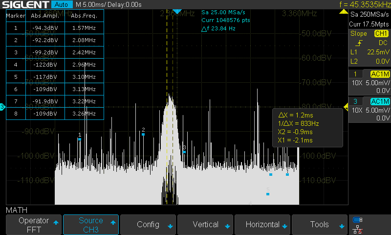

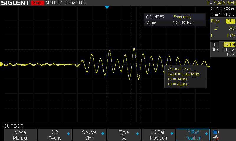

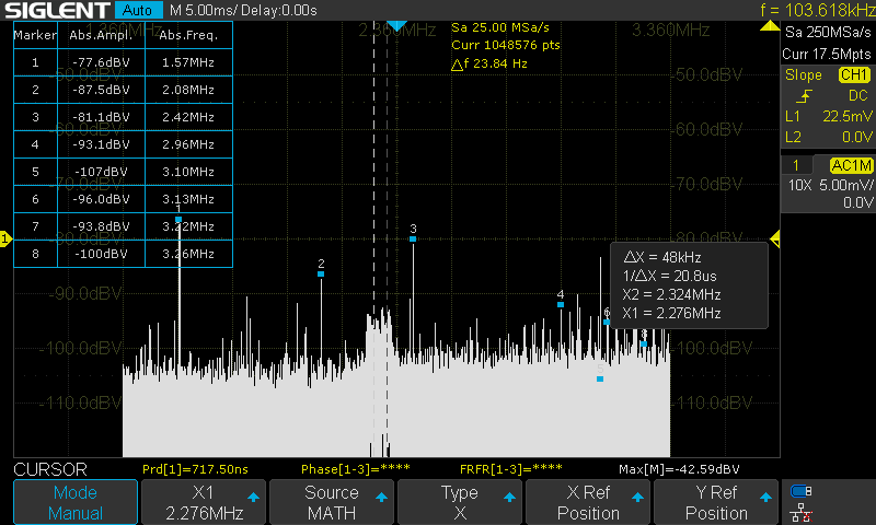

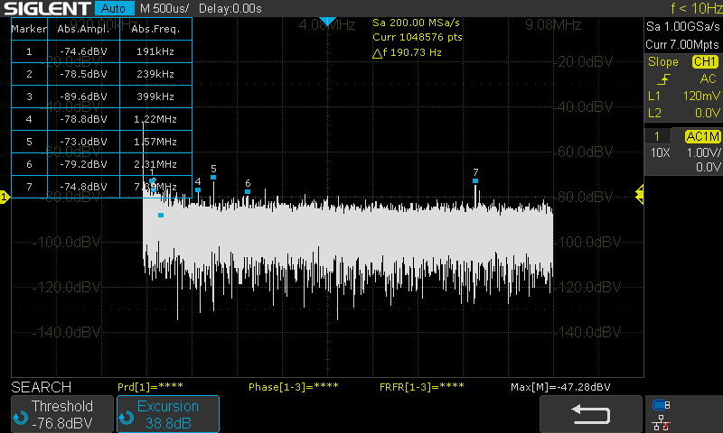

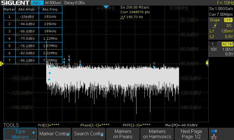

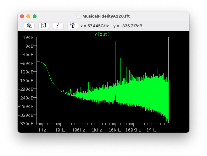

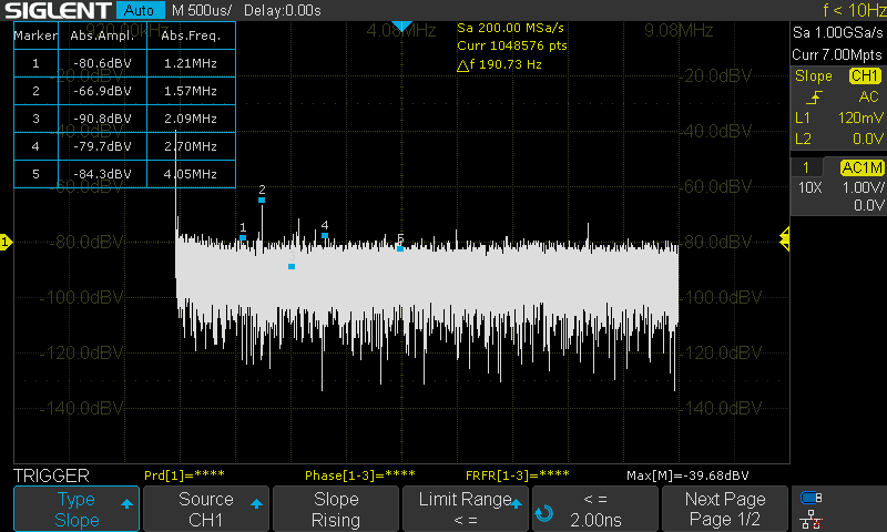

The following peaks seem to be consistent: 1.22 MHz, 1.57 MHz, 2.31 Mhz as regular peaks during any sound and with the CDP on pause, those seem to be present almost consistently. Unfortunately I don't have a signal generator other than the Mac at the moment nor a spectrum analyser (I have plans for both).
Zooming into the 1-4MHz region:
So that looks like there's some strong peaks at 1.57MHz, around 2.234-2.276 with some spikes at 2.08 and 2.42 MHz that seem to remain. This is with the case open. That 2.34-2.276 area rise gets into the 80dB on occasion.
So I think were are seeing some instability, close to the sim.

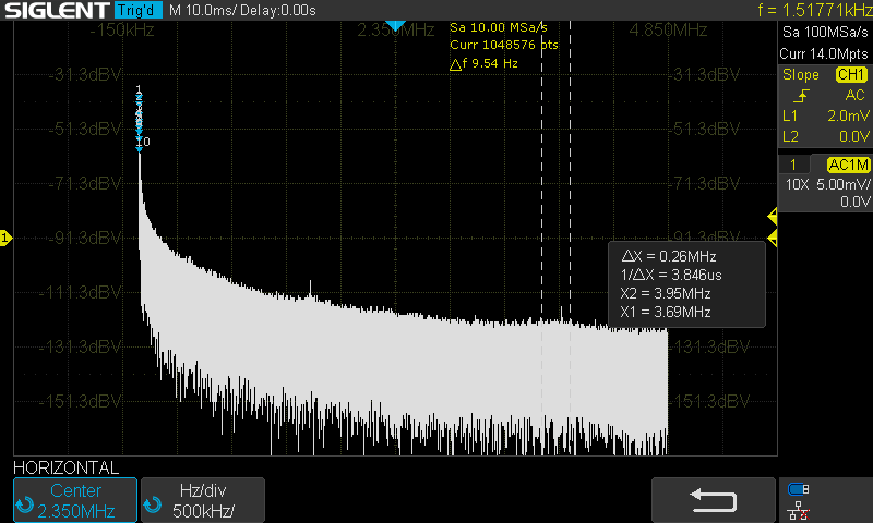

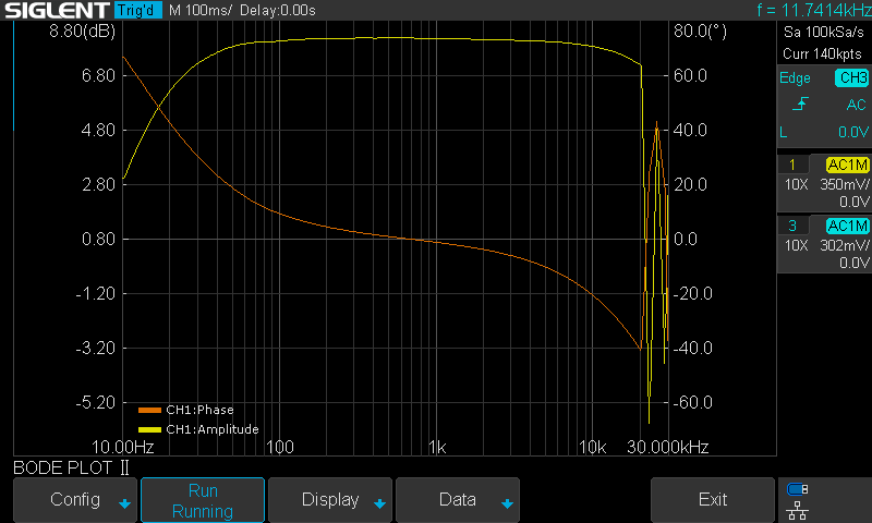

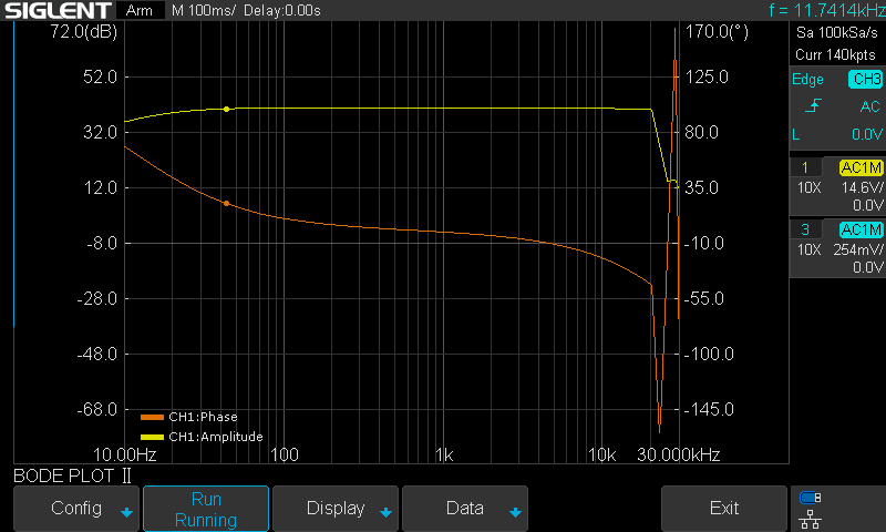

A while back I adapated/wrote a Software AWG for linux that allows the oscilloscope bode plot to control it. Take this with a punch of salt in that it's subject to the Mac mini's internal sound reproduction and filters.
The scope is repeatedly tracing the same shape so that's a good confirmation of the stability of the results. I've not turned up the amp completely hence it running at 8dB.
I'd love to have this as a proper AWG to perform accurate injection of 1V AC into the FB for example.

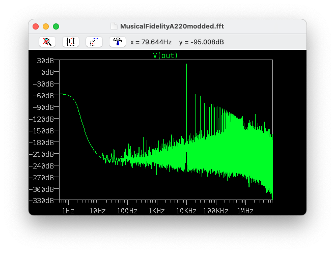

2. Instability. I want to get the ltspice model closer to the measured amp as I feel that it's not performing as measured. Once I have that closer (not a precise match) then I'll be happier. I also need to educate myself more on the both miller compensation and feedback phase compensation. I understand the general principle but I need to understand so I can do some pen+paper maths. I have some TI and other guides to work through.

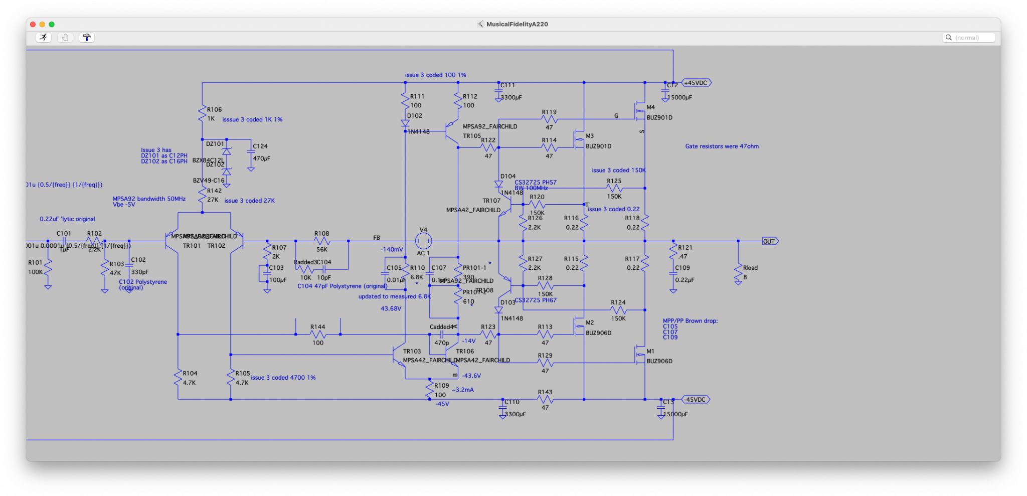

I've been reading up a bit (sorry if this is amateur interpretation).
There's two ways to solve the instability:
1. Miller compensation (think of this as forward compensation)
2. FB phase compensation (think of this as reverse compensation)
Miller compensation essentially puts capacitance between the gate and drain/source but requires a frequency dependant constant current source at the output.

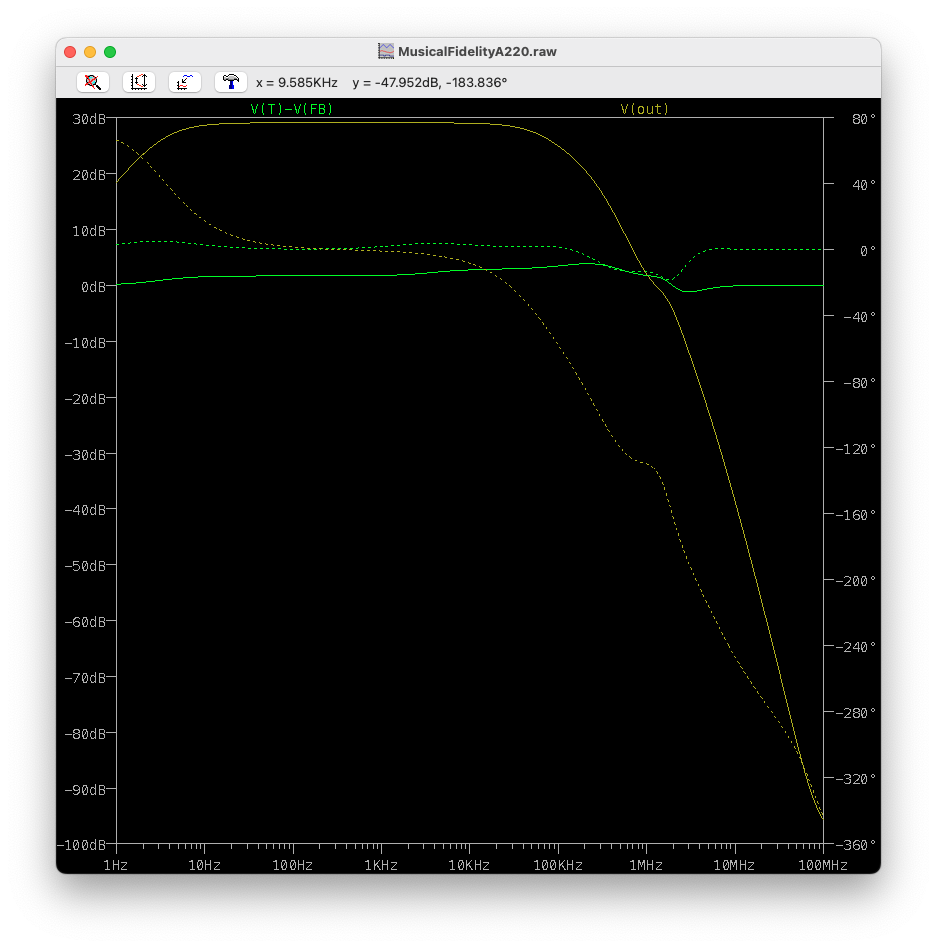

Looking at the MF design I suspect the R121+C109 provides the frequency dependant 'source' in that it allows an easy path for that frequency. Thus then balances against the internal mosfet miller capacitance. Changing the resistor value here does alter the phase shift as you'd expect..
The FB phase compensation is through C104 and series 10K resistor?

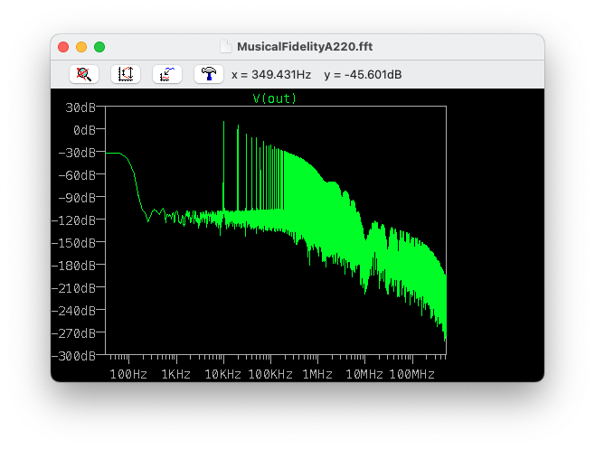

I found a nice maths explaination, which ends up with a quadratic. Simple enough, and wiki has a easily digested explanation of separating the poles.
You can up the capacitor around TR106 to 470pF and drop the R121 and it starts looking better:
However I suspect the step response probably takes a dive! EDIT: yes - it's a disaster. Just hooking up the amp and scope to each of the TRs.

Yep, upping that Miller cap to crazy levels will definitely make it stable - at the major cost of bandwidth. A square wave test will show you just how much that compromises the slew rate. The result is high THD.
The key with Miller compensation is just enough but no more than needed.
The values in the simulation I did were mostly arrived at by experimentation and guesswork... I don't have a head for the maths unfortunately!
Plotting V(OUT)/V(FB) is the usual way of getting the closed loop gain response. I generally optimise for widest bandwidth while keeping stability (phase >40degrees at gain = 0dB) and a decent margin (at least 20dB of margin preferably)
