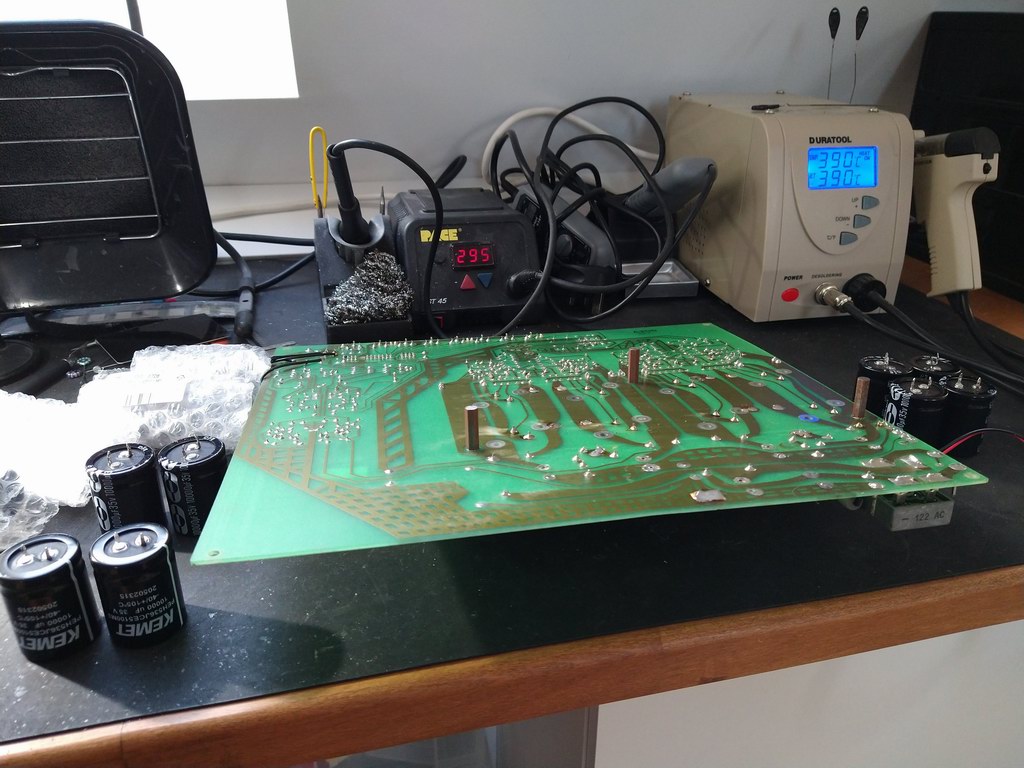

I also remembered that I was going to re-build the preamp stage which was a bit of a crazy design IMO but never got around to it. Well, now's the time. But first things first - I've got a full set of 105C 10,000U's to swap-in. The originals looked OK but they're just so old (and only rated for 85C which is a laugh in this Amp).
So here's the rusty article getting new caps:
attachment.php
attachment.php
Funny how the PCB is labelled A200. I think this was a fan-cooled product that got re-engineered into a bigger case and called A120 to make it seem like a big brother to the A1. The circuit is very similar but has a higher supply voltage and separate reservoir capacitors for left and right channels in a CRC filter arrangement. The output transistors are also doubled-up to handle the higher dissipation.

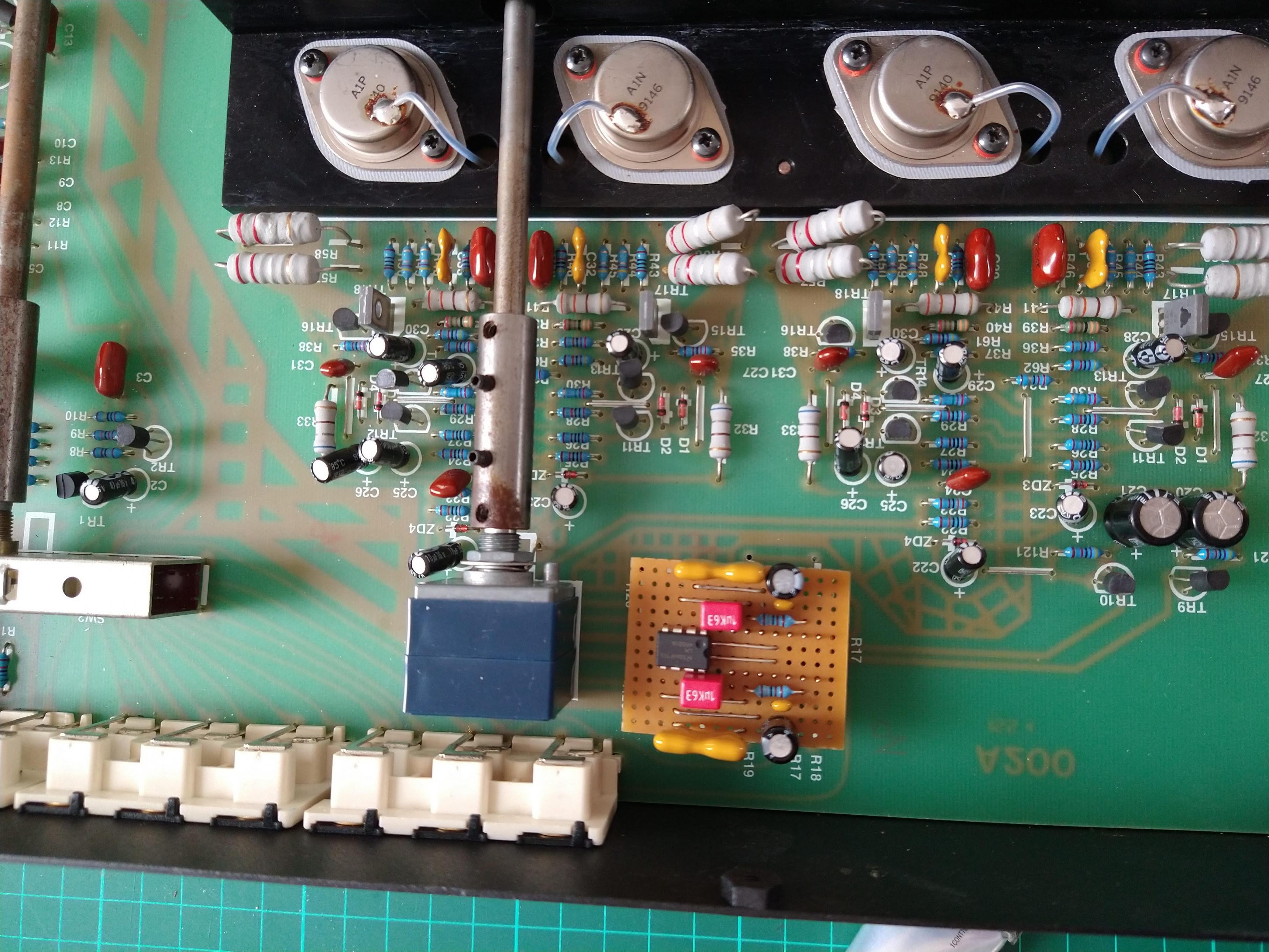

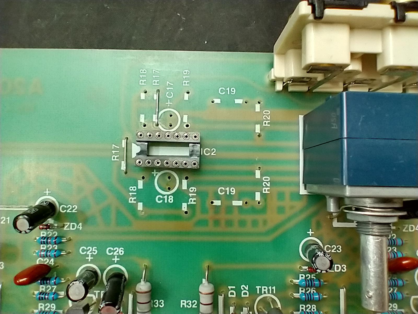

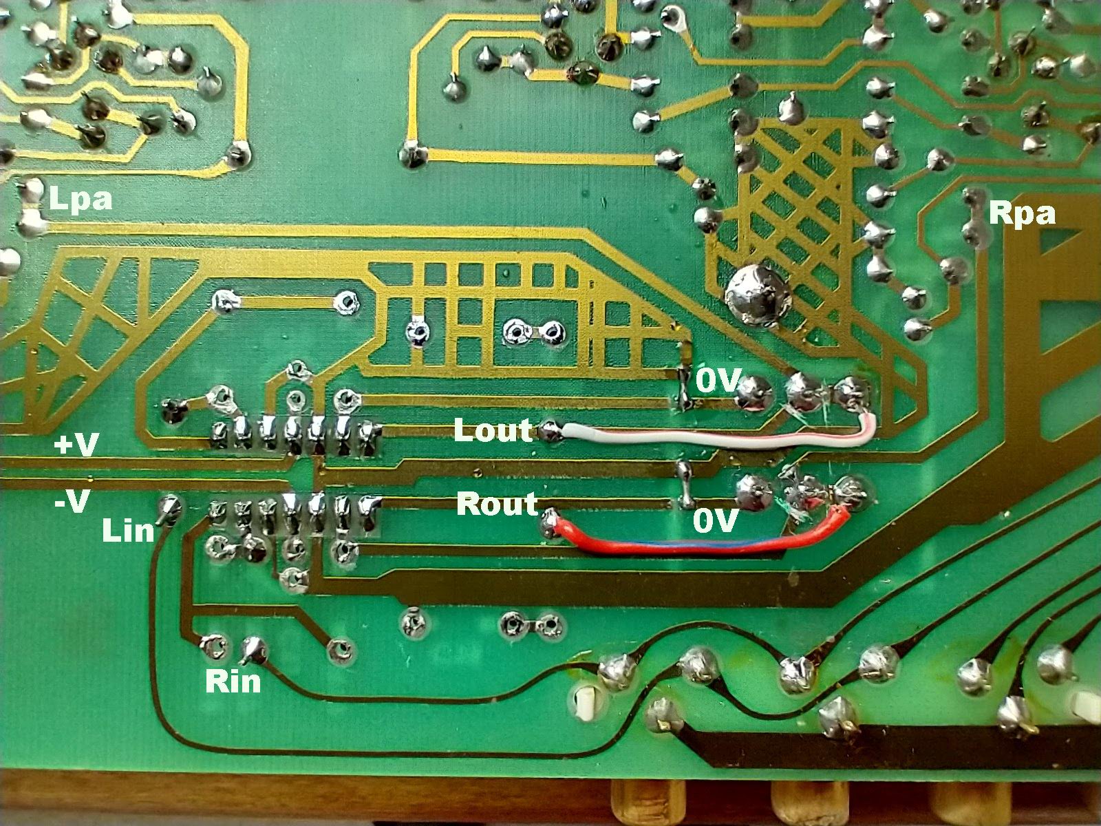

Hi, in the end I desoldered all the parts around the TL084 based preamp and fitted a 14-pin DIL socket in its place:
attachment.php

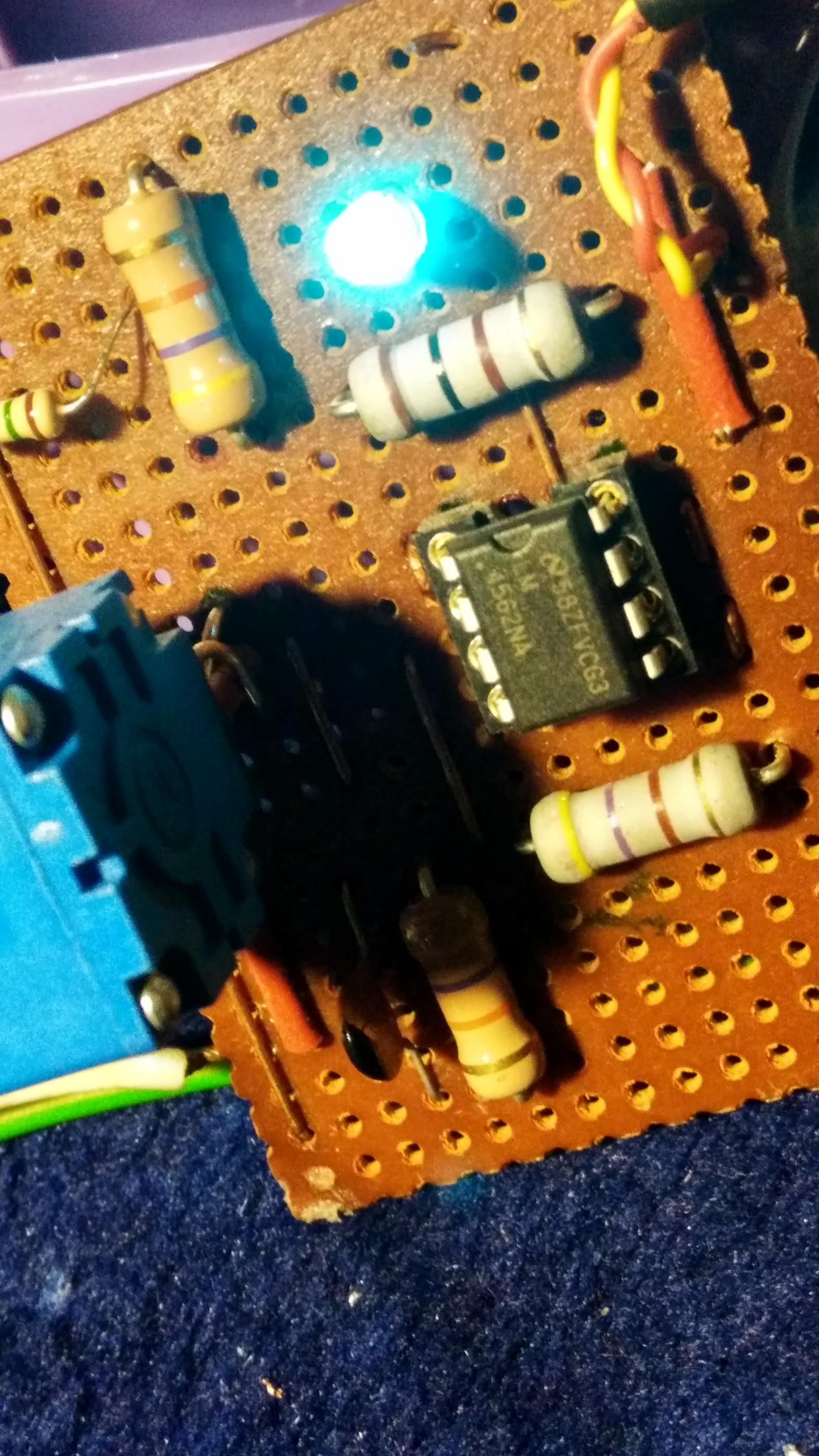

Into that I plugged my own design for a preamp built on stripboard:
attachment.php

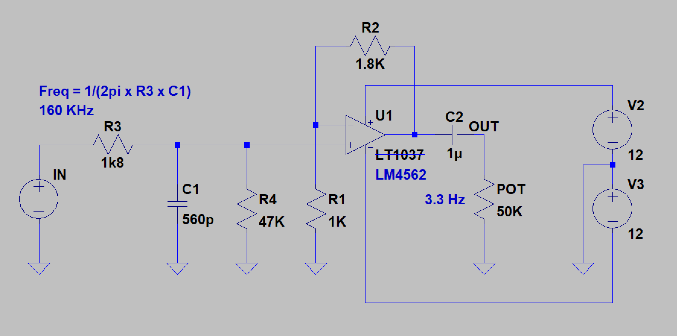

The relevant signals were as shown here:
attachment.php
I decide to keep the original ALPS 50K pot with a bit of hackery to swap the connections so the tracks span preamp out and 0V, with the wiper feeding the PA stages. It gives me a much more comfortable gain control with my preferred listening level at positioned 12 O-clock.
My simple preamp is based on the LM4562 and provides a voltage gain of 2.8
Nothing fancy but much better than the original IMO. AC coupling eliminates the dreaded pot crackle and the OPAMP is a bit of an improvement on the old TL084!

If you want to keep your preamp outside the chassis then all you need to do is remove both R17's and link Lin/Rin to Lpa/Rpa (as I labelled them on the photo of the track side) - but you need to cut the original tracks that ran to Lpa/Rpa (between the R22/R23 junctions and the ALPS pot.
You could remove all the other parts I've shown in addition to R17 but there's no need. Are you retaining the original case? The Lin/Rin tracks are post input selector so you will have to leave the selector in the right place. Of course you could also plug in a CD player or other direct source and listen without any preamp. Tape 1&2 have the shortest input path - I would use one of those for an external preamp and keep the CD input for preamp-less monitoring fun!
You could also keep the volume pot as a potential divider as I have done by hacking the PCB and linking Lin/Rin to Lout/Rout... but I get the feeling you plan to ditch the MF metalwork altogether. I think that would be a shame as I still get a kick out of the 90's looks 😀
Frankly I'm also chuffed to bits with the sound of this thing now the horrid front-end is history. The volume control was always too aggressive as well as being in a DC path. These amps were always going to go 'crackly' eventually.

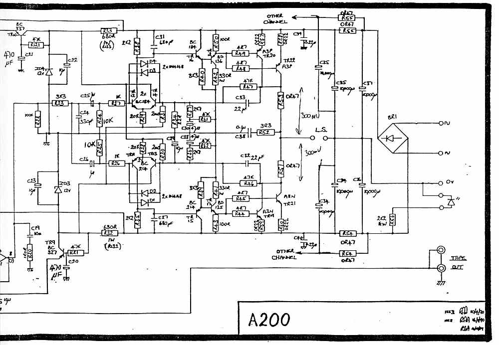

activex190, puginfo, this schematic for the A200 should answer both your questions:
attachment.php
I found the above image @audiomaniacy.pl
IMO the PA input impedance shouldn't create any issues for the preamp cct I used although R22 (100K to ground) will slightly alter the taper of the log pot as I have used it - but I think it bends it in a good direction. It could of course be dispensed with altogether.
