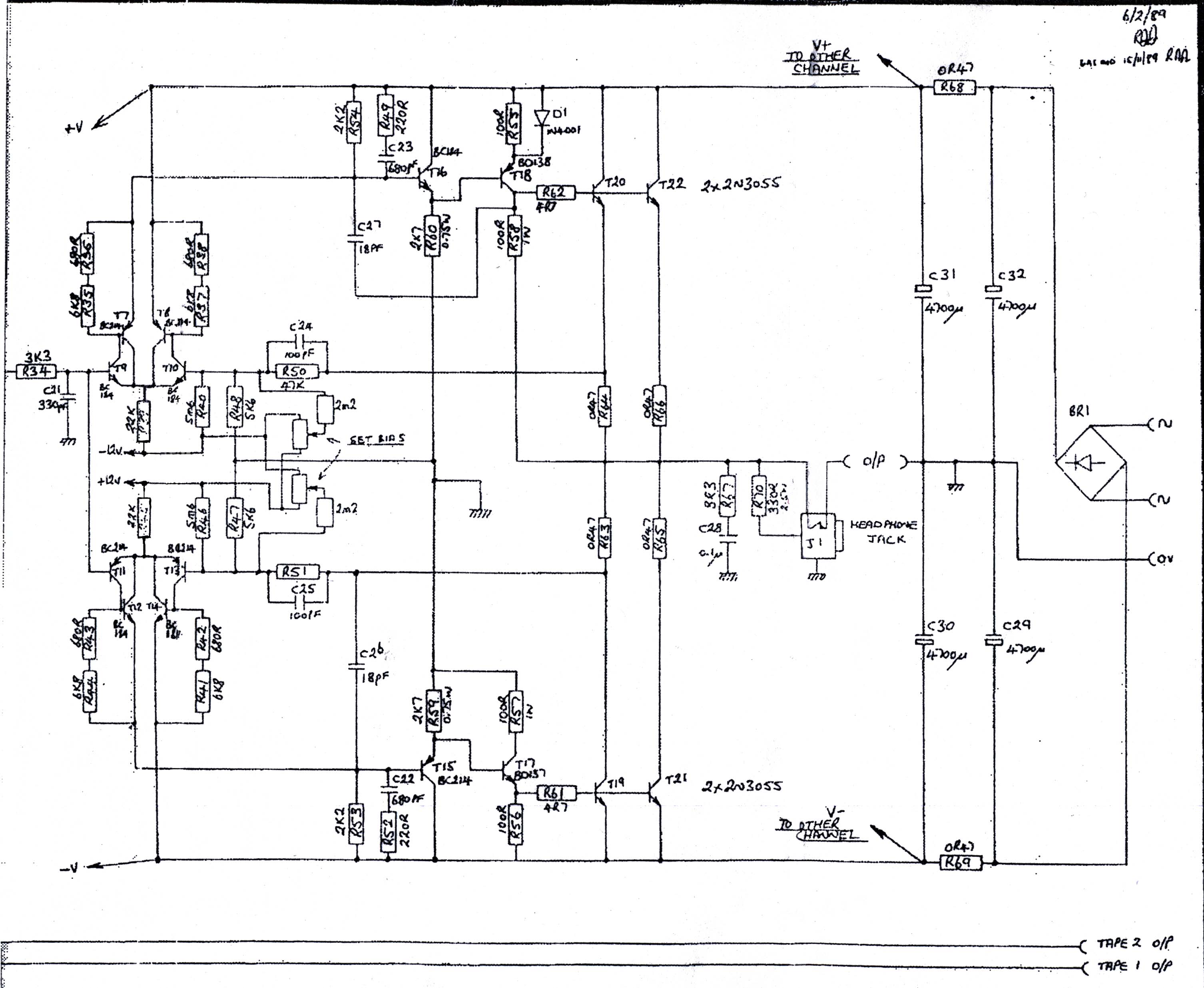

Hello,
please find attached A200 schematic.
Musical Fidelity A200 - Audiomaniacy
I own Musical Fidelily A120 which has more or less same schamatic as A200.
As you may know Class A is limited to a few watts beyond which (A1, A100, A120) switch to class AB.
Which component should I have to change and trim to SAFELY increase the bias for a wider class A range?
Actually is shown 300mV on 0.47 ohm, that is 0.64A only! :down:
Definetively not a 40+40W Class A as declared.
Just looking at the face of my A220 "Class A", manual states Class A too.
Looking at the schema - the MF A2/A220 is a chain of two differential amps with a Push Pull with 2 devices each side for each channel.
It looks class AB1 to use a tube analogy.
Another option is to copy the B1 setup, as the topology is nearly identical
