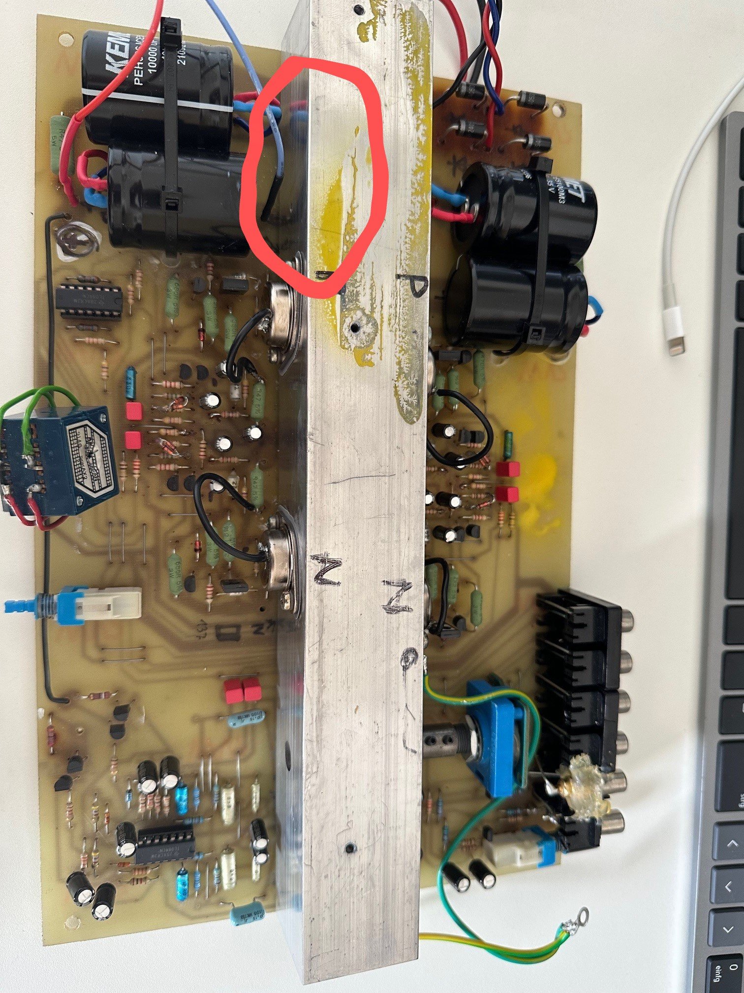

I saw at the first your photo that you haven't the temperature sensor on the heatsink bar. I have marked the point that must be.

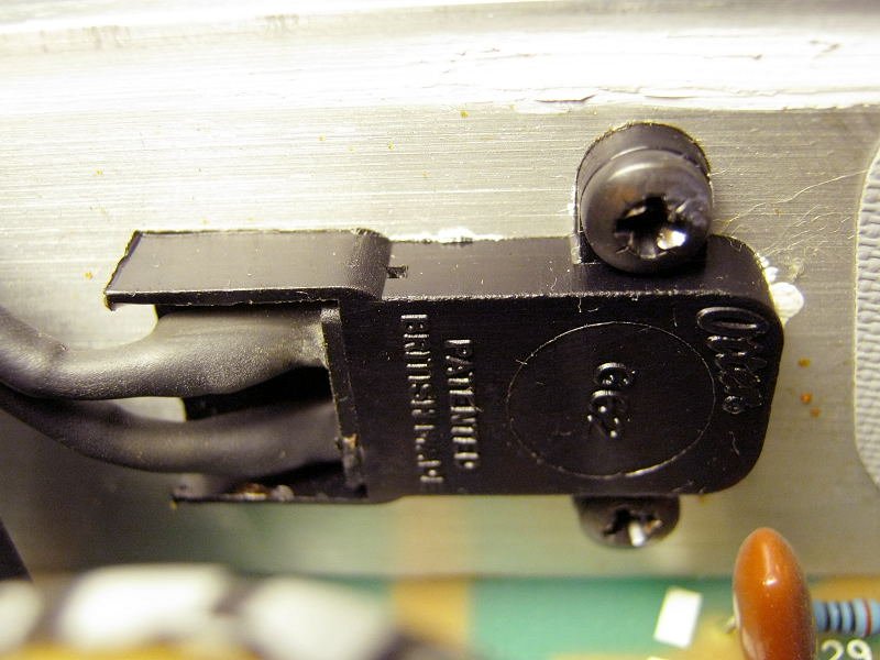

Probably.
This is a thermal cut-off, soldered in series with the AC live wire, after the fuse and before the front panel ac switch. It is fixed, with screws and thermal paste, to the aluminium U-channel that joins the output transistors and the heatsink.
It is very useful for the output transistors and I think that you can find something like this in the market.

@eldad : good info, thanks.
@ fencki : I don't know from what version this installed, but from the color of the PCB, these are very early versions of A1, this explains the missing diodes that you have add later on the circuit.
Mine was manufactured on 1992, 10th Anniversary, but and the Hennessey A1 that was simple version of A1, this cut-off sensor exists.
