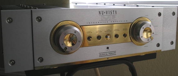

Hello
The first time I did listening to a Musical Fidelity amp was about 9 years ago, I did eard the Musical Fidelity Nu Vista M3 integrate amp, with Monitor Audio loudspeakers, it was a superb musical experience, my first commercial amp listening session who was really musical.
I would be very currious to see the schematic of the Musical Fidelity Nu Vista M3 but I did not see any on the web.
Thank
Bye
Gaetan
