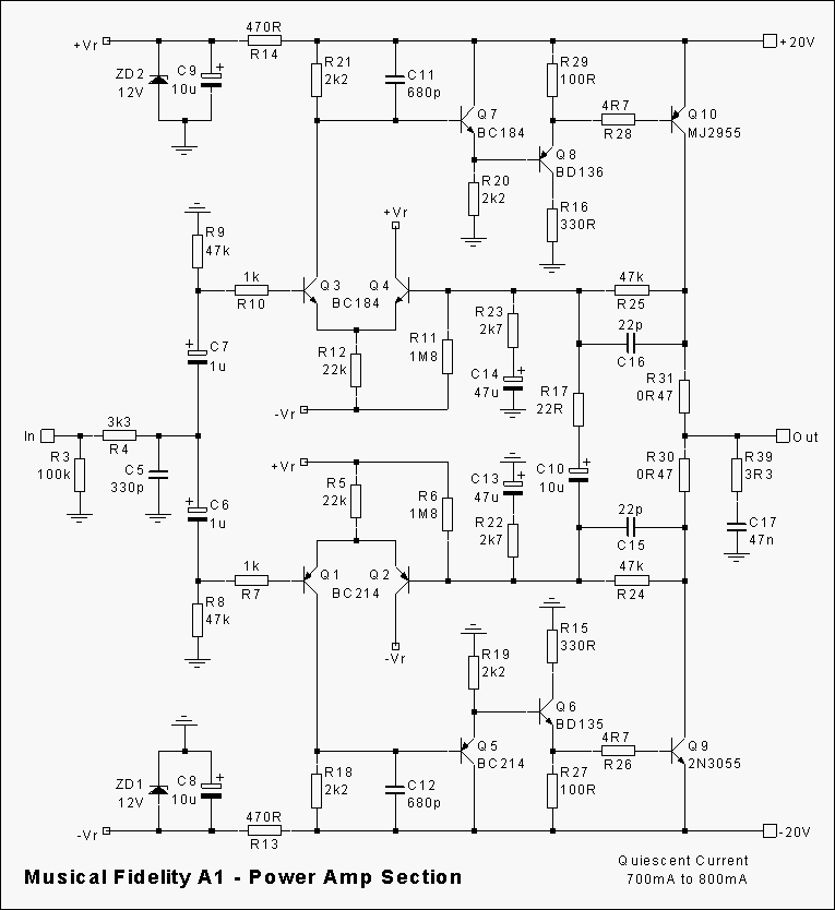

Musical Fidelity A1 Bias Current
The recommended bias current of the circuit in the attached diagram is 700-800 ma. What can I do to pull this bias current to 500-600 ma. What are the disadvantages of reducing the bias current?
Thanks.
Hi chip_mk
Do I need to plug R6 and R11 into 2M7 ohms to draw 600mA bias current?
2.666.666,67=47000*12/((600-0,15)*0,47)

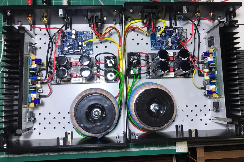

My Power Amp is working perfectly. But I have some heat problem. In one hour of operation, the coolers reach 65 C. This also makes me nervous.
I want to lower the heat a bit

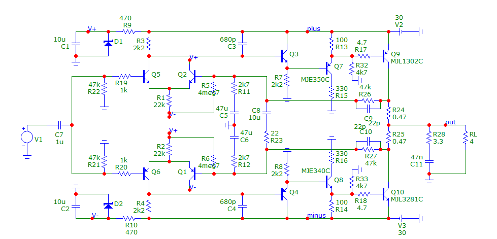

I played with it in the sim.
With 4M7 bias resistors I got 350mA bias with the transistors shown. Simulator shows instabilities even with pure resistive load.
Adding R32 and R33 "keep alive resistors" the output transistors never go below 30mA and stability improves.
BUT, the drivers are now switching (they did not switch previously), and they operate with much lower currents.
I attached the sim file (microcap 12). If anyone needs the software (free) just ask me, I think their website shut down.
edit: added 2.zip
