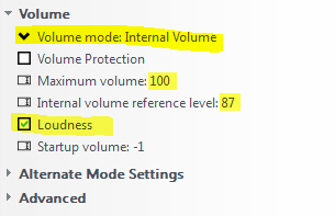

Sounds right but suggest try what mitchba hints because at first its calibrated and tied to a reference level and second it follows the new standard ISO 226:2003 superseding old Fletcher-Munson and for third the loudness contour is dynamic with SPL and how precise can a analog circuit in amps be for that feature compared to programmed feature into digital filters in a digital player.

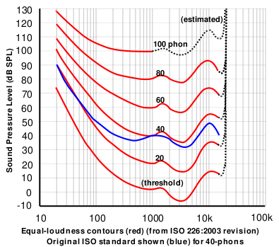

Dynamic curves:
Can creative help a quick guide should you or BasicHIFI1 want to try it out, if you haven't JRiver get their 30 days trial and can recommend use 64bit version if your OS is on par, into "Tools/Options/Audio/Audio Device" setup your soundcard to "ASIO" or "WASAPI" to get bit perfect sound stream, then in "Tools/Options/Audio/Volume" you will see below and set "Volume mode:Internal Volume" and tick on "Loudnees" and the other two marked yellow below will dictate ratio of loudness so as setting is seen below means when using volume slider at top left corner in player from 87-100 nothing will happen because reference level output about 83dB SPL at listening position (or use head phones) but when volume slider goes below 87 then that ISO 226:2003 curve starts kick in, and for example one could also set "Maximum volume" to 87 then system will never play louder than 83dB SPL at listening position or it could be to make headroom for the build in DSP to EQ correct speaker system. So if one active take care and measure at listening position where about 83db SPL point is relative to volume slider it should be possible fill in and set those two numbers optimal.

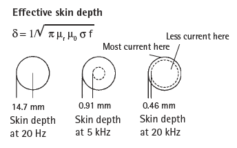

About speaker wires to be thick enough and skin depth think not its so evil as thought about, for example a 0,4mm diameter solid wire can fine enough stream audio band in shorter lengths which is possible in active systems having amps sitting relative near. For that diameter cable skin depth in audio band will just be as bad or something if its a 20Hz or its a 20kHz regarding full skin depth and so what if it doesn't run hot for actual situation of power. Think it looks when wire task is for use as speaker cable that conductor spacing/inductance is the one to look for having the closer the spacing the better. Below is from a cable catalogue and wow we need 14,7mm for those 20Hz atmosphere notes : )
Dynamic curves:
