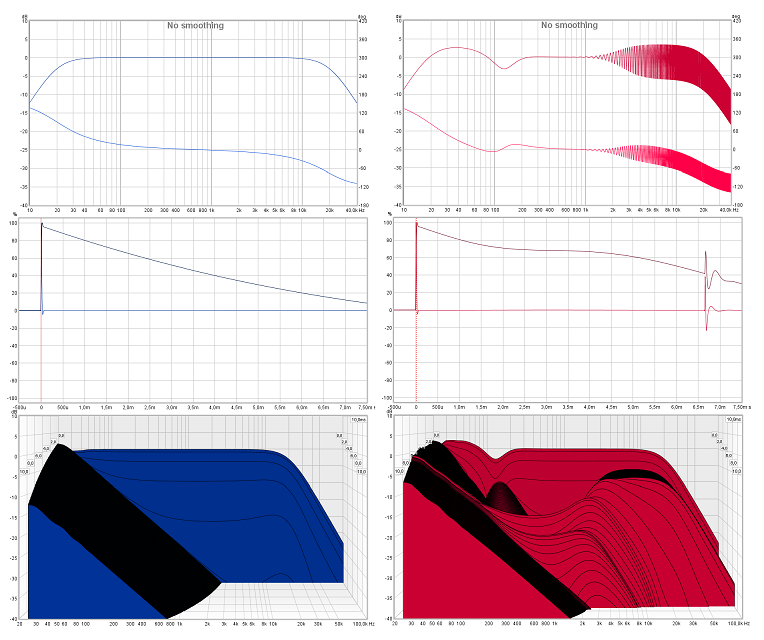

Thanks look it up 🙂 really don't know if simulation is the reality but had a try with system stop bands as BW2 roll off at 20Hz-20kHz, slopes for pass bands are LR4, middle band advanced 3,33mS (1/2 cycle 150Hz) relative to bass and treble band advanced 6,66mS (1/1 cycle 150Hz) relative to bass, summing the three as a wet effect and mix it fifty fifty with a dry signal (20hz-20kHz band pass):

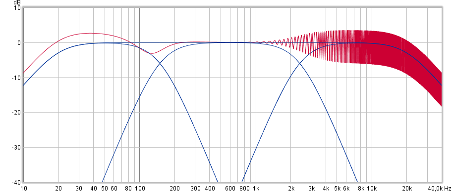

Dry verse wet effect mixed fifty fifty with dry:
Can share effect as impulse response wav-file if any one like to load filter into a players convolution engine.
