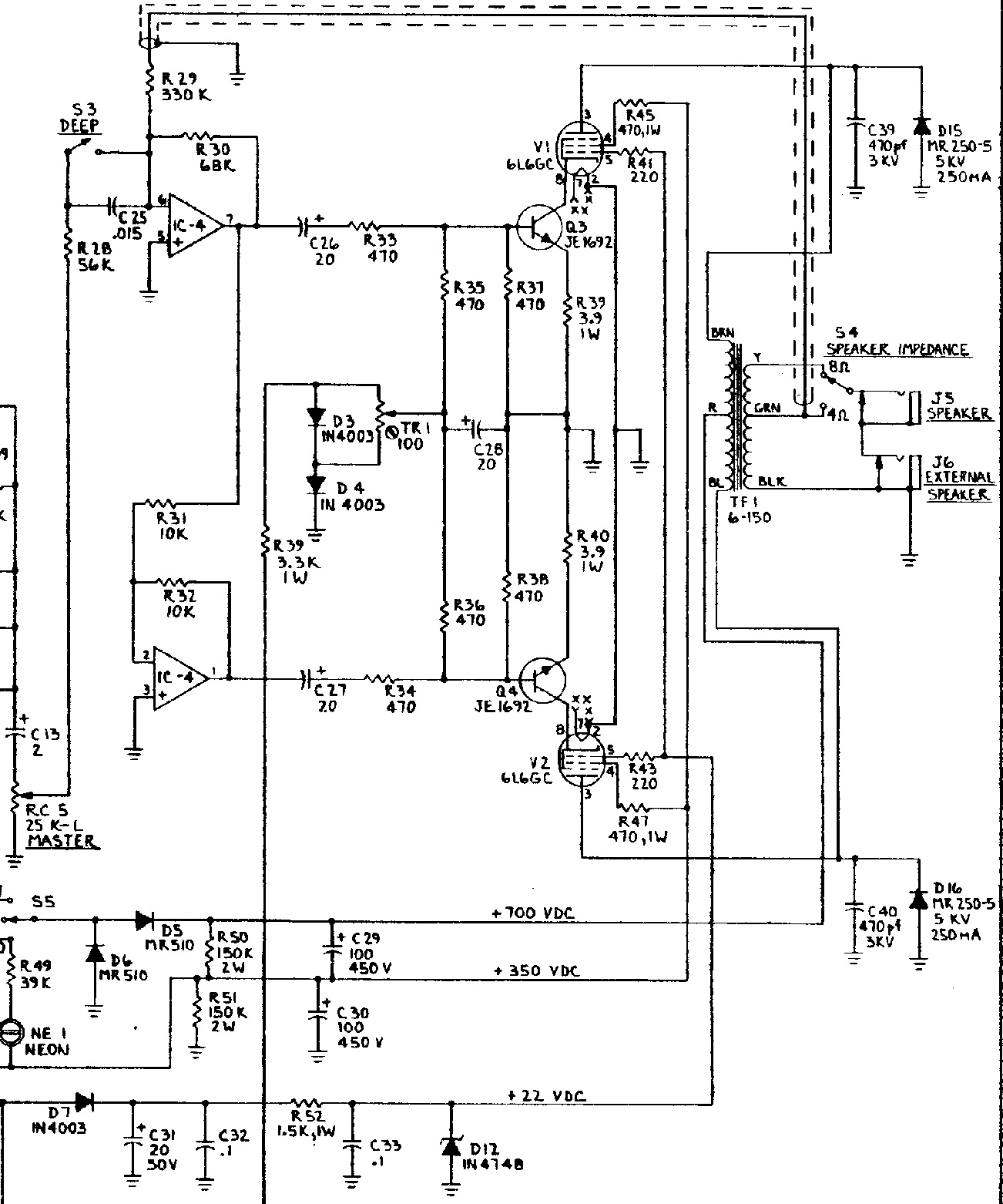

Here's what it says in the service bulletin:
This applies to all Music Man amps requiring 6L6GC tubes. Due to a change in design characteristics of the Philips ECG tubes, some Music Man amplifier models show signs of instability or output glitches when using these tubes... identifiable by the double getter arrangement on the top of the electrodes. The instability usually will occur at an input frequency of approximately 70 to 150 Hz as you approach full output. The instability is temperature related and the tubes must warm up approximately 2 to 3 mins. The glitches occur anywhere on the wave and are not to be confused with crossover distortion when the output begins to clip, or preamp popcorn noise.
To eliminate the problem, solder a 470k 1/4W resistor from pin 8 to pin 2 on the 6L6 tube socket. Install one resistor for each push/pull pair in 150 watt versions and one resistor per socket in 65, 75 and 100W versions.
Note that it says this applies to all 6L6 MM amps at first, but doesn't specify the 50W version at the end, and as PRR points out, the 1650-RD chassis/RD-50 design is a bit different. Attached is a shot of the 75W (Model 75) output section for comparison.
Questions:
Does the factory 470k mod maybe make more sense in the 75W circuit? If so, what would be the corollary resistor value in the 50W circuit?
Also looking at the 75W version, I'm curious as to what D15 & 16 do. If they're protecting the plates from excessive current, maybe I should consider something similar on the 50 Watt version?
And to Sr. Fahey's comment that assured tube destruction will result if more than 120V appears at the Cathodes/transistor collectors on the 50W version, are there any suggestions on how to prevent 100+V or so from getting to this point in case of an upstream component failure?
Ultimately, I'm hoping there's a strategically placed component or two that will provide an extra margin of protection for NOS output tube$...:cool:

The Peavey VTX series are similar to the MM amps, and there are some good notes on the schematics for those unsure what voltages to expect.
Sounds like I need to spend a little time looking at some VXT schematics after what PRR said about Peavey's SS engineers... I like the idea of SS front ends married to tube outputs, conceptually anyway, so I'd be interested in how they did it too.
If you are worried about screens, are they not already at half the plate voltage?
Screens on my two units are fine, right at 50% of plate. But both have had previous failures in the output section before I got them, and there were some attempts at taming them down in the past - on RevA, the two 470k resistors were added from cathodes to ground on V2 and V3 - on RevB, someone installed a 27V zener in D9 instead of the stock 30v, and upped series resistor R62 from 470 to 560 ohms.
After seeing what was going on in my 2 amps and reading a lot of threads on various forums about output section failures - and while I have them on the bench for recapping, etc. - I thought I should reach out to the experts for some ideas on adding protection for the more expensive parts like transformers and output tubes, and maybe even for PIA parts like output transistors and zeners, in case tube current decides to go too far north again, for *whatever* reason.
For example, the MM 2100-75 chassis/Model 75 amp has a thermal breaker on the primary side of the power transformer, a neon lamp in the Low B+ circuit, and a zener on each output tubes' plates. The 1650-RD chassis/RD-50 amp has none of these. Maybe it was to keep costs down or maybe they didn't think it was needed, but it seems more could be done to help the RD-50s fail a little more gracefully, like the modern Fenders and others that have firewall fuses all over the place to protect major components from current overloads.
So my interest in screens is only because screens are one of many places in the circuit where runaway tube current could be potentially controlled. I would hope this info could benefit anyone who has one of these models, and I'm more than willing to try them out on mine for the sake of science!
What was hinting at is the things you might want to do for screens, like lowering their voltages, has already been done in the design.

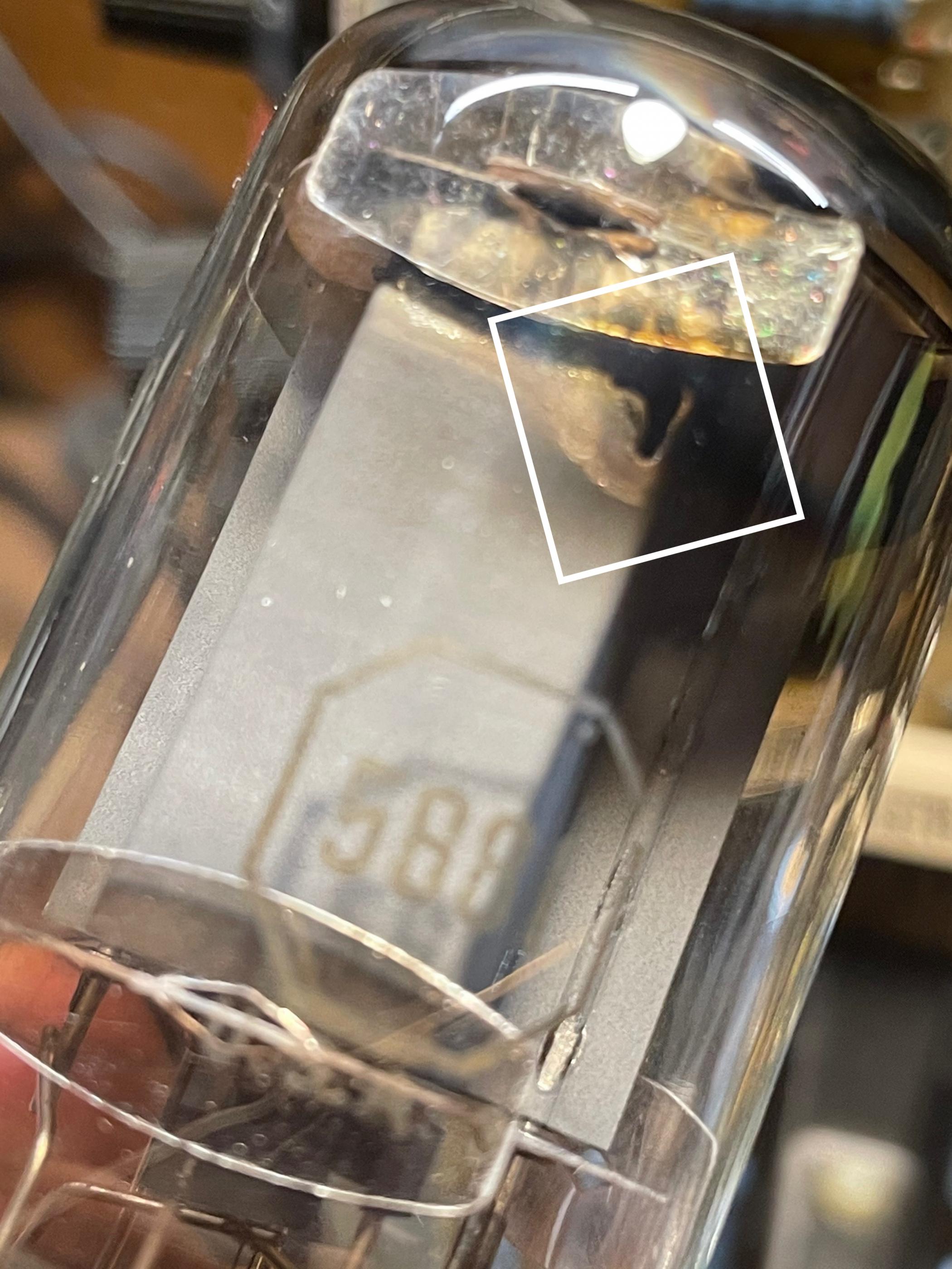

I hear you Mr. Enzo, and your points are truly well taken. A bunch of posts on repairing output sections doesn't mean there's a design flaw, but you also see lots of people saying these amps are notorious for eating output tubes for lunch.
In the case of my recently acquired RevB, along with the 27v zener came a lovely vintage Tung-Sol 5881 with a hole already fried in the plate (see attached :eek:). And my recently acquired RevA is red-plating whatever tube I dare to put in V3.
So seeing a similar issue in both of the only 2 RD-50s I've ever seen the inside of, seems logical to look for a more proactive way to deal with it. Kinda why we're DIYers, right? Surely after 40 years of field-testing there's gotta be a couple of reliability-centered mods out there to consider?
In the end I just want these guys to play nice with my pricey glass bottles and maybe be able to start gigging and recording with them without making sure I can afford a new OPT and a set of NOS STRs first. I'd rather sacrifice a 50 cent component to protect a 50 dollar tube if there's a way to do it.
Or maybe it's not worth running NOS tubes in this kind of circuit at all? I actually have no idea at this moment if cascoded output tubes are capable of coloring the sound at all. I've tried figuring out where saturation would start to happen in this configuration using traditional load lines but it's not making any sense to me. But if these tubes stay pretty much linear right up to max dissipation, maybe it makes more sense to just run cheaper tubes and hope they don't take the OPT with them when they go?
And/or maybe I should invest my time on adding a Hi/Lo power option like my 75 and almost every other MM model? :scratch:
