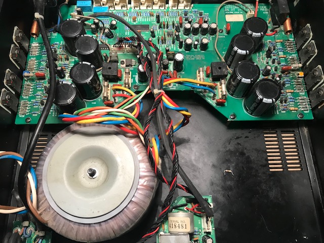

Hi, I'm having problems with my MF A5 integrated, after power on is switching on and off constantly to mute.
I bought it second hand 10 years ago. Apart from that had to take it once to a local tech cause it was not working. He said he changed some transistors...

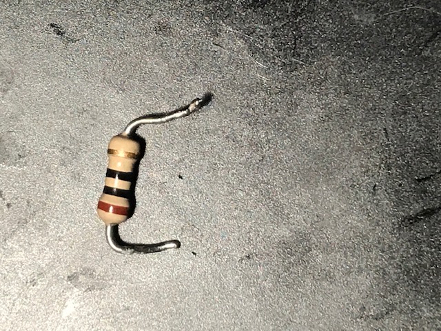

Well, the thing is that I've opened the amp to take a look and whislt cleaning it I found a resistor down on the chassis. It's a 10ohm one and I think it's from the Control PcBoard, but have to disassemble it first to ensure of it.

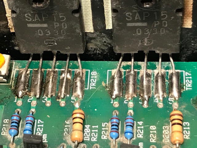

But what really surprised me it's some differences between the channels, so probably this is what the technician changed. The transistors on the left channel are 2 SAP15N and 2 P with a blue potentiometer in between I guess is the original. However on the right side the transistors are SAP15P and 2 N (so switched with regard to the other side) and the pot is white/orange. And apart from it these last transistors don't look to be in very good condition.
I really don't know a lot about transistors, but I guess SAP15N and P are not exactly the same. Or is this normal?
And the other question is, in case I have to change one of the channels, if I could replace with something better both channels (the 8 transistors) without too much complication.
I attach some pics...

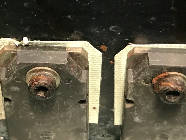

Hi, the transistors work in pairs, SAP15N is NPN and SAP15P is PNP. This is typical for transistor amp output stages. When you say 'reversed' that might just be the way the board has been laid out, each channel should be symmetrical. Definitely looks like at least one set of transistors has been replaced there, and the mounting screws look a bit rusted too.
These transistors are special types, there is an upgraded part SAP16N/P and some people seem to have also used STD01 or STD03. These may give you more reliability if something has failed but otherwise not really an upgrade.

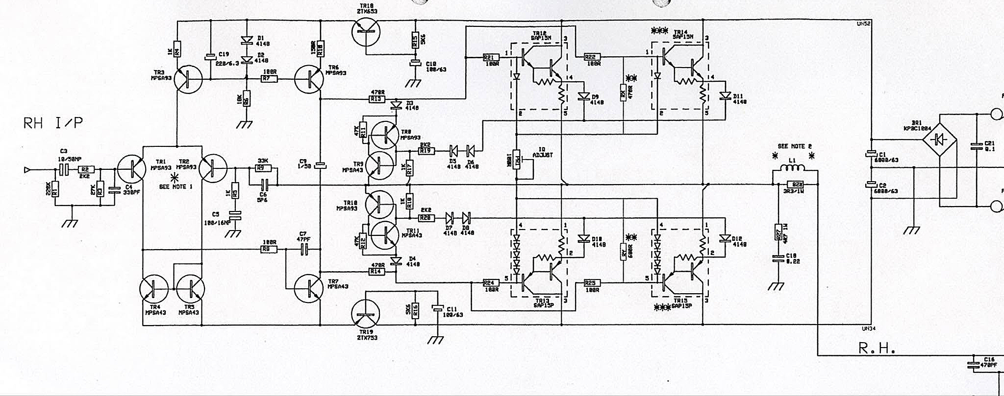

Help with schematic diagram for MF-A5 please
Hi All,
I am in the process of repairing an A5 which has been blessed with fire and holy smoke when SAP15 P & N blew up.
Also on the death list are resistors and bias trim pots charred beyond recognition.
Wondering if anyone has a copy of the schematic that I could access please. Otherwise have to file it into the never-ever land.
Thanking you in anticipation.
