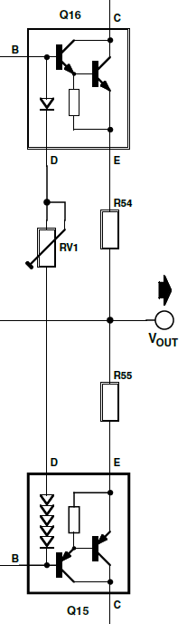

Hi all, got myself a MF A5 intergrated amplifier thats using the sap15 transistors.
These transisitors have the emitter resistor built in and are prone to failing. Ive read that you can lift a leg on these transistors and put your own cement 0.22ohm resistor in its place.
Question is can anyone advice what leg to lift and where to solder new resistor please, or any pictures of this done or drawings would be fantastic!

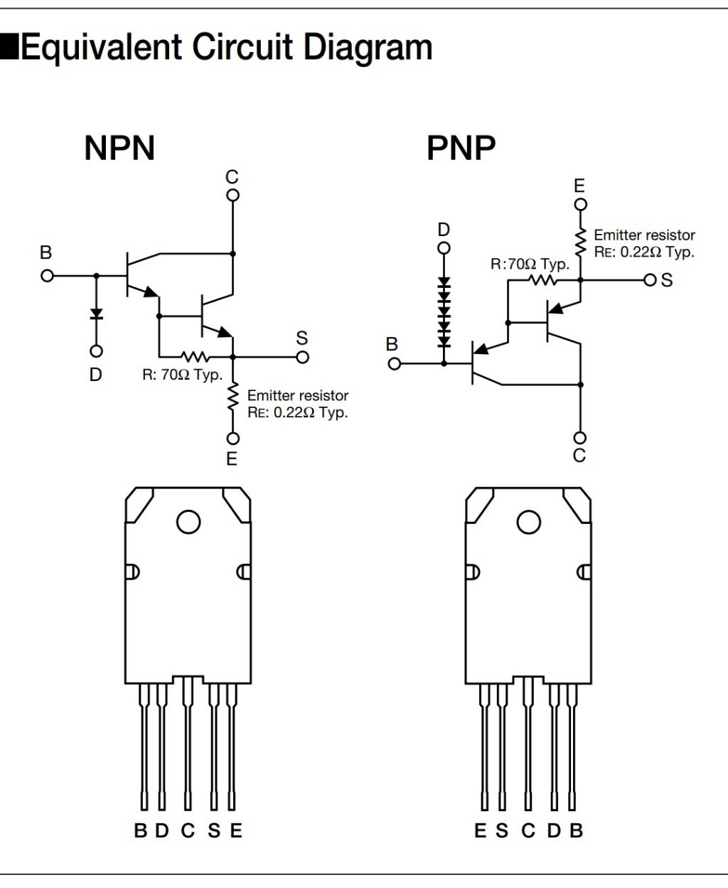

Here is the data sheet on it. If the resistors have failed, the odd are so has the Darlington pair.

I get that, but doing this mod will make the transistor a lot more reliable is my thought😕Lift the "E" leg, and put your own emitter resistor from "S" to "E".

What watt resistor would you use? The amplifier has 2 pairs for each channel and is rated at 250w per channel. I see how they are unreliable if you compare the size of the eg 5w cement compared to the transisitor one built in!

Someone needs to check my math but this is what I came up with...
At full power:
* 250w/4ohm output.
* 2 pairs (so, 125W per pair).
* That's about 24v RMS into 4 ohms
* Each transistor does about half the waveform, assuming class AB. That's 12v RMS.
* 12V RMS into 4 ohms is 3A
* 3A / 0.22 ohms is a drop of 0.66v
* Dissipation across 0.22 ohm at 0.66v is 2W
5W seems like a good choice.

The resistor inside this transistor is known to fail early with the darlington being fine. Replacing the build-in R with an external one is a known cure.
The follow-up devices to the SAP series, STD03N and 03P, look exactly the same but miss the internal R, for just this reason.

device dissipation is different to load dissipation.Someone needs to check my math but this is what I came up with...
At full power:
* 250w/4ohm output.
The load sees 31.6V rms, at 7.9A rms. Thats a signal peak of +/- 44.7V and +/-11.1A* That's about 24v RMS into 4 ohms
Thus each device handles 5.5A peak
That doesn't make any sense to me, each device sees the full voltage swing, 31.6V rms, plus the DC rail voltage.* Each transistor does about half the waveform, assuming class AB. That's 12v RMS.
No, that's bogus. The resistors share 7.9A rms, which is 12.5W between the two of them, 6.2W each.* 12V RMS into 4 ohms is 3A
Or are there 4 resistors? In which case that's 4A rms per pair, so 3.5W per pair, so 1.75W each (3.5W if clipping).
7W is the minimum safe rating if two resistors, 2W for four resistors, and thats before clipping.5W seems like a good choice.
Keep in mind cement resistors are designed to dissipate 5W directly into air. The IC is mated to a heatsink so it can easily dissipate more heat than the package size would suggest. For example TO220 devices are able to dissipate over 50W into a suitable heatsink.
Thanks Mark... Yes there's 4 (2 output pairs) ... Be interested to see your working though which is doubtless more correct than mine
each device actually handles *All the power* half the time. You can't divide the maximum parameters. Only the total dissipated power can be halved for both outputs. Amps = 11.1A and 89.6v C-E. both devices

P = V^2/R
so
V^2 = PR
so
V = sqrt(PR)
This works for DC, instantaneous, or RMS, so long as you are consistent.
More precisely average power = (Vrms)^2 / R
So 4 ohms and 250W gives Vrms = sqrt(1000) = 31.6V.
The current through the devices is half-cycles, so you cannot use simple rms formulae for the device as the voltages and currents are not proportional (put another way the resistance of each device varies with time).

Thanks! Of course this makes perfect sense.
I got 13.75W total, 6.9W per pair or 3.4W per emitter resistor (4 of), using 7.9A and 0.22 ohm.
So 5W should be okay. 7W if you want to have more margin.
