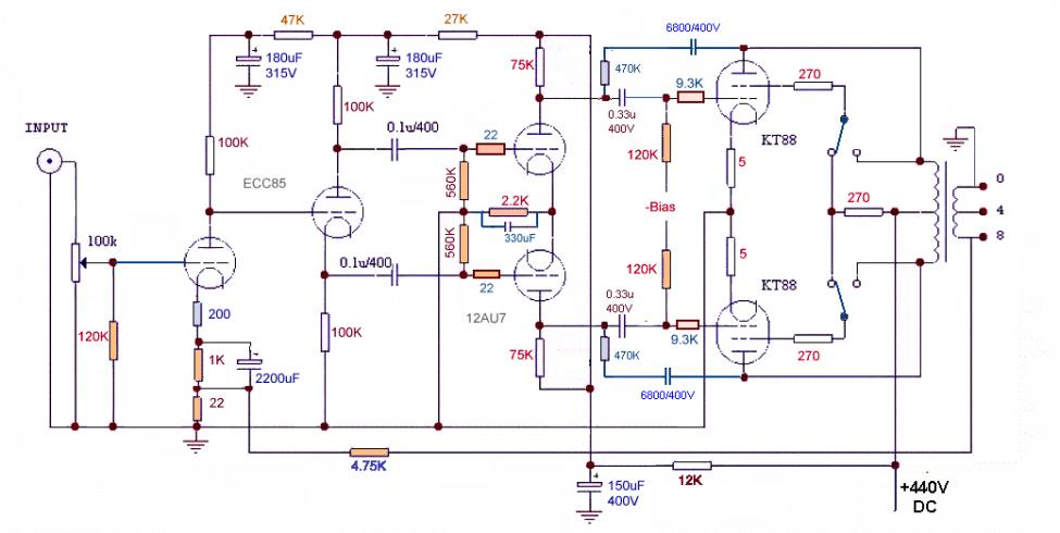

The turns ratio is about 22.5~23, so call it Zr ~ 4k:8, just like what the datasheets recommended. The inductance is effected by the drive level and the frequency used for the measurement, I am not sure what your meter is rated for, but very few of them are capable of making accurate measurements on tube amp OPT's.
Now that we have most of the parameters about the amplifier, what is that you would like to do? Figure out the feedback loop? Modify the design? What else?
My goal is to achieve maximum from XD800. To achieve this, the B+ should be rised to get more power, driver tubes should be strong enough to drive kt88 without problems, and feedback loops should be tweaked to these mods. Could you tell me what is the maximum voltage for kt88 push pull triode operation with fixed bias?

It seems like you want to change the PT to get the maximum output from a pair of triode-connected KT88's, is this correct? If so, we can forget the limits for the pentode connection, also as ruben mentioned, if you up the voltage, then many of the capacitors need to be replaced as well, is that what you want to do?Could you tell me what is the maximum voltage for kt88 push pull triode operation with fixed bias?
Guys, as I mentioned earlier I've already changed power tubes power supply caps to 500V. When about 475Vdc B+, voltage doubler caps will be at it's limit. I changed them from 470u/220V to 470u/250V ones. And 250V on them will be when B+ will rise to 475Vdc. I've simulated it in PSU Designer II. So firstly I'll have to change these caps for higher voltage rating.
After this month of listening to this amp I figured out that mainly I've listened to triode mode, so I think I should go as far with B+ as this mode allows.

If you prefer to listen to the triode-connection and your speakers are relatively efficient, hopefully >90dB/W/m, then a good option is to operate the output stage in pure class A, in which case, you do not need the large filter capacitance to reduce the ripple, so you can use capacitors with higher voltage ratings, e.g., 220uF/450V stacked. What do you think?
My speakers are about 86dB so not much. I listen very different kinds of music, from jazz and vocals, electronic to hard rock and drum and bass, which I like as loud as it can be. Because of this I also don't want to remove triode/tetrode switch and that is why I want to increase B+ rail.
How much power would amp achieve with pure class A driver? In present circuit the amp works in class A to first few watts only.
Do you have any experience with CCS anode load? I ask because it should decrease THD and I would omit large and hot anode resistors for 6N6P.
I see, so you need both pentode and triode modes. There is another thing to consider, if you replace the power transformer to get higher B+ voltage, I am not sure if the output transformers can handle the extra power in pentode mode. With a pair of KT88's, you can easily get 100W but that might be too much for the OPT's. In any case, we'll find out after you test the power transformer.

In the schematic shown above, there does not appear to be a way to change the bias voltage when swiching between the pentode and triode modes. If you want to maximize the performance for both modes, you will need address that issue. Also, for the triode mode, the drivers have to swing quie a bit more voltage, not sure if the ECC82's are up to the task...
I will set bias to triode mode, tetrode mode will have to live with that🙂 For now I don't have enough experience to predict how it will influence to the sound in tetrode mode.
That is why I've changed ECC82 to 6N6P which have 8W power dissipation. Do you think 200V 20mA operating point will be enough to drive KT88 in both modes?
I'm not familiar with the 6N6P, in any case, it isn't really the current that we are concerned with but rather the voltage swing that it can deliver. If you have a scope, it would be simplest to just measure it and see what voltage it clips at.
Just another thought on the bias, if you optimize for triode operation, then the pentode mode will operate in near class B - not so good for hi-fi... But with some work, it is possible to optimize the different bias requirements but it will require a few more components and a switch.
After many thoughts I ended up with factory version. As You said, original transformers are too weak, and changing them too expensive. I tried few versions of driver/input tube changes and always had a problem with not enough microdetails in sound. I made an amp from what I could find in my basement for time without music angel. It is SE GU50/6e5p choke loaded with unbypassed cathodes in both driver/output tubes. Running at 100mA and B+ about 450VDC and it is so much better than MA even with my Dynaudio Geminis, that I couldn't believe. So I made my MA to factory version and sold it. I think that upgrading this amp is too expensive, because You should change transformers and circuit with driver/input tubes. The best way, in my opinion ofcourse, is to make something diy from the beginning. There are so many good sounding tubes around we could use making own amps 🙂
