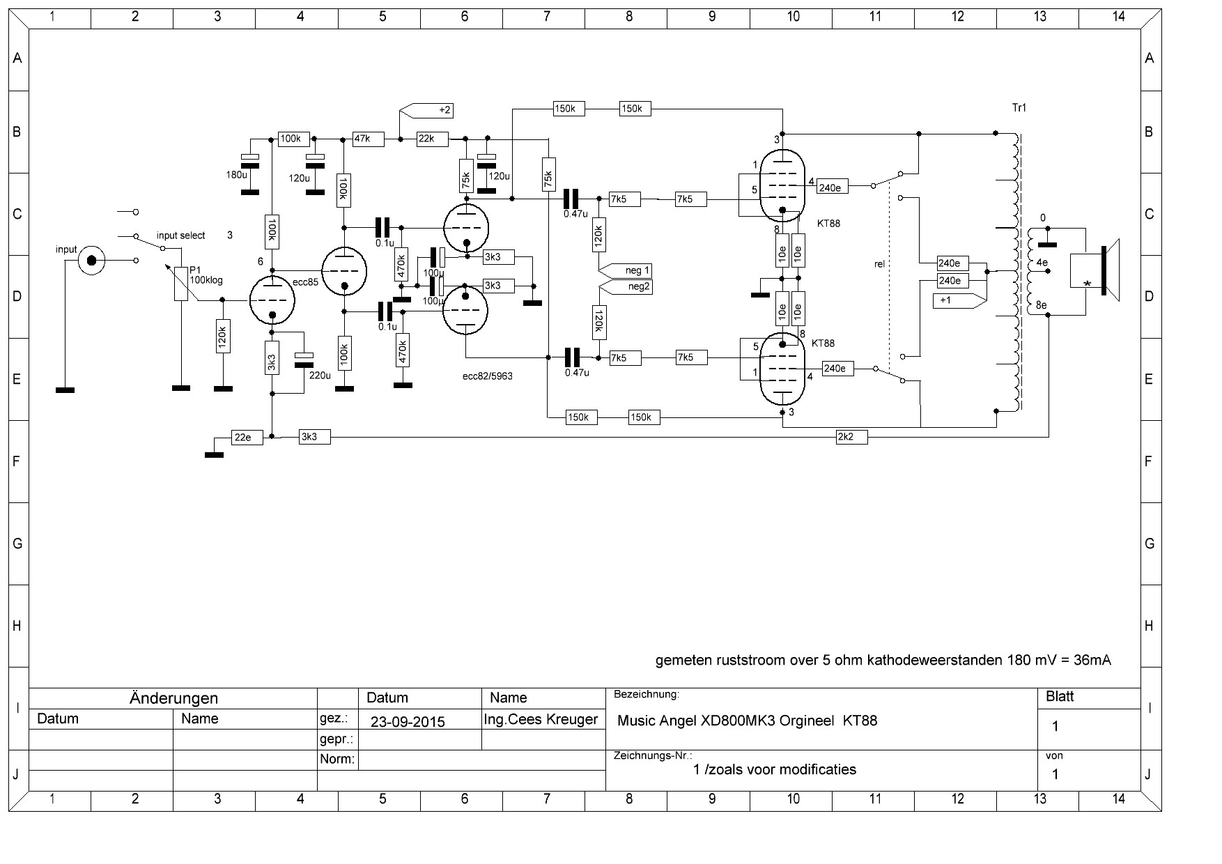

schematic
Here the schematic i found in my xd-800 mk3
good luck with your modifications !

Hi All,
last week I bought MA xd800mk3 amp. I knew that it comes with different parts values compared to original schematic posted on web. I've already write down the schematic which I found inside and it's very similar to goldline's version. But still I found some serious errors in mine amp. For example the negative feedback resistor is 25 Ohm! G2 tetrode resistor is 240k! I only turned it on for a few minutes to check is it working and check voltages on capacitors to prevent eventually capacitors overvoltage explode. Ofcourse the voltage on almost every capacitor was too high. 435v on 400v rated cap. 485v on 450v rated one and so on. Some of these caps are already bulged. So I ordered new ones. I want to make this amp my main amp, so I will make it as good as I can. New rectifier diodes, chokes in power supply, every electrolytic bypassed with MKP, jantzen superior caps, 6n1p and ecc82 tubes with rechecked and re-set work points and potentiometer in 12AU7/ECC82 cathodes to set the gain equally. I will post some pictures and corrected schematic. I would be VERY THANKFUL for Your sugestions
I also couldn't believe what I see on my multimeter. 25 ohm feedback resistor is branded as 'dale' and other 'dale' branded resistors on pcb are 7k8 and I think someone put 25 ohm instead 7k8 because they looks the same. I measured the G2 resistor. On schematic there is 240 ohm and in mine amp is 240 Kohm, so this could be also a simply mistake. I've found another difference in circuit. I have 470k ohm and 6800p from kt88 anode to 12au7 anode instead 2x150k ohm resistors. Maybe someone know what is this for? Is this some kind of feedback?
Wow, that's un-belieable, looks like someone really messed up... As for the 470k and 6800pF, they are for the plate-to-plate feedback. If you operate the KT88's in pentode mode, then they might be helpful, but for triode operation, not so much, therefore should be switched out of the circuit.
So it appears that you do not have the original factory built unit, but one that has been worked on by someone. So I think you should restore it back to the stock condition first, and modify it only if you do not like the sound.

This is the circuit which is working in my MA. I've written resistor values which I found in my stock amp. I changed ecc82 (driver) cathode bias circuit with 100r potentiometer to even the gain of them, I throw out input tube (6n1p) cathode capacitor, change input potentiometer for blue alps, which I found in my stuff, replace coupling capacitors for Jantzen Superior, replace buffering capacitors with higer voltages (not necessary) and put cypass mkp caps for every electolytic. I also modified power supply with chokes (1,2H for all tubes and also 10H for input/driver), larger caps in fixed bias circuit, higher voltage caps in main voltage doubler, uf4007 diodes bypassed with 10n caps instead slow ones mounted earlier and bypass most of electrolytics.
