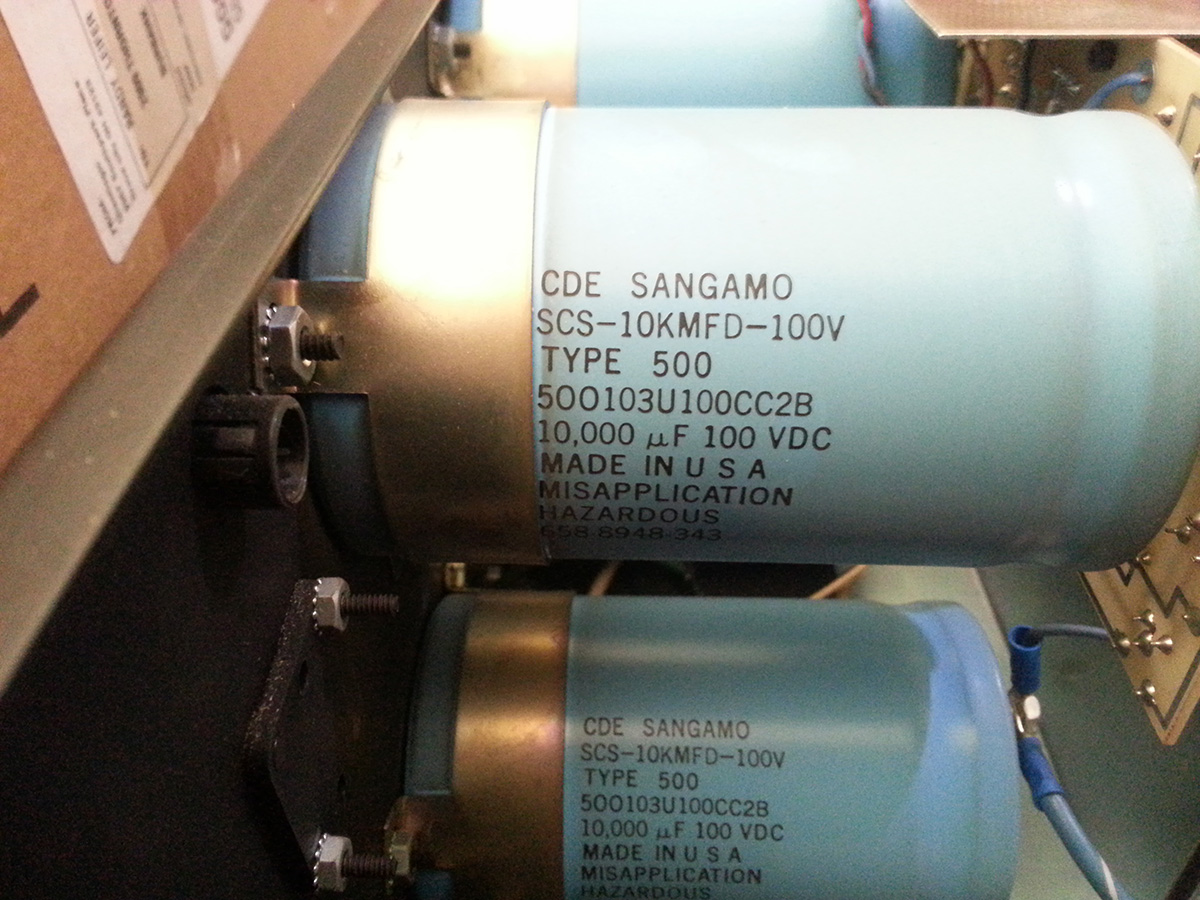

I still use all of them (no hum), and I'm contemplating replacing the (now) 20yo PSU caps in the Muse. From my best guess...replacement can caps would be.......
CGS103U100W4C
$58 x 8 caps = about $500
I think I'll buy one first, to make sure they will fit.
