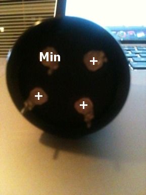

Bit of a silly question... I bought these caps, but they don have markings on it (not at the pins, nor is there a line for minus).... No datasheet can be found...

The four pins are not all the same. The pin that is closest the center of the capacitor is negative output. The postitive output is opposite. Looking at the bottom of the capacitor, the negative input is to the left, where the positive input to the right. I hope this helps.

The picture is not very clear. Usually the - is knurled. The + smooth.
Not too shure all three are + come to think of it. (So my pic might be wrong)(but you could easily check for that with a multimeter)
That negative pin also is also the "other" way round.The pin that is closest the center of the capacitor is negative output. The postitive output is opposite.
There's nothing knurled here (whatever that means) 😉
I retook the picture. One of the pins indeed points inwards

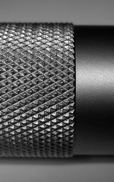

They are ALL knurled 😉 (See pic of what a knurled surface looks like)There's nothing knurled here (whatever that means)
Studiostevus - Thanks for the clear picture of the capacitor bottom. The pin that points inward is the neg output.

The capacitor pictured in post# 1 is definitely a Mundorf MLYTIC - SI+. This is Mundorf's discontinued 4 pole electrolytic capacitor. It may have the same pin assignments as a Jensen; however, this may have been done so it could be used as a drop-in alternative to the Jensen.
