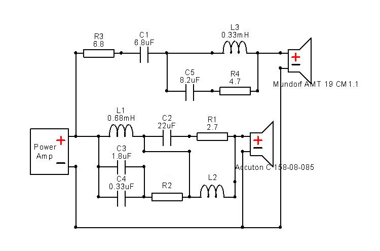

Looks interesting, I wonder what this topology is like? here is the layout of the pcb

Do a search here on 'series crossover'. There are a number of threads on the subject. Here is one example...http://www.diyaudio.com/forums/multi-way/27969-series-crossover.html
Thanks mate, I know what a series xover is, by looking at the PCB layout, it looks like they use a parallel xover topology, but heavy use of notch filters in series with drivers

The x/o cannot be series and bi wireable/ampable.
Building a new MA30 yesterday showed that although only one external set of binding posts is present, the internal crossover sections for woofer and tweeter are separate, each with dedicated wiring to the posts. Drilling an extra pair of holes into the circular rear plate and adding a pair of binding posts would allow the speaker to be bi-wired/bi-amped.
Tracing Mundorf's crossover pcb (no schematic was at hand) revealed it to be a series design, completely devoid of shunt elements other than the two drivers.

If you look at the PCB you can see that WF-, TW- and IN- are all connected (i.e. all connected to common ground). This would imply a traditional parallel topology and not a serial one.
I agree on no shunt elements in cross over all components are on path from IN+ to WF+ respectively TW+.
This also explains why bi-amping/bi-wiring would indeed be possible seen from the terminals.
Its a parallel x/o design with only series components, not a series design.
No speculation involved, you cannot biwire/biamp any series crossover.
rgds, sreten.

cph2000 said:If you look at the PCB you can see that WF-, TW- and IN- are all connected (i.e. all connected to common ground).
Not on the MA-30 crossover PCBs that I handled. WF-In and WF-Out are connected, likewise with TW-In and TW-Out. WF- and TW- are not connected on the PCB; combining the WF and TW wiring harnesses at the binding posts is what accomplishes this.
Otherwise, the passage that you quoted earlier from the Mundorf pdf appears to generally agree with the crossover PCB that I bolted into an MA-30 two days ago (haven't attempted to calculate the frequencies or simulate anything).
sreten said:Its a parallel x/o design with only series components, not a series design.
Ah. I'd forgotten how convoluted the English language can be 🙂. Have built a few two-ways with this type of series crossover, and agree that it is incompatible with biwiring / biamping.
Coil in series with tweeter?Judging by the partially shown filter schematic and with little
imagination, I have come up with this.
