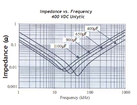

Hi Frank, my main power supply caps are film caps (there are 12 of these 760 microF caps), no electrolytics in my amp. And these film caps have ESR of 1 mOhm measured at 10 kHz. The 20 microF bipass cap you referenced has 0.0095 Ohm, which is almost 10x higher than my main power supply caps:
http://au.element14.com/vishay/mkp1848s62010jy5f/capacitor-1000v-20uf-5/dp/2133988
Won't the bypass caps affect the performance of the power supply caps in bad way?

It's not the ESR that's at issue but the associated ESL, the parasitic inductance that is associated with the construction of the device that's the problem. The combination of that inductance with the rated capacitance of the device means there is a resonant frequency intrinsic to the cap, some spec's tell you what it is. And only at that special frequency does the extremely low ESR actually mean anything, on either side of this frequency the impedance seen by the circuit shoots up dramatically.
Now that I know the nature of what you're using, let's look at somewhat similar film caps made by ecicaps, a range called Unlytic:
Look at the curve corresponding to 650uF, pretty close to what you've got. Yes, it gets down to 0.005 ohms, but then it shoots up as the frequency increases, hits 0.3 ohms at 1000kHz, 1MHz; not so impressive now! This is because the ESL is dominating now. Those 10 caps in parallel mean that you have theoretically improved all the good stuff by 10 times, so at 1MHz the impedance is 0.03 ohms, BUT, long lengths of wiring are needed to connect all those caps together, because of the physical size of them, and hence most of the theoretical advantages, at higher frequencies, disappear!

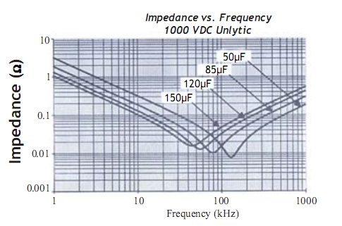

Now consider a cap in the same range, 10 times smaller:
The 50uF curve here has a key characteristic, the minimum impedance, where the ESR has a chance to do its job, has moved to a much higher frequency, roughly 5 times greater, and still looks pretty good, about 0.007 ohms. Something that those 10 560uF caps would be struggling to do, see what's going on here? It's the combination of the rated capacitance, the ESR, and the ESL that tells you where a cap will do a good job of bypassing, in terms of frequency, which is why paralleling several of different values works for a frequency range ...
