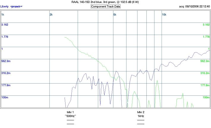

You can save the distortion measurements in Omnimic, sort of. The software will allow you to save a text file if you right click the plot area during the measurement process. You can have Microsoft Excel open a text file as a delimited CSV file using commas and spaces as delimiters, and treat consecutive delimters as one. Once it opens the values as an actual CSV spreadsheet, then you can save a copy as an Excel Worksheet, and do numerical conversions/plots there.
Here is one plot I generated using Omnimic and the above process with Excel:
Let me know if you need any more info.
