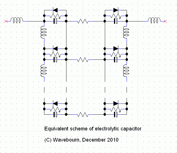

He's filtering PS! There ain't supposed to be anything in there but what's coming out of the rectifier... No mention of any noise or even a suggestion that anything else is there. Nothing other than a nearly "perfectly tuned" amp that "didn't sound real."...
PS supplies power to the output stage. It is actually in series with output tubes and primary windings of output transformers. If output resistance of PS is non-linear this non-linearities add to non-linearities of output signal. If PS has non-linear resistance it causes non-linearities that are well visible on FFT plots, when non-linear capacitance, it causes phase - related non-linearities that affect stereo image even when are hard to observe by static measurements. When Matti Otala first spoke of them loudly he was confronted by the crowd that did not believe that such small amont of distortions can be audible.
