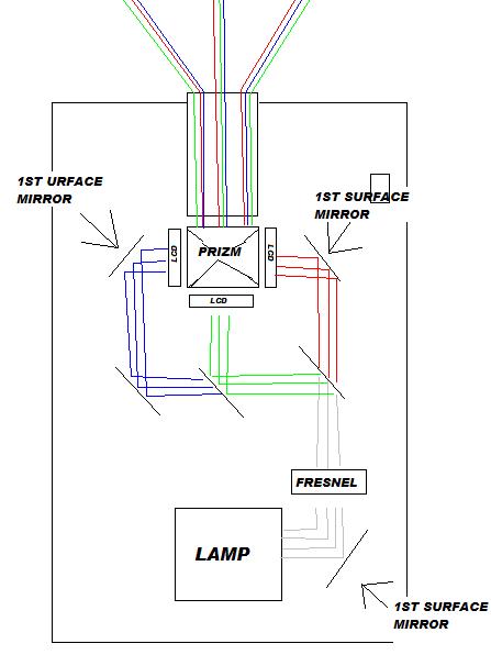

oem lcd projectors use 3 lcd panels to create the image. 1 lcd is old technology, back in the early ans mid-90's.
each one of these lcd panels handles one color, red, blue & green.
the "white" beam of light generated by the lamp passes through a glass sqare/boxy fresnel then through two filters(mirrors) to split the beam into three colors, red, blue & green. this colored light passes through the monochrome lcd panels and into a prizm where they are combined again and projected to the screen to form the image.
that is basically it. i have taken appart my epson 5500C many times and have cleaned all the mirrors and light filters so i know whats in there. if anyone is interested in seeing detailed pictures i will be willing to take it appart again. i dont use it any more since i got an epson 7500 which is xga.

If I am not mistaken those are special reflective filters that allow only one color of light to pass, the LCDs are probably just regular monochrome but are programmed to only show that colors portion of the image. Is that how it works guys?

yes those are reflective filters, the monochrom lcd panels display the same picture in each. this is why convergence is so important. and that is how all the colors (16 million) are created.
