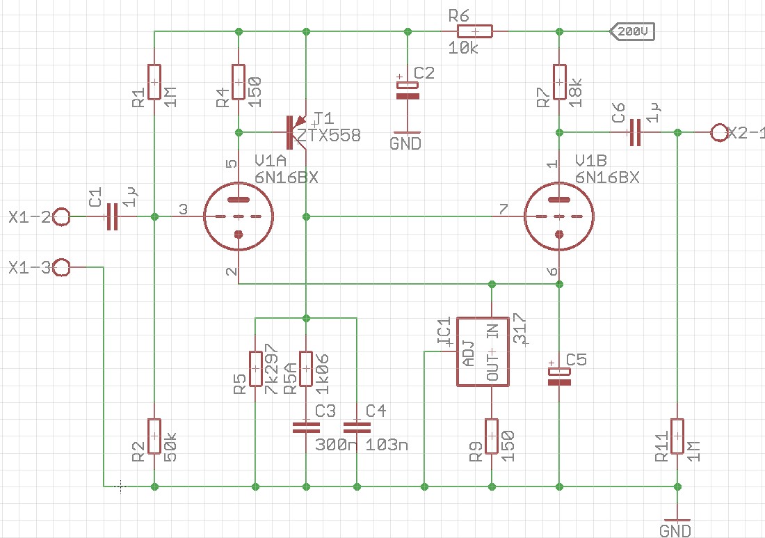

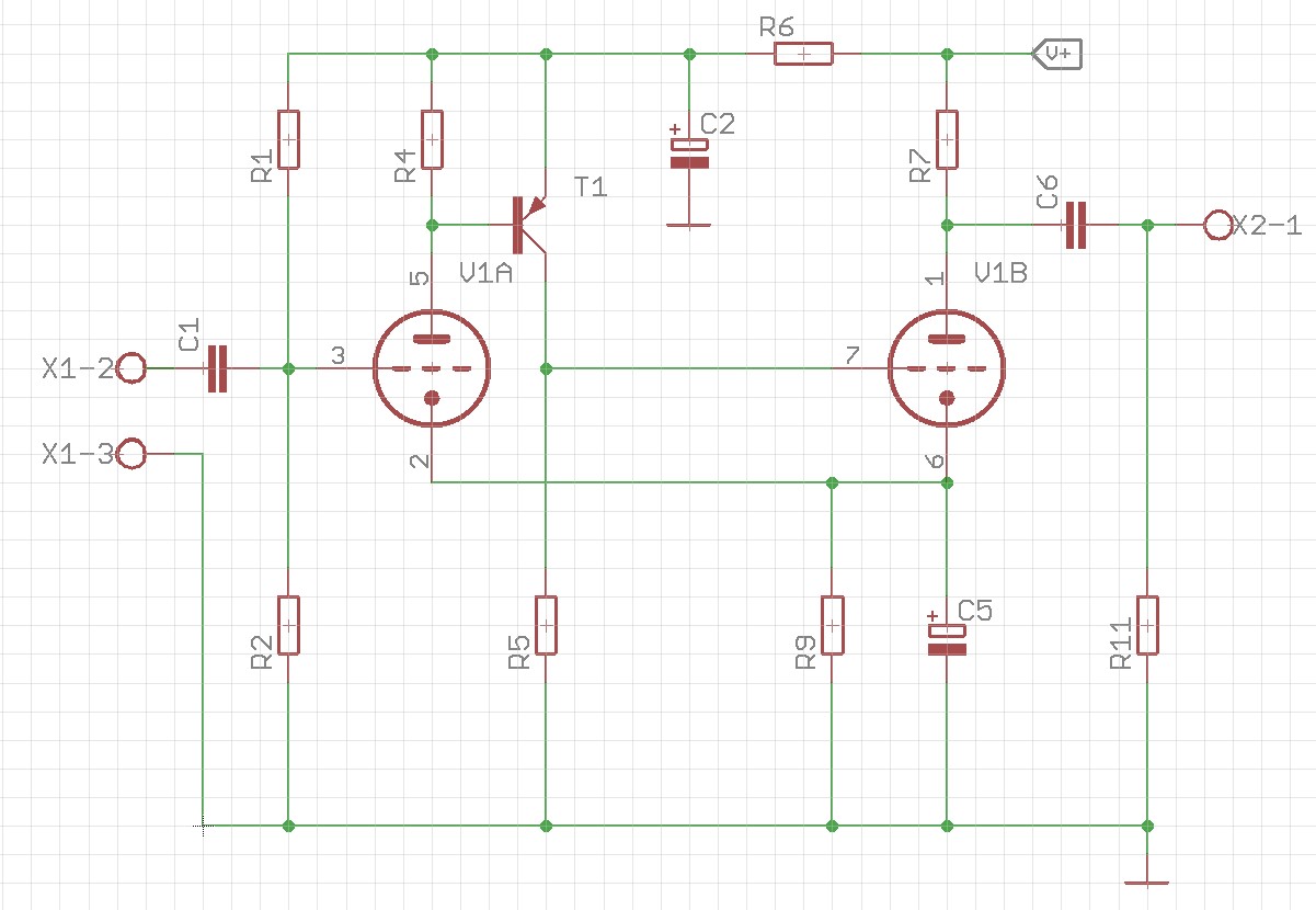

This is roughly the circuit suggested by Frank Blöhbaum; bias-current is set by R9 and by R4 for V1b.
T1 serves as a "transconductance-multiplier" for V1a whereas R5 transforms the collector-current to a voltage for the next triode V1b.

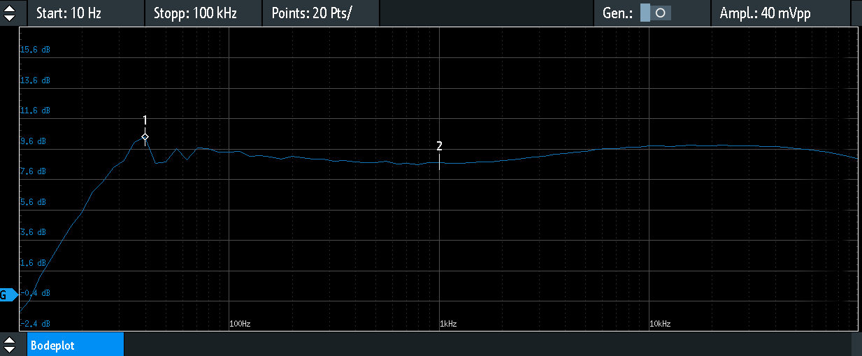

The first tests were promissing: wide bandwith (20Hz to >>100kHz) and high gain (49dB). Input resistance is ~45kOhm.
Frequency-response (the 40mV input is scaled down by the anti-RIAA by 100):

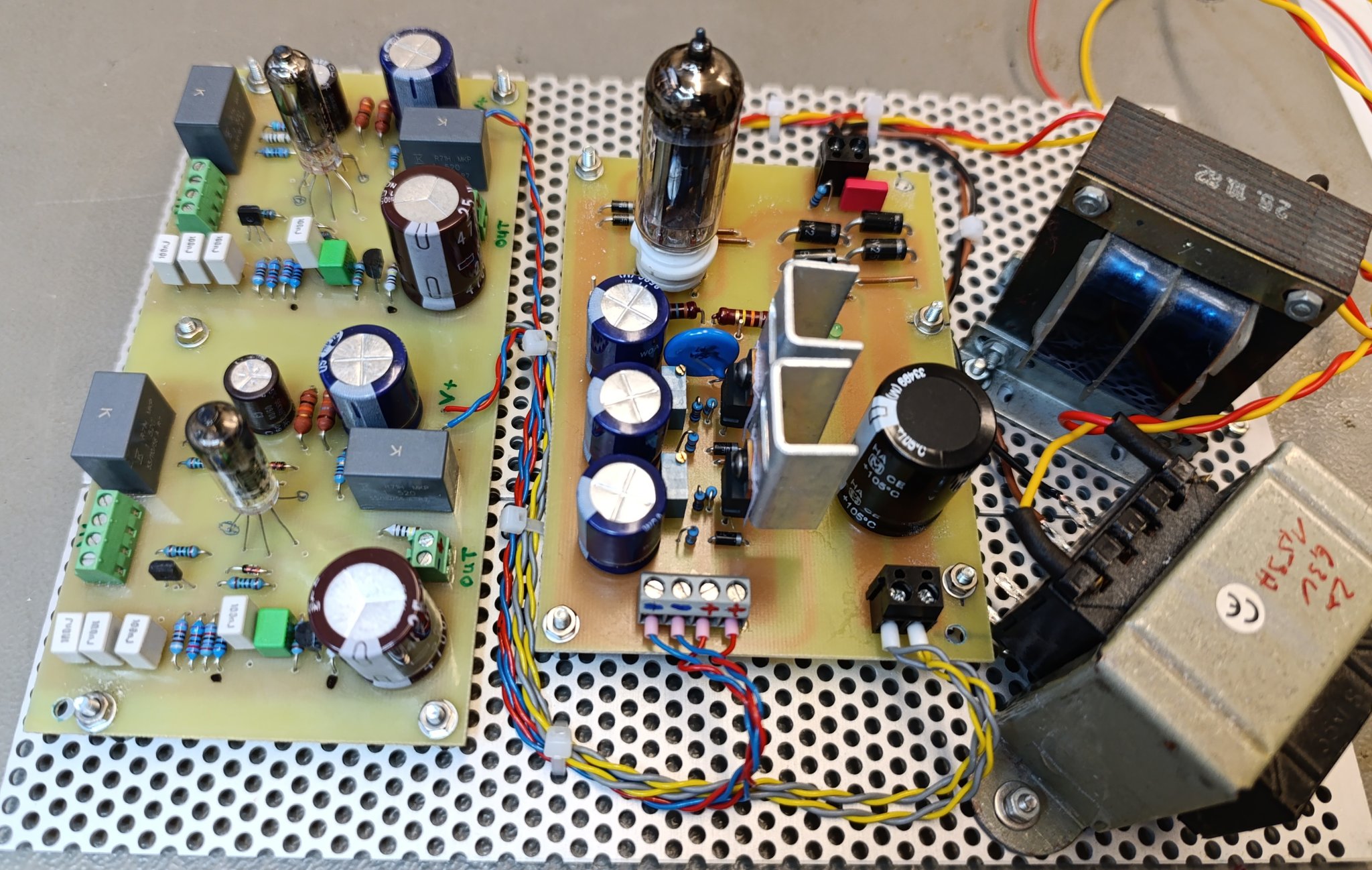

The first test-board with PSU:

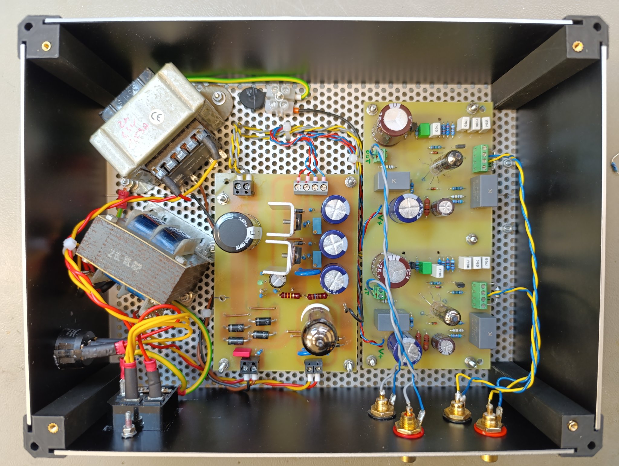

The final amplifier in a housing. The corner-elements are 3D-printed, the alu sheets are from the bin.
Protection earth and signal ground are separated by an ICL (10Ohm @ 20°C). Some rubber pads serve as provisorical feet.
I also forgot a separate grounding-connector for the tonearm, so I clamped the grounding connector from the tonearm wire under the top cover sheet (in contrast to my other phono-preamps it made a difference here when I connected it- possibly a result of the input-capacitor? My other phono-pres are DC-coupled in to out).

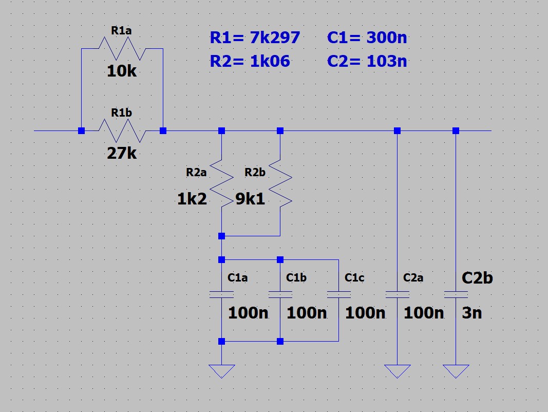

I f someone wonders about the unusual RIAA network:
These values are easy to find and it offers high precision.
I use Kemet SMR PPS capacitors, which are available in +/-5% tolerance (Panasonic offers PPS in +/-2%) in combination with 0,1% resistors.
I bought enough of these capacitors to select them to <1%. This is easily done with the 3x 100n in parallel.
For the 103n capacitor I take whatever is left after matching and combine it with a 2n2, 3n3 or so…
Most of the phono-amplifiers I made are Opamp-based and for this I like networks with lower impedance.
