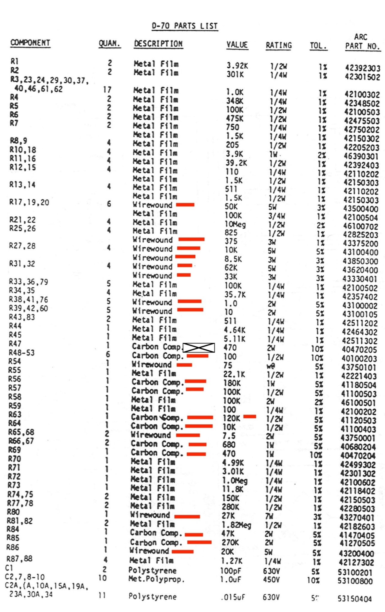

Multiple values specified for same part numbers in parts sheet?
Look at the attached parts list. Note how some lines, like R7, R12,15, R13,14, etc have two lines, specifying two different parts. How am I supposed to interpret this?
It still doesn't indicate which part is for which version, though. For R27,28, it lists 10k and 8.5k. The schematic lists 6k or 7.5k. And I've found a modification notes that specifies replacing the 7.5k with 6k (which is what I actually have on my unit). None of this explains how to interpret line R27,28 :/
The totals column suggests that for each of the resistors, there are two values used at the same time, not either/or.
Could it be that they are two in parallel or in series on the PCB?
Like R31, R32, each consist of 62k + 33k, in parallel or in series.
The values are also too different to be for different versions.

I looked at quite a few schematics and part lists from AR and they all have the same weird notations.
I think they are ment to cover the different revisions but this is never explained anywhere as far as I know.
Hugo
That's completely broken list, most of the quantities are wrong, I suspect it was regenerated and merged with another version at some point and got into a complete state that's been left to confuse and confound. My best guess is someone foolishly decided to renumber all the parts, or merged designs with clashing part numbers...
