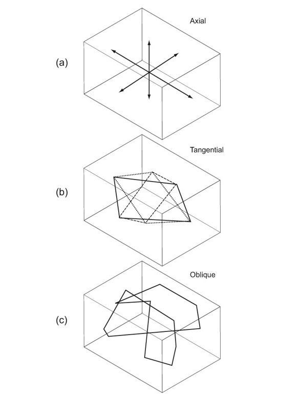

Floyd Toole explains it better than I did. Chapter 8.1 Sound Reproduction 3rd Edition:
"Figure 8.1 shows for a rectangular room: (a) the orientations of the three axial modes, (b) the three tangential modes, and (c) one of many possible oblique modes. Because some energy is lost at every boundary interaction, modes that complete their “cycle” of the room with the fewest reflections are the most energetic. The axial modes are therefore the most energetic, followed by the tangential modes and the oblique modes. It is rare for an oblique mode to be identifiable as a problem in a room. Tangential modes can be found in rooms having significantly reflective boundaries, or when multiple sources are appropriately located. Axial modes are omnipresent, and they are the usual culprits in bass problems in small rooms. Fortunately, they are easily calculated, as described in the box.
Calculating all of the modes in a rectangular room is more difficult, as the equation in Figure 8.2 shows. The method of mode identification is helpful if one is trying to track down the origin of an irritating bass boom and from that to decide on a remedy (see Figure 6.2)."
(The lowest frequencies are the longest and reach out to the axial boundaries. Their energy is least absorbed by the room boundaries = less energy required to excite them. Most rooms don't pass the axial modes until after 40-60Hz.)
