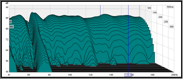

This is a relatively good measurement:

The first set of before and after waterfalls clearly show major removal of modal resonance/ringing using eq. How do you account for that?
Note I said "reasonable" for a "domestic" environment. I have worked in over a dozen pro recording studios in 10 years, all designed for optimum acoustics using eq, acoustic treatements, etc. Some studio pics here: Hear music the way it was intended to be reproduced – part 5 - Blogs - Computer Audiophile
The waterfall that you show, which is not yours, does have a large resonance at 80 Hz which will sound like "single note" bass, even though the rest of the decay is smooth. However, the graph is cut off at 40Hz which looks to be the beginning of more low frequency ringing. Too bad we can't see down to 10 Hz.

the after waterfall still shows major problems all across the range.
yes, eq removed small amount of resonance. but its FAR from what treatment can achieve. Im not against using small amount of eq, especially after treating your room but eq wont solve anything serious just like your before and after measurements shows.
the measurements Ive shown will not sound like ''one note bass'' but yes theres 40 and 80 hz rigning.
