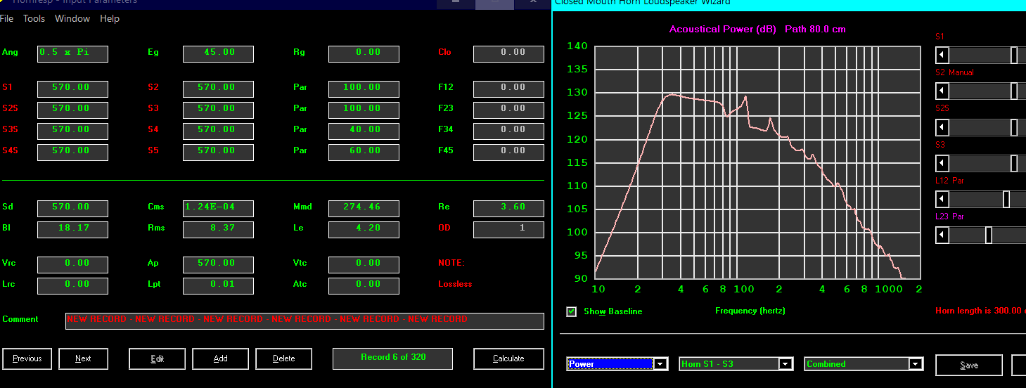

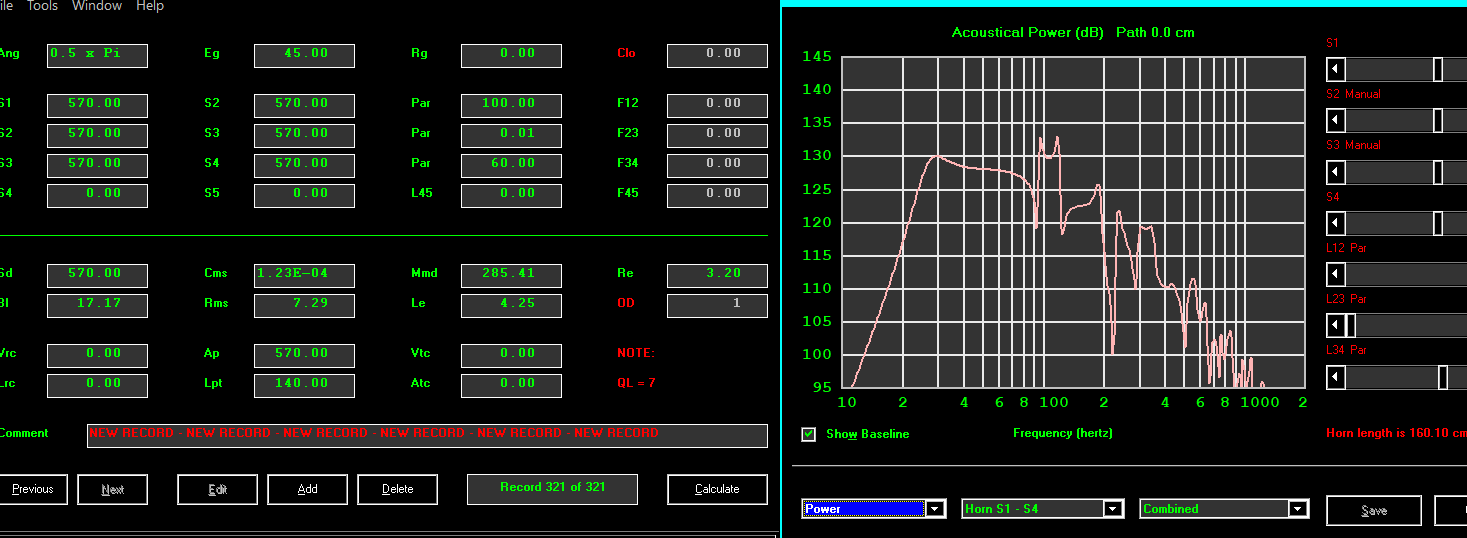

Multiple stubs in QW pipes?

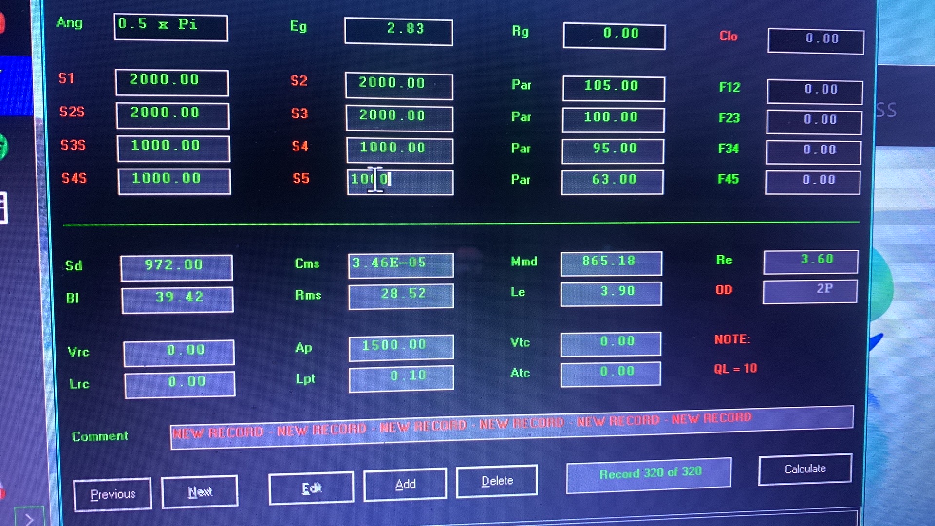

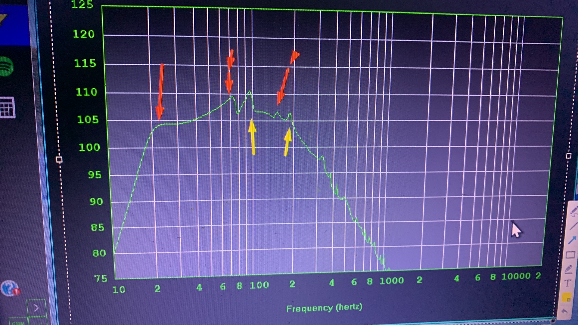

If I put a stub in a 300cm TL as L12(100cm) and add the stub as L45(60cm), I get rid of the second and third resonances (300/3 and 300/5 shown as red arrows.
but what are the new yellow resonances created (by adding the 60 cm stub at the end? )

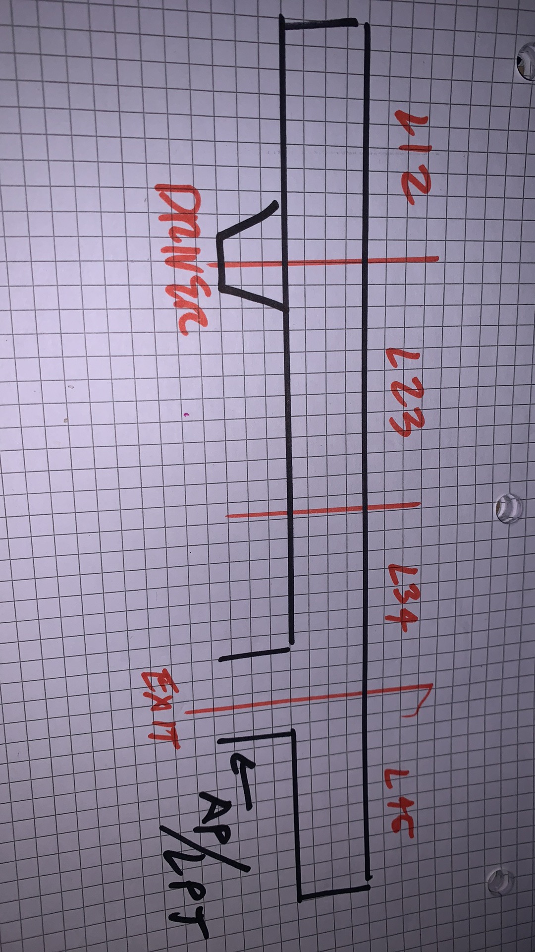

Maybe this is better? I offset the driver at the second resonance(100cm) and I offset the exit at the third(60cm)?
still have those ‘new’ resonances at ~75, 50cm, etc and this 300cm long??

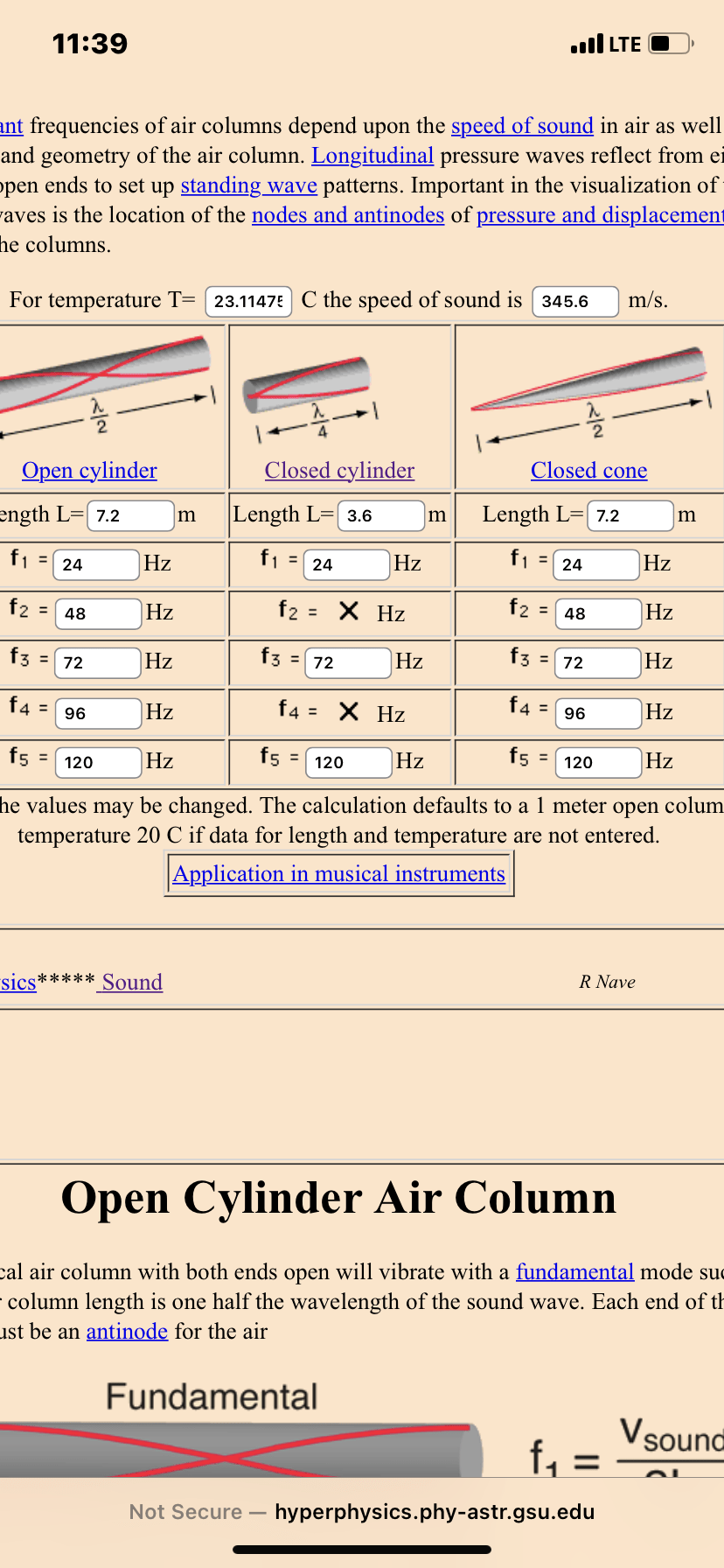

even numbered harmonics of the entire 300cm with closed ends maybe?

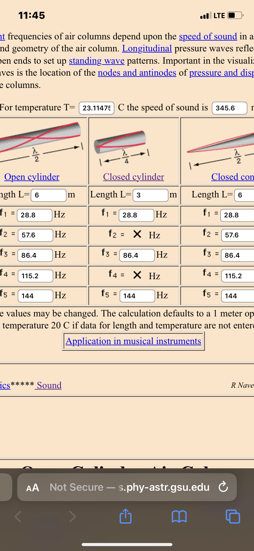

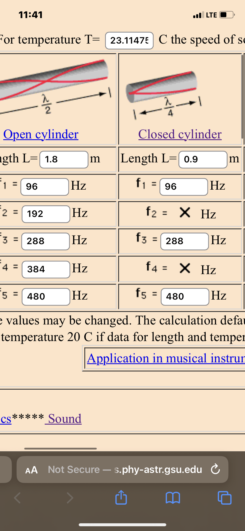

60 x 2 is 120 cm? This muffler reference gives 1/2 wave to the upstream stub and 1/4 wave to the downstream section and stub?

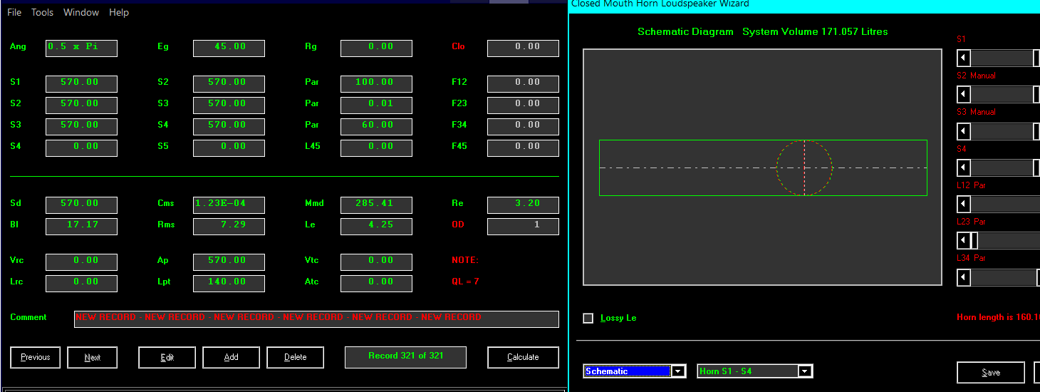

wondering what all these resonances are and what part of the ‘pipe’ they are generated from?

Yep. 🙂 IMO, the thing with optimizing axial/longitudinal stuff is that reality is in 3-D. I don't have time to look harder at your muffler book apparent discrepancy, but it wouldn't be the first time a book had a misprint. Maybe it's right--dunno--no time/brain for that right now. If you don't trust what HR is showing you vs. the book, stick it in Akabak to confirm, etc. Maybe that spicyTL thing does stubs too and is easier to you than Akabak. What about the old Leonard thing--is that still around? You need another tool, BW--it's time... 🙂 HR will always be your love, we know (and ours too!), but, like audio, sim tools are not monogamy and it's okay.
OK, Still a bit :scratch1: on HR's way to do these various MEHs, so view my rev with a 'jaundiced eye'. 🙄
ATM no clue if this answers your original Q, but at least you'll be close assuming me n' HR are fundamentally correct.
Forgot to set QL to 'lossless' to highlight this extremely resonant pipe.
