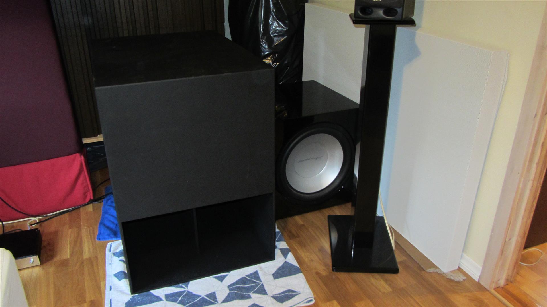

Had a look Omholt thanks. If I added one of those to my setup here, the one thing thats guaranteed is that i'd be shot 😀

What are you talking about. This is tiny!Had a look Omholt thanks. If I added one of those to my setup here, the one thing thats guaranteed is that i'd be shot 😀
Here next to a 18" sealed subwoofer. 😀

In some parts of the UK, you can rent a room not much bigger than that sub for several hundred of £s / month!What are you talking about. This is tiny!
