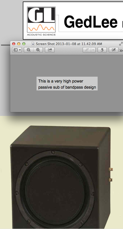

Why then is this "fluffy" passive radiator bandpass sub (with only vague specifications) the only one listed on your website 😉?
I still sell the PR bandpass - at least while the PRs hold out as they are no longer available. It is a "good" sub. There are other models listed in the price table.
What specifications are relavent for a sub?
Resonance? - doesn't matter, it will be EQ'd.
Power handling? - look that up on the B&C website - 12TBX100
Efficiency? - also on the B&C website.
Last time I checked, the only specification that applies to your PR bandpass sub on the B&C website was the power handling and DC resistance of the 12TBX100's voice coil .
One can certainly EQ anything flat at a low enough level, but if one actually wants high SPL low frequency, there are many useful specifications which will separate the wheat from the chaff.
Relevant specifications for a sub are frequency, phase, and impedance response, sensitivity, harmonic distortion at rated power, and power handling.
Since manufacturers know that showing THD at the rated voice coil power handling would look terrible, we seldom see more than phase, frequency, impedance and sensitivity response.
Those would be three relevant specifications that are lacking for your "good" sub.
