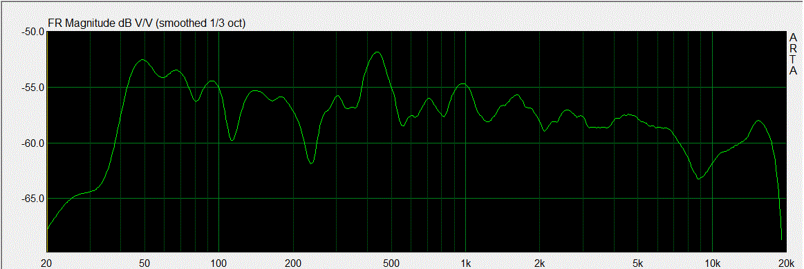

Here is a shot of my current system, both channels plus three subs, and the small dip at 9kHz might be a positional error, anyway...
This response is revealing, not having a strong signature. Some recordings sound a little thin and others sound a little heavy, however slightly more often they are heavy especially with male vocals.
Does my bass region have too much boost?

But you want to add a 4th sub to a tri-corner? Well, try and measure. I'd try placing it somewhere else, even off the ground.
By the way AllenB, if you want to show meaningful data, then switch off all smoothing and make sure the frequency resolution is about 1Hz. That kind of steady state data from all frequency sources playing at once is meaningful for about 150-200Hz and lower. Above the Schroeder frequency, only single speaker measurements are meaningful.
