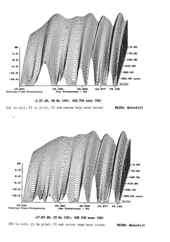

youngho, no, I was talking about the rate after the initial drop. Looking at the picture Todd posted, the line on the left hand side decays faster than that on the right side. In the first few ms there's a huge drop but we still do not know if this is enough to render the ringing inaudible.
Todd offers an explanation:
So you end up with a corrected response that has two slopes, from the Q of the resonance and the correction filter not cancelling correctly. Should it be surprising that the decay in time has two slopes then?
But doesn't this bring us back to my initial comment that I've never seen a CSD that clearly shows that an EQ completely eliminated ringing?
Hmm, it goes to zero on the right earlier, no? It decays faster on the right initially, then it seems to decay more slowly after that, but it reaches zero earlier. And shouldn't inaudible should be at the level of the noise floor?

Here's one I measured myself, a resonance at 28 Hz, no eq and eq.

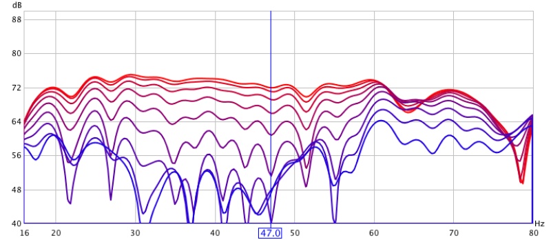

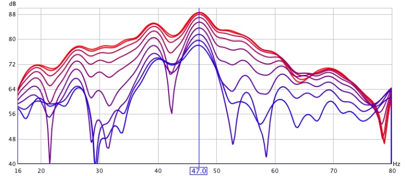

By courtesy of the Anti-Mode 8033 subwoofer EQ developer I'm posting a before/after comparison of what the aforementioned little box can do with regards to the decay rate of LF modes.
The time slices are 20 ms each, so from 0-160 ms. The comparison clearly shows faster rate of decay, at least up to 160 ms.

Talking about that box, how does it determine the target magnitude?
