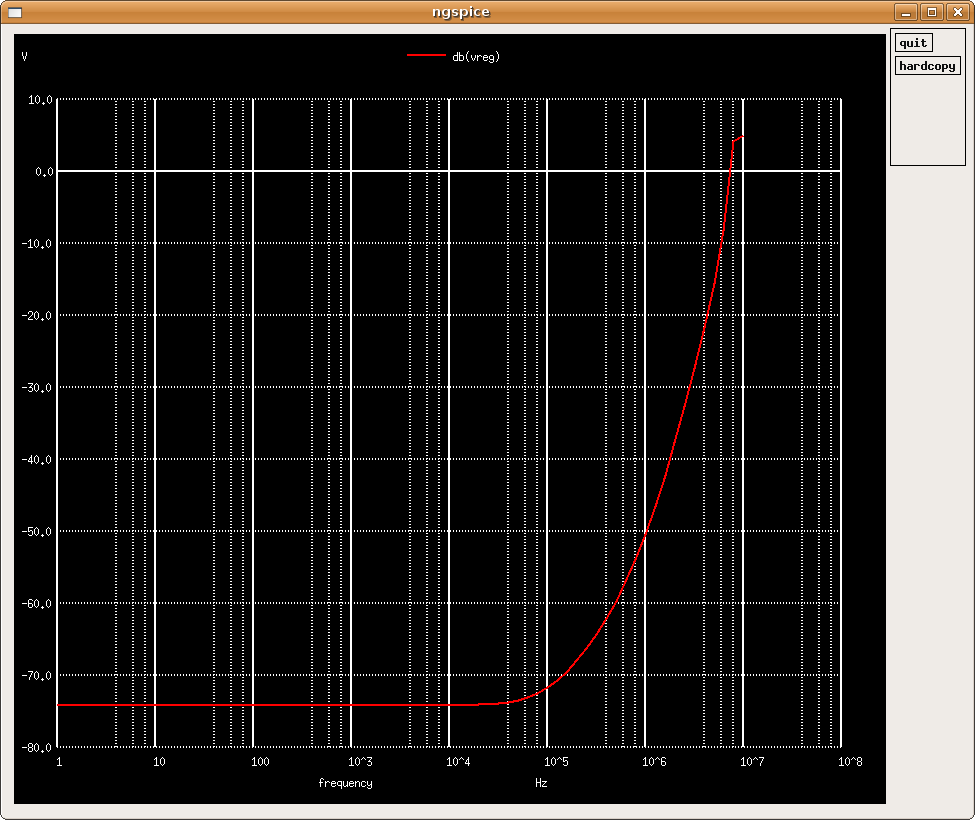

I have played a little this schem in the simulator. It is quite conventional and it seems fairly stable once the diff pair resistor values are dialed in. The concept is sorta the same, but with a shunt regulator instead of series.
sources need to be changed obviously... 😉
Here is a plot of the power supply rejection - when approaching 1mhz, the thing starts oscillating, but this can be prevented with some filtering, which I'll add later.
I got better low frequency rejection with opamps (higher gain), but the bandwidth was very limited compared to the diff pair (lm324 - I know cheap opamp). I think transistors will be better because it is easier to find good high voltage transistors for a reasonable price.
