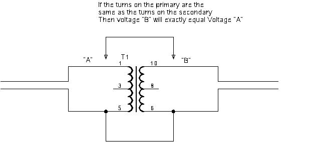

There are some assumptions, possibly valid, in your asignment of leads to primary and secondary windings.
Do you have access to an Ohmmeter? Loads should be temporarily disconnected as well as the AC input of course. Using an Ohmeter to actually verify which wires are in fact part of a given coil will be helpful. If the Ohmmeter has a low Ohms scale you can usually spot the center tap because it will have lower Ohms to each winding "end" than the winding "ends" have to each other.
Some tranformers are made with a shield, this is usually a foil layer (non-shorting) between the primary and secondary. This layer is used to reduce EMI from getting into or out of the secondary. The shield will of course come out on a transformer lead which will be the only lead on the transformer that has no second end. When operating the apparent voltage on this lead (with no load at all) could be equal to the primary voltage or very close because of capacitive coupling. Typically this lead would connect to chassic ground.
It is painful but possible to draw a quasi schematic using Windows paint. Don't try and draw coils, just make boxes like the Europeans do for each winding and seperate them with a dotted line for the core. Label each winding end color and we've got a good communications tool. When you are finished, use "save as" to make it a JPG file for this forum. Attach it using attach file function. This way we can probably get an answer faster, if it's worth the trouble.

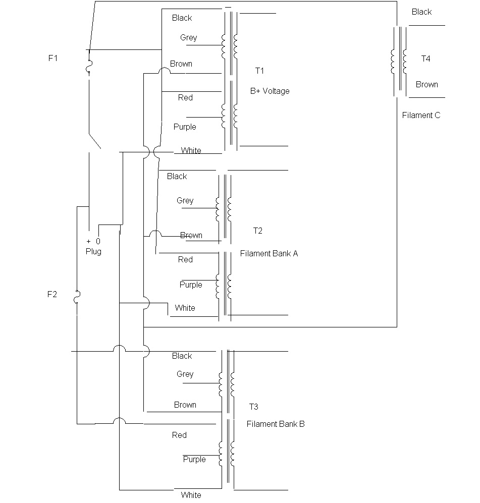

Okay, here's a diagram. There are three dual primary transformers, and one small single primary transformer. (Only the primaries are of concern here.) On each of the duals, black and red are the hot connections and White is neutral. Grey and purple are unconnected and tied off.
The concern is the brown connections. Each is the lower end of the top primary of each dual transformer. Brown is also the lower lead to T4. All four brown leads are tied together, but I can find no connection that ties them to neutral, the white leads, or anywhere else. (It is interesting to note that the diagram of a slighter later version of this design replaces T4 with the bottom half of T2 and connects these brown leads to neutral and the white leads.)
Voltage readings show the normal 117 VAC between Black or Red and White, and a volt less between Black or Red and Brown.
I have two questions.
1) From where is joint connecting the brown leads getting its neutral or near neutral reference?
Question 2 involves the fuses. Fuse 1 is tied to T1, 2 & 4. Fuse 2 is tied to T3. It should also be noted that the secondaries of T2 and 3 are tied to solid state voltage regulators.
One day Fuse 1 blew. This would cut out T1, 2, and 4, but T3 would remain operational. Indeed it was, and it was normal. What was weird was that the regulator tied to T2 was running, but very very hot.
2) Where was it getting voltage from? All I can see is that it must have been getting something from T2's brown lead that is tied to all the other browns, including the one on the operational T4. That said I assume the voltage was not what the regulator would get during normal operation, hence the overheating. Does that make sense?

The transformers are doing what they are supposed to do. The two primaries are tied together at one end (Black and Red) if they have the same number of turns transformer action will make the other end (White and Brown) exactly equal. See my sketch
Exactly; The same effect as in my sketch was causing T1, T2 and T4 to be fed by the Black Brown windings of T3. It would appear that those windings were somewhat inadequate to run the other three transformers, resulting in inccorect voltages at their outputs so that is probably why the regulator on T2 was very hot.
If the transformer primaries are not exactly matched wiring them in parallel will get the two primaries to "fight" each other resulting in excess heat. I think the Brown leads should probably be connected to the White

I don't quite follow your sketch as it involves the primaries, but I do think I get what's going on from what you've said, i.e., that as long as the red and black leads of the primaries are connected to hot and white is connected to neutral, voltage will appear at any leads between them.
It would seem to me, too, that the brown leads should be connected to the white. They are in the diagram I have of a later model of this preamp (version B). In that one, there are four transformers, each with two primaries and two secondaries. Three are arranged with the secondaries tied together in series. In T2 the secondaries are tied to different circuits. In my version (A), T2 is wired like the other three, with the secondaries tied together in series. There is still a need for the separate circuit supplied by the secondary of T2 in Version A: that need is fulfilled by a separate single transformer. The normally neutral lead from that transformer is tied to the brown leads of the others. Maybe this wierd wiring of not connecting the brown leads to the whites it has to do with that.
