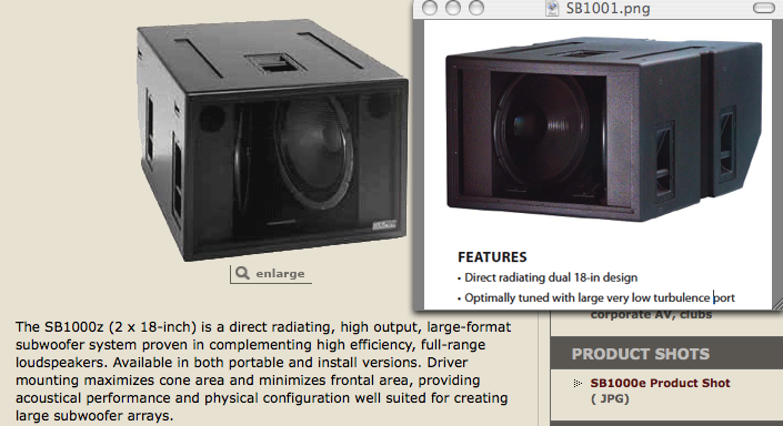

Just to add some real world experience. Both the Meyer 600HP and 700HP use two pairs of differently sized ports.
I'm sure there are others out there, but those are too I'm very familiar with.
The EAW SB1000z use a large central duct between the "V" loaded speakers and smaller ducted ports on either side of the "V", probably reduces the port resonance peaks that have been previously mentioned in this thread.
Even when a sub is band passed well below the port resonance, upper harmonics generated by the speakers when run hard can still be amplified by the port resonance.
In other words, the "optimally tuned large very low turbulence port" honks :D.
Art
