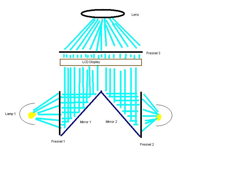

I actually scored two HQI-T150 lamps and ballast from some commercial projectors. I've yet to complete my project but I fear one might not be bright enough. I was thinking the same thing of using 2 lamp sources. I've been playing with this idea...
What do you think?

That sounds awesome. I will have a spare fresnel-pair (heat deformed it, and I tried to compesate with heat on the other side -> BAD IDEA, it deformed too much) that i could use to make some tests on your idea, if noone prove your idea impossible.
Maybe a test with regular bulbs can tell if it would work, so I don't spend even more money.
But thanks for sharing the idea, hope you do try that, as everyone else, maybe we can come up with a new light setup thats more efficient.
Thanks slappy, and more ideas people!

Your first thought with maybe 2 fresnels connected/cut to size with 2x lamp could work, perhaps 2x 150 or 2x 250.
slappy76
This looks possible to me as well just needs to be tried.

I might be able to test the 2 back-fresnel setup, but I won´t cut them yet for now, I would like to try a few designs before doing that. So maybe i will do a partial test to see if I can get anything from it. But I still have to wait my new fresnels get here so I can move on on the tests.
