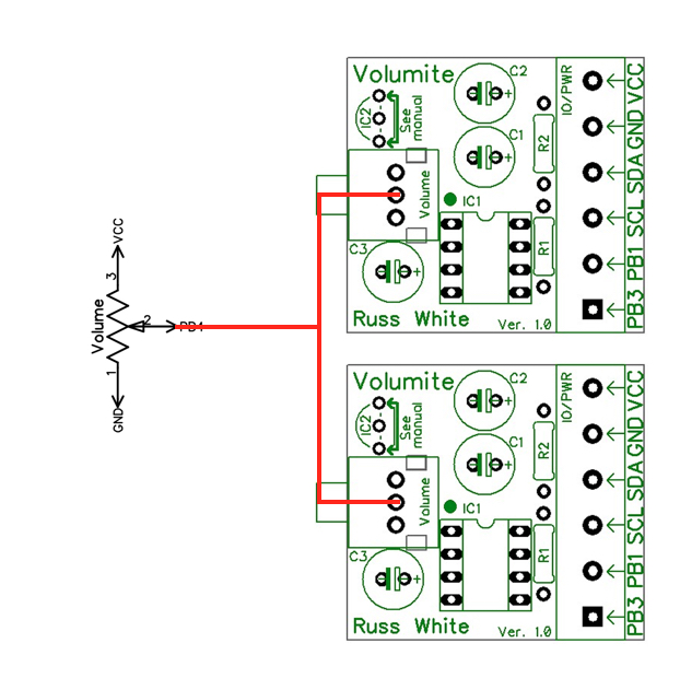

Another simple approach is to use a single pot to control two Volumites. You would just need to share the ground and wiper pads of the two Volumites, and use the V+ pad from one of them.
The cleanest, but less simple, approach would be to edit the firmware to communicate with two I2C addresses at the same time. I will try to look into that.
Great minds think alike 😎. This was my thought too, and then I figured I could extend the idea by upgrading the pot to a heavy, "feel good" component for an improved user experience. Bolt that to the remote panel, remove both pots from the Volumites, and have the big pot's wiper feed both Volumite terminals.
Hi Brian,
to connect 2 volumite together, can I use a single potentiometer (pin 1 to GND, pin 3 to VCC) and connect its wiper to the 2 volumite boards ?
Please see the attached picture.
