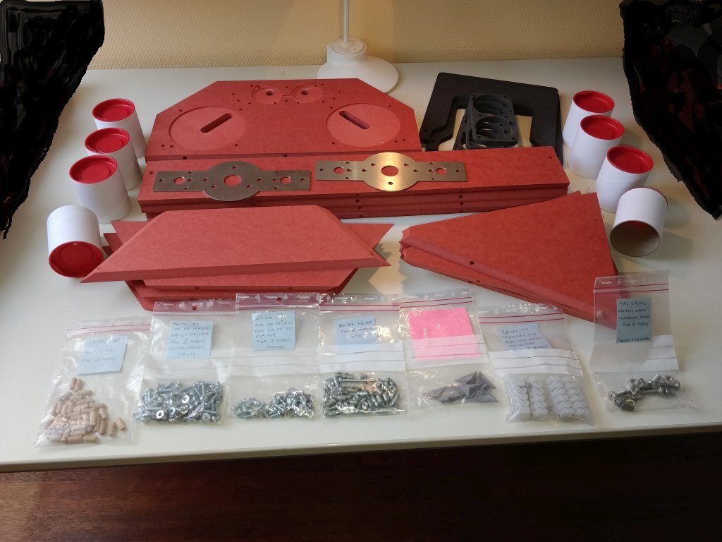

The following is my experience at designing and manufacturing Multiple Entry Horns as the Prime Mover in a Group Buy project involving a CAD/CAM process and routed by CNC to flatpacks like below:
Despite some cost doing Computer Numeric Control, we are very happy with the appearance and performance of the horns so far.
We hope the following can serve to inspire other DIYaudio members, and we shall strive to pass-on as many of the data aquired, as the project goes along, to hopefully act as a stepstone for a CNC MEH project that you may have in mind.

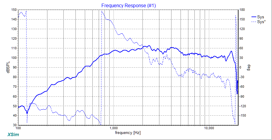

Nice! VERY thorough work there (as described in your document).
I'm glad that the FR-5 midranges worked out for you. I tried that on a later plywood horn, but had some problems (probably with the horn itself, I tried to change too many things at one time and lost track of what was causing what effects).
I'm surprised that the HF response seems kind of bumpy, I wonder what that might be about? Are you rounding the throat entry for the DE250? I used a 1" drill to take the square to round, when I did the Cosynes, then blended it a little more with some sandpaper. I don't know what effect that might have had. I'm using a DE250 (well, a good clone of it) now with a 3D printed horn following 'oblate spheroid' curve there and the response with that came out reasonably smooth (see attached)

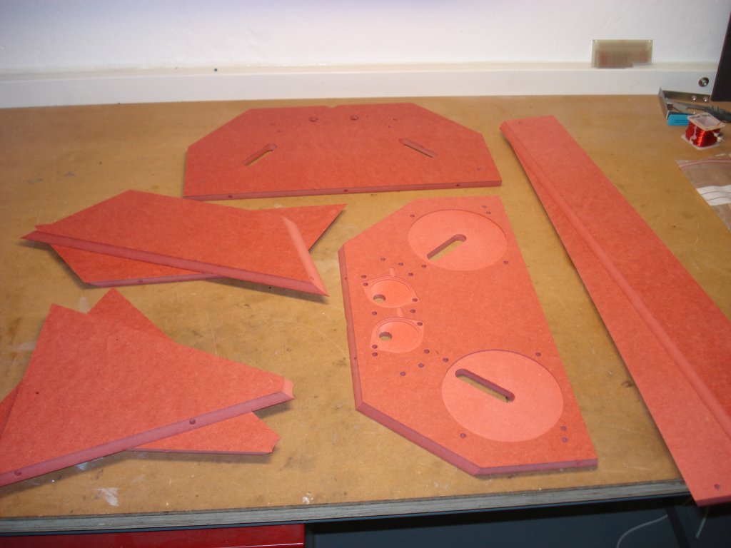

I don't quite see what the narrow board that are on just forward of the woofers outside the board are for?
Is that a mounting arrangement maybe?

The throat section is "raw". The round-to-square section as routed. Indeed, some sanding could smooth things, but as it is, it should maintain conical expansion all the way in to only 2mm from the CD driver exit (stainless steel flange thickness).
I am not sure what you mean by "in front of the woofers", but I think you refer to the long pieces of the final flare. I did not bother to cut the corners back at some strange angle. Instead it simply continue to the plane of the edges of the short pieces of the final flare. By this, a plane face develops on the sides, which will make it easier to make some fixing of the horn to the rear chamber with less visible screws.
If you mean the white blobs in the pic., they are simply 3D printed fill-ins, made only for a nice appearence, seemingly blending three faces together.

Looking at the individual driver frequency responses the sensitivity on the DE250 seems low? getting up to 2kHz on the mid-range is very good. I would guess maximum output of this design is limited by the woofer sections low bass capability where it no longer has horn loading?

Oh. Never mind, I see it now. It's just the wide flare piece continued out to the ends (not a bad idea, that would be handy for mounting).
Great stuff. It's hard to read the FR graphs though- any chance of reposting them somewhat brighter? Is the endgame a group buy?
Better pictures
Reply to post #10, Badman
Did you look in the folders "Better pictures", also in the cloud link in post no. 1 ?
Some documents/pics suffer from being eksported as .pdf.
Therefore I put in each picture in the docs in a separate folder, in same sequence as you see them in the docs.

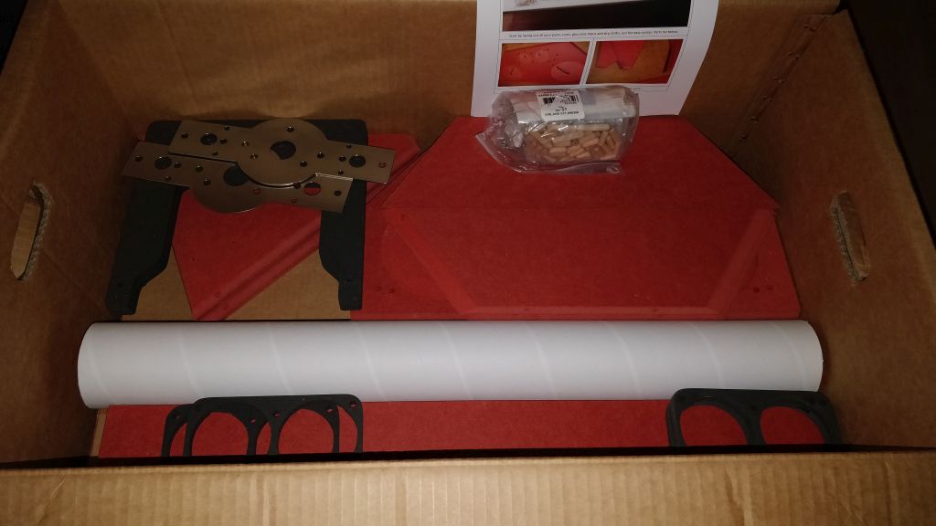

If you plan to build a set of MEH's just like mine, I can offer you a complete set (two horns) at cost price, ready for Visaton FRS 5X and B&C DE250.
Surprisingly 400+ parts, counting all bolts and inserts too.
Refer to the folder "Surplus Items" with the assembly instructions in my signature link below.
