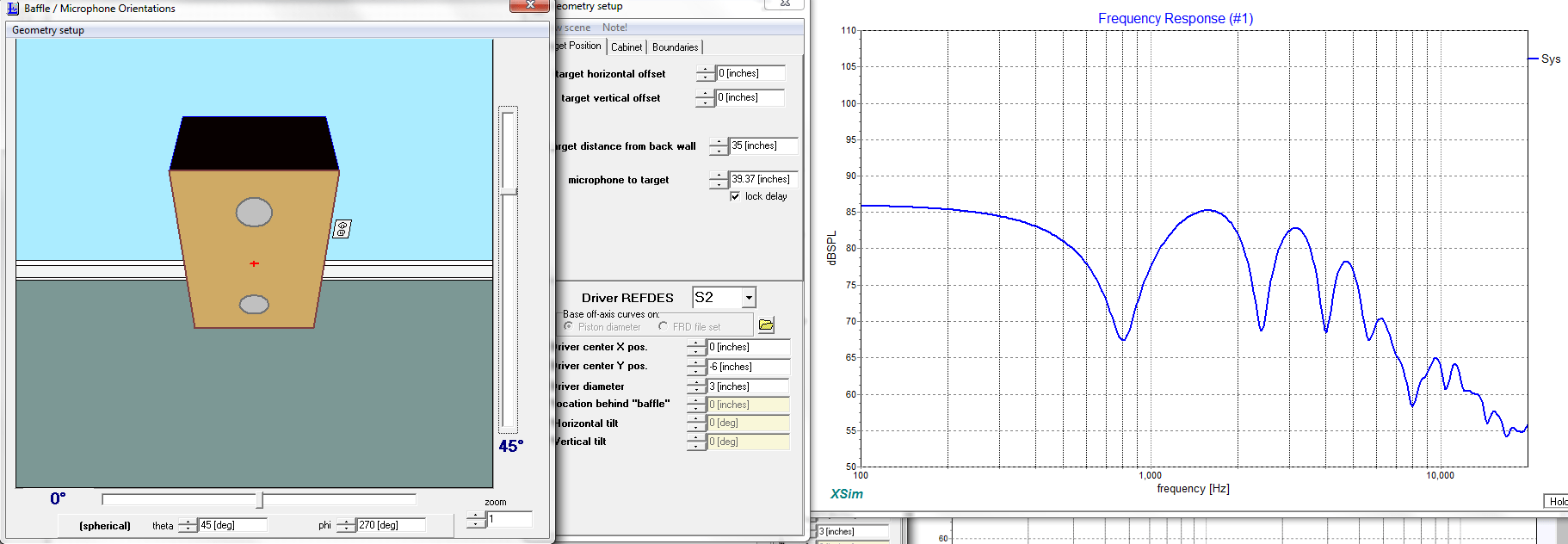

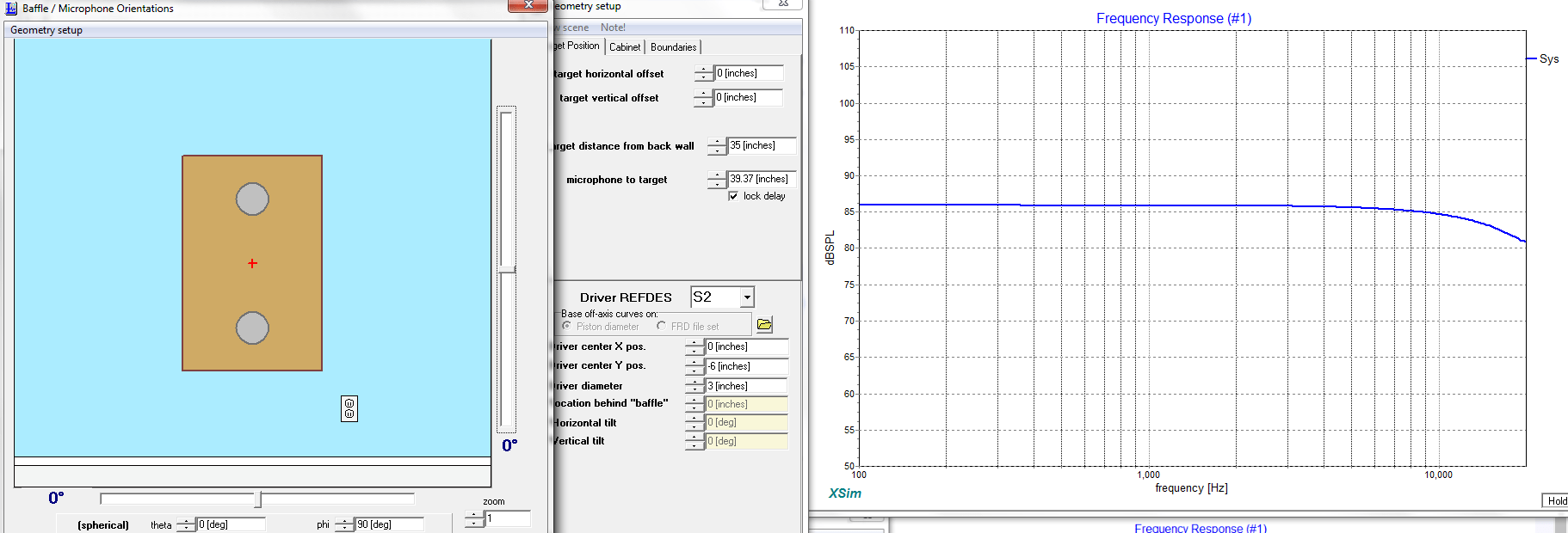

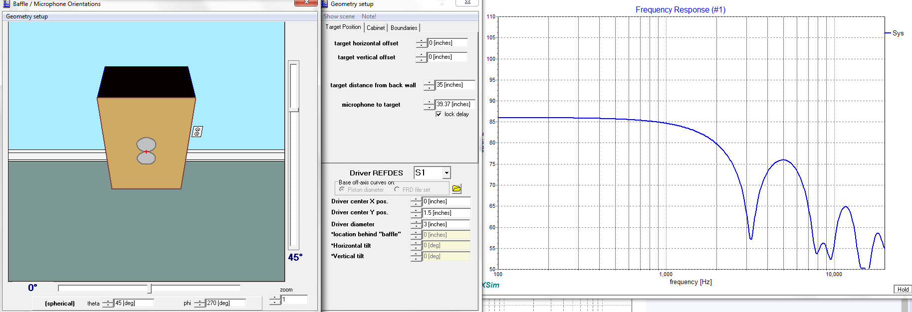

You experts seem to have missed the main discussion point which is simply: cheaper tower speakers often don't have the crossover network to prevent phase issues which results in a more diffuse image in the soundstage and thus a potentially "larger" sound. I did explicitly mention the things you said I missed which gives me the impression that your purpose here isn't to discuss the topic but rather pick nits at me. Which is discouraging and doesn't really show good faith.
At any rate, if we want to talk about experts then: a very well-respected designer emailed me about my video and offered some other ideas as well. He suggested the influence of baffle step wrt front wall placement as another point. I've heard a couple cardioid designs that eliminated this below ~150Hz and it is quite interesting that those actually had a larger (wider) soundstage than I would have expected. So, even on the basis of assuming that rear reflections can create a larger soundstage I'd have to say that I'm not fully convinced based on those impressions. But do not misconstrue me being "not convinced" with saying it is "definitely not the reason". A couple instances doesn't equal certain causality.
As for driver beaming calculations, this is straightforward. You can argue with Tom Danley, Vance Dickason etc. Hell, you can argue with physics. If you want to talk about horn loaded drivers then of course that changes. But the standard commercially available 2-way bookshelf speaker isn't using a horn loaded MF driver (heck, few use a waveguide on a tweeter). So the rule applies to these general cases. These are the people watching my videos. If someone is building a 10 foot tall midbass horn in their basement then I'm gonna guess they aren't watching my videos. They're probably reading the experts' posts on diyaudio. 😉
What I'd like to see you guys discuss is "should a bigger speaker sound bigger". I'd be interested in reading your thoughts on that. I am of the opinion that a speaker should ideally remain a pointsource and that if it sounds big then it needs to do so not because of phase issues. Of course there are aspects like room involvement, the overall enveloping sound of more air being moved, etc. But I think those are just "scaling factors" and not necessarily what a speaker should do.
This is misleading. A generalization that falls down here. Cheap does not equate to imadequate XOs.
… a more diffuse image in the soundstage and thus a potentially “larger” sound...
Tom is a ‘god” much in the same league as Nelosn. Vance writes a real decent basic primer on diy loudspeakers.
Th ephysics of a flat piston are not those of a cone with complex , usually concavish, shapes.
You.can use it as a generalization, much like saying bigger drivers need bigger boxes, the reality is much, much squishier and you have ot pay attention to that when you ar editing.
The cone + dome box.
Much smaller percentage of them here i would wager. Not really worthy of generalization. And a muxh larger concentration of 1-way bookshelves. Abd standmounts of all kinds in much more creative and usefuul shapes when it comes to soundstage/image/diffractuion signature, as well as more adequate contruction to suppress (potential) box resonances from middiying things up.
