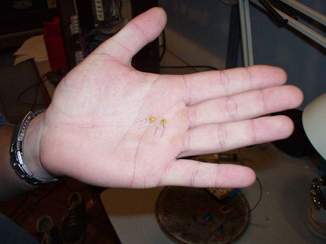

The other day i went shopping for parts for my amp.... the JLH uses a 470nF cap in the input, but i want to extend the low end a bit, so i decided to go for 1uF. Now, when i asked the guy for "something to get 1uF non-polarized", he gave me these 1uF caps... 2x2x1mm 😱 .
So, i asked them "wow! those are small... you know what kind of caps are these?" and he said "um, 'new' ones... some kind of multilayer technology or something". I measured two of these and readed .891uF each, which is impressive given their size. Voltage ratings are unknown, all that's written on them is the tiny '105'.
Any info on these? Will they perform correctly?

What you are referring to must be these very smooth, hard and glossy looking capacitors. They come in blue colour generally and have very high voltage ratings, in the order of kVs. These are ceramic types that are epoxy resin coated. However, I have not seen these in 1uF range.
If your capacitor is thin and flat, perhaps, blue or beige in colour, they are multi-layer and are of the plasic variety. They sound very good. I use 1uF and 2.2uF, both 5mm pitch, regularly for input decoupling. They are just as good as any plain or metalised polyester, polycarbonate, polypropylene types. I have compared the former with the latter types from WIMA, Matsushita, EVOX, Thomson etc., and the sound does not degrade. There might be more exotic ones from Solen or others that might be better, but......
So just go ahead and try them out.
This one's yellow, if that helps 🙂 So it's a plastic one, that's good. I'll let you know how it performs; it's right at the input so if it degrades the signal it should be very apparent.

Ok, back to this topic. I checked with a local electronic distributor and these are, indeed, PLASTIC caps (polyester apparently), and not multilayer. The dielectic/conductor arrangement itself it's microscopic, and beats the heck out of me how they did it but it works. Voltage range is comparably low, 30V.
To my ears they sound as good as any polyprpylene cap i've tried. Down here they're about ar$1,10 each (us$.35 aprox.), and i've already got a few for my preamp!
