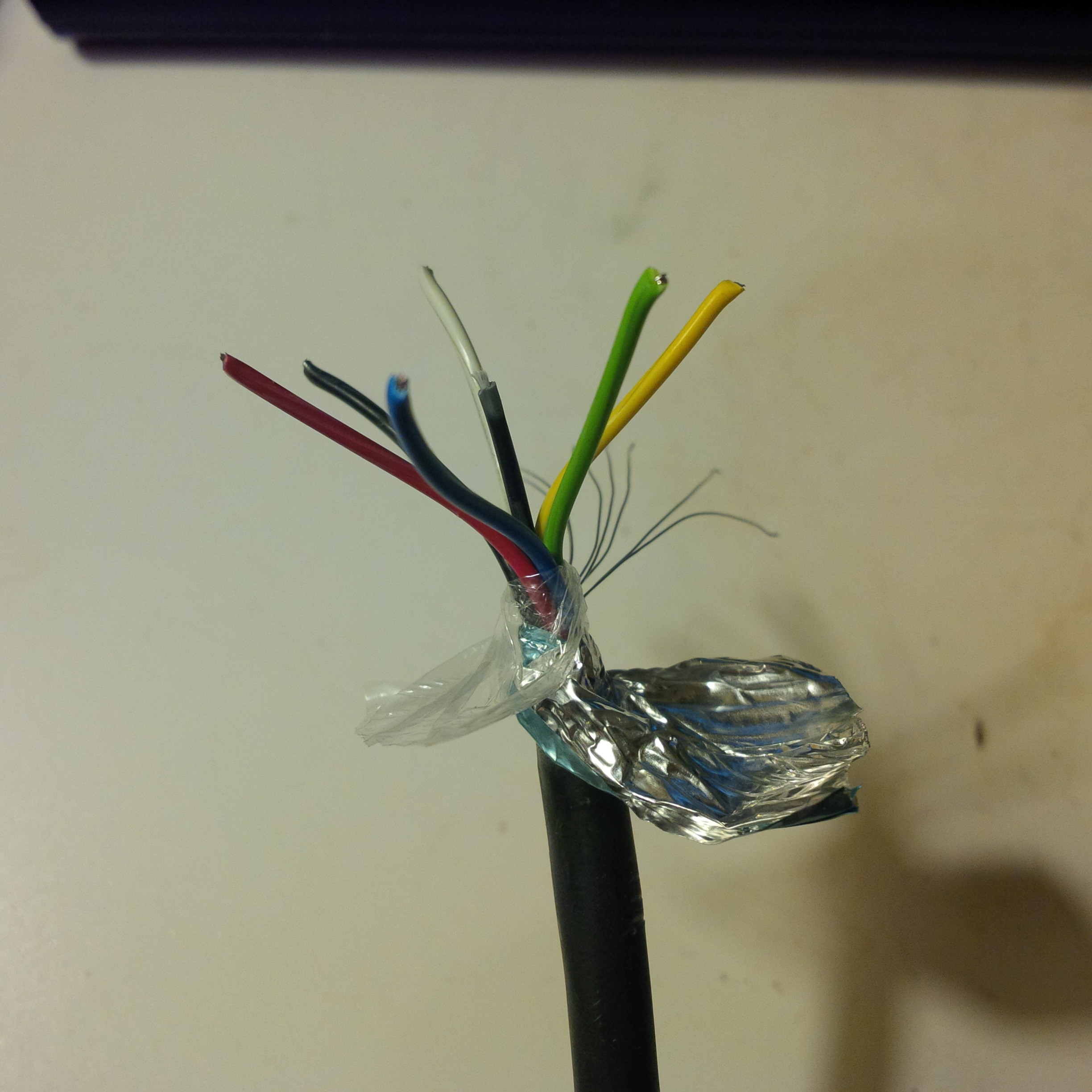

I've just made some interconnects from CBBR4161. The individual screening is handy for taking each conductor to a phono plug, but I've had to get creative with heatshrink to cover the floppy thin exposed cables that look a little weedy coming out of the plugs. I don't think they're going to break though. Here's one I've just finished for a friend - playback and record for a Uher CR 210.
The same cable worked fine for a DC interconnect where I paralleled the conductors for a larger copper area. They were all inside the same DIN plug so there wasn't the heatshrink issue.

I've not found an easy way to do this it just takes ages to do this to ensure the screening and individual cables carry through, I should have platted hair......
I have used individual Belden 8412 with screening to 4 pins connecting inputs to naim processor, if you are careful and plan it its not difficult tbh. Old post I know :cool:

That's a neat cable! I'm about to set to making a few of the Uher adaptor cables mentioned in their manuals. Locking microphone leads etc. I'll use your pictures as a reference to make it look 'meant'. I think most of mine so far look a bit bodged, even if they are solid and electrically spot-on. There are so many little tips and tricks to do with getting things tidy (after worrying about making sure the right parts of the connector are on the wire before soldering)...
