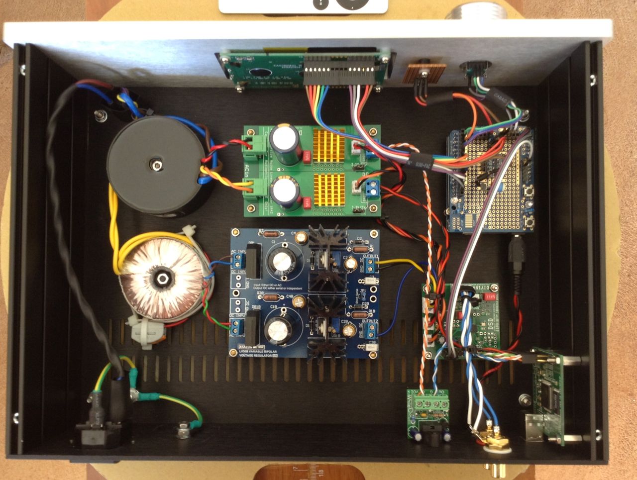

I don't really understand why the external soundcard needs to be inside a chassis? Maybe a picture would help.

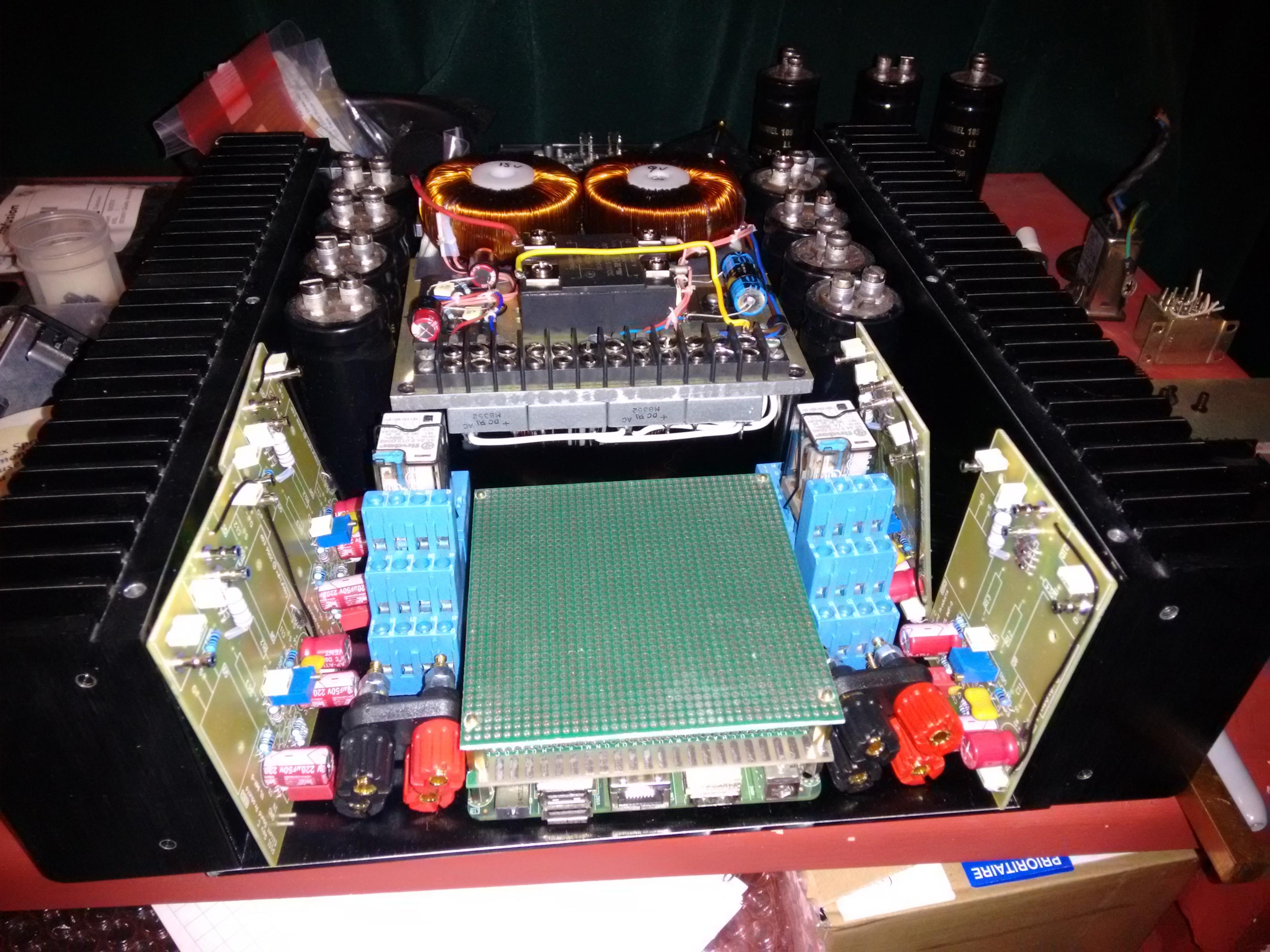

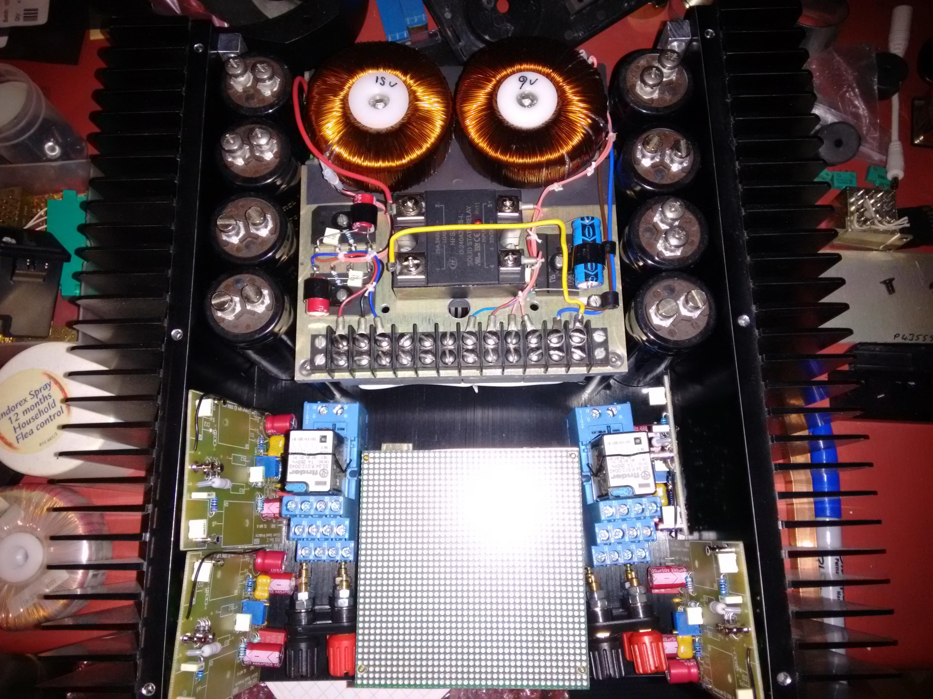

here we see a view from what will be the rear. in the forground you have 4 modified ESP101 mosfet amp PCBs, two speaker protection relays and the source stack which comprises an intel NUX motherboard at the base, and some unpopulated pcbs above it. the stack will have regulators, an arduino to tie everything together, speaker protection circuitry, usb interface, DACs and finally at the top a motion feedback PCB. in the background you have the smoothing caps and power supply section. the two transformers on top are for analog and digital supplies, the power transformer for the amps is under them and only just visible.
another view form the top
as you can see it's quite cramped and what free space there is will probably be taken up with wiring.

That is a bit of an understatement!
The simple option is to put your external audio interface on the top of the chassis and cut holes for your USB port and audio input signal connectors on the back panel.

Consider isolation of the DAC's as with them connected to usb with an arduino and all that other stuff you are very likely to get ground loop issues unless you use some galvanic isolation somewhere.

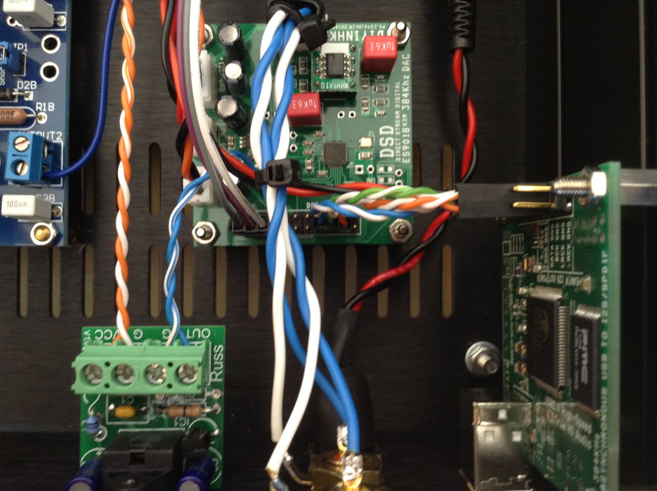

I see that you are running the DIYINHK usb in multichannel mode and I hope that
you can verify the I2s connections for me. I did a "paint job" that looks like this.
The driver/mixer gives me 6 channels of output in both win7 and win10 but I haven't connected it to anything yet.

Yes that is right, matches the legend on the back of the board that I have.
Be aware that there are different versions with different firmwares so the pinouts could be different. Diyinhk could not tell me which pins were used for the sample rate indications.
I have only used it with macOS and that gave me 10 channel from memory, it definitely had the full 8 channels that the ES9016 could use. I tested that.
It is possible that you have a different firmware as there are some that only have six channels at a higher sample rate. Mine is 192KHz max.

What version of firmware do you have?
I have v21.02 and in this firmware 8 channels to the input and 8 to the output.

I don't know which number it is, there are the 8 channels of i2s but also 2 channels of spdif I think which made it appear as 10 in 10 out on my macbook. I can't remember exactly and I'm not in a position to plug it back in and check.
My point was that it makes more sense to look at the legend on the back of the board to see if it is the same. There are different firmwares available for 6 and 8 channel as well as different versions of those. When I asked diyinhk about the other pinouts that were not marked the response was to test with a meter.
