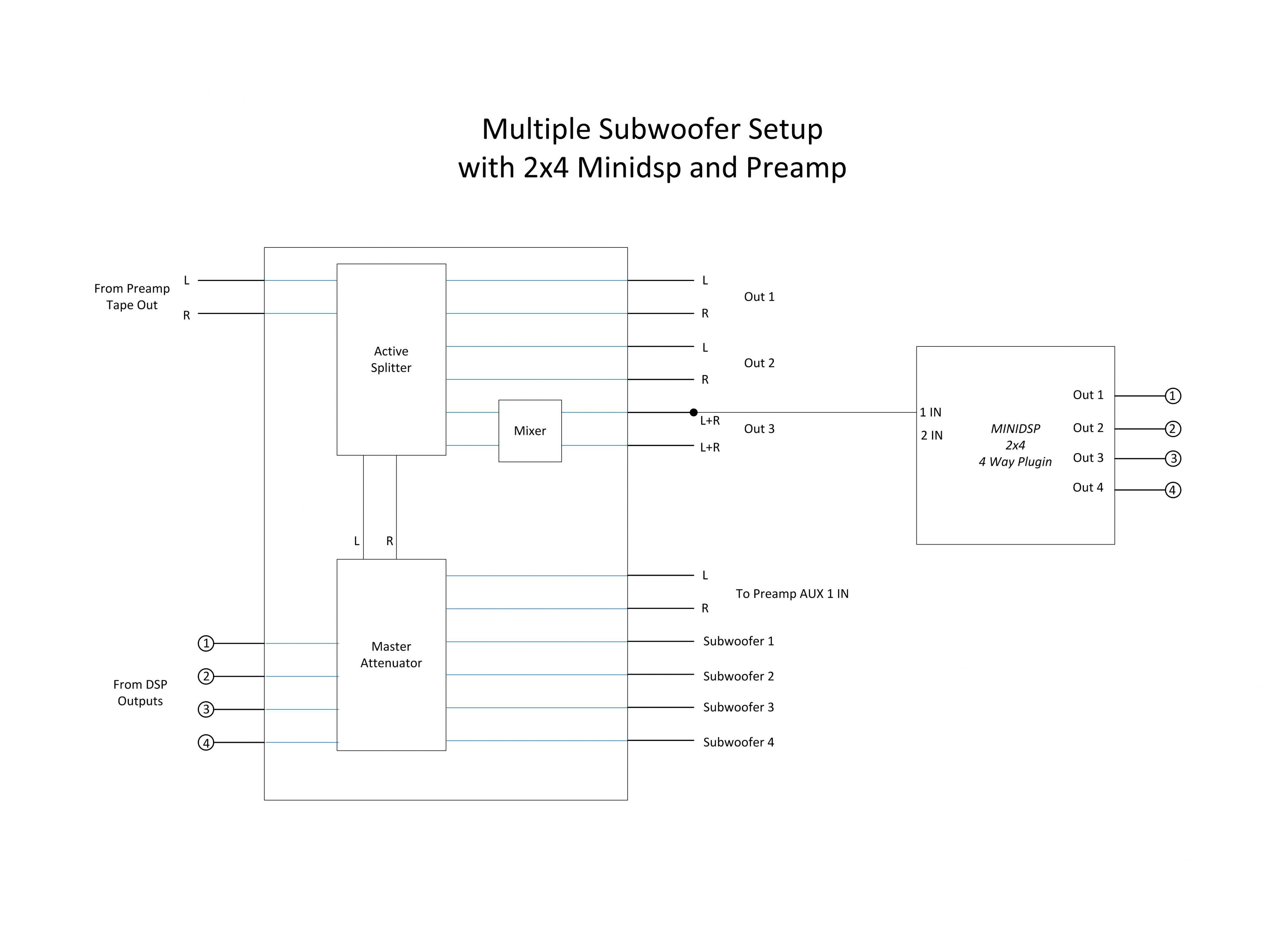

I figure that most people that have active crossovers and multiple subs need some type of solution to source and feed all the different amps. Hopefully some of you already have built something similar and will be able to assist.
I have been playing with both MINIDSP active crossovers and multisub setup to equalize room LF. The problem I always have is the gain structure of the MINIDSP. The minidsp likes a full line level signal. Using the minidsp for volume control is not good IMO.
Has anyone build something like this diagram below or know if something similar is commercially available for home use (small, nice looking unit).

Looks really good! Like you say, I would still need the splitting/mixing portion.

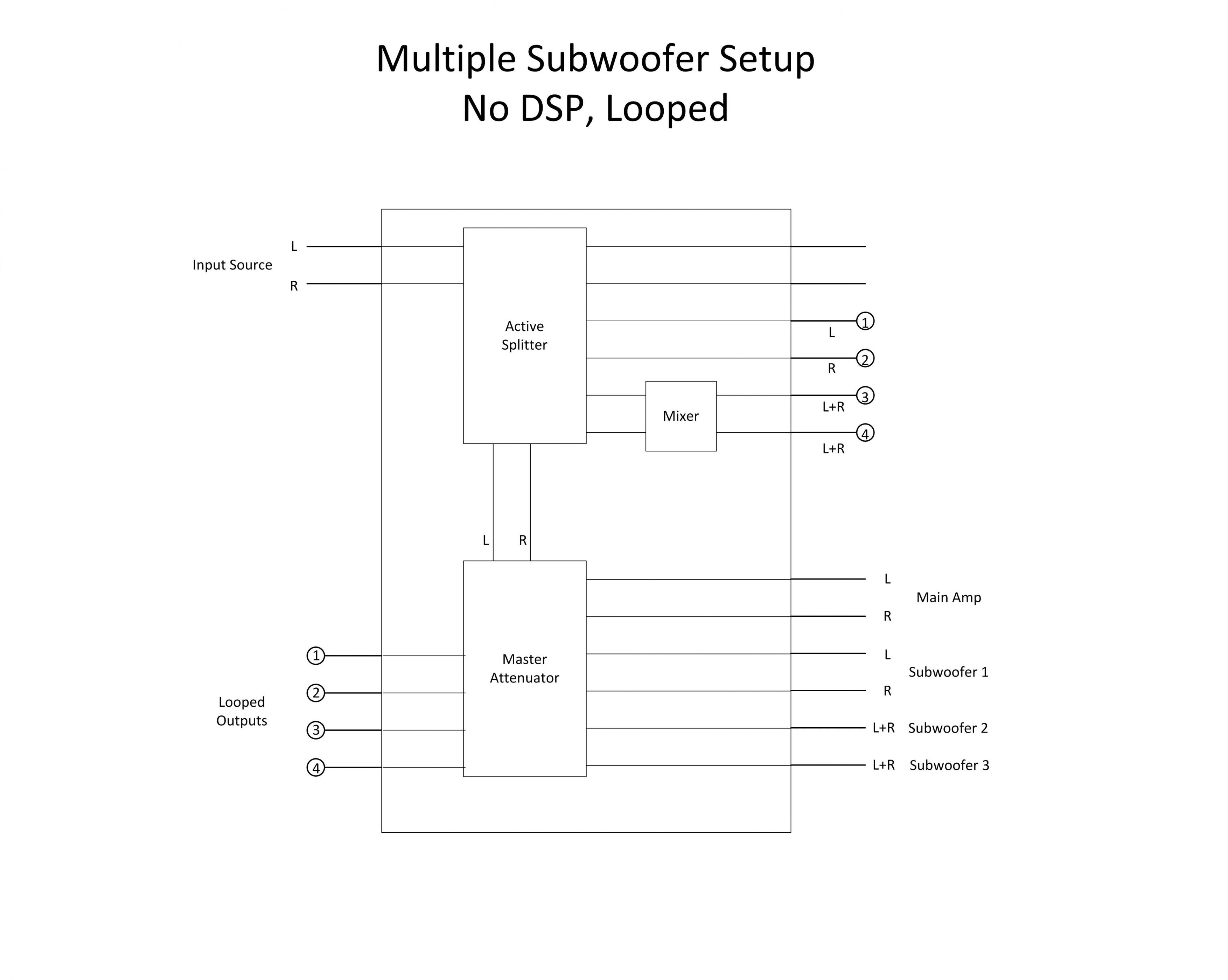

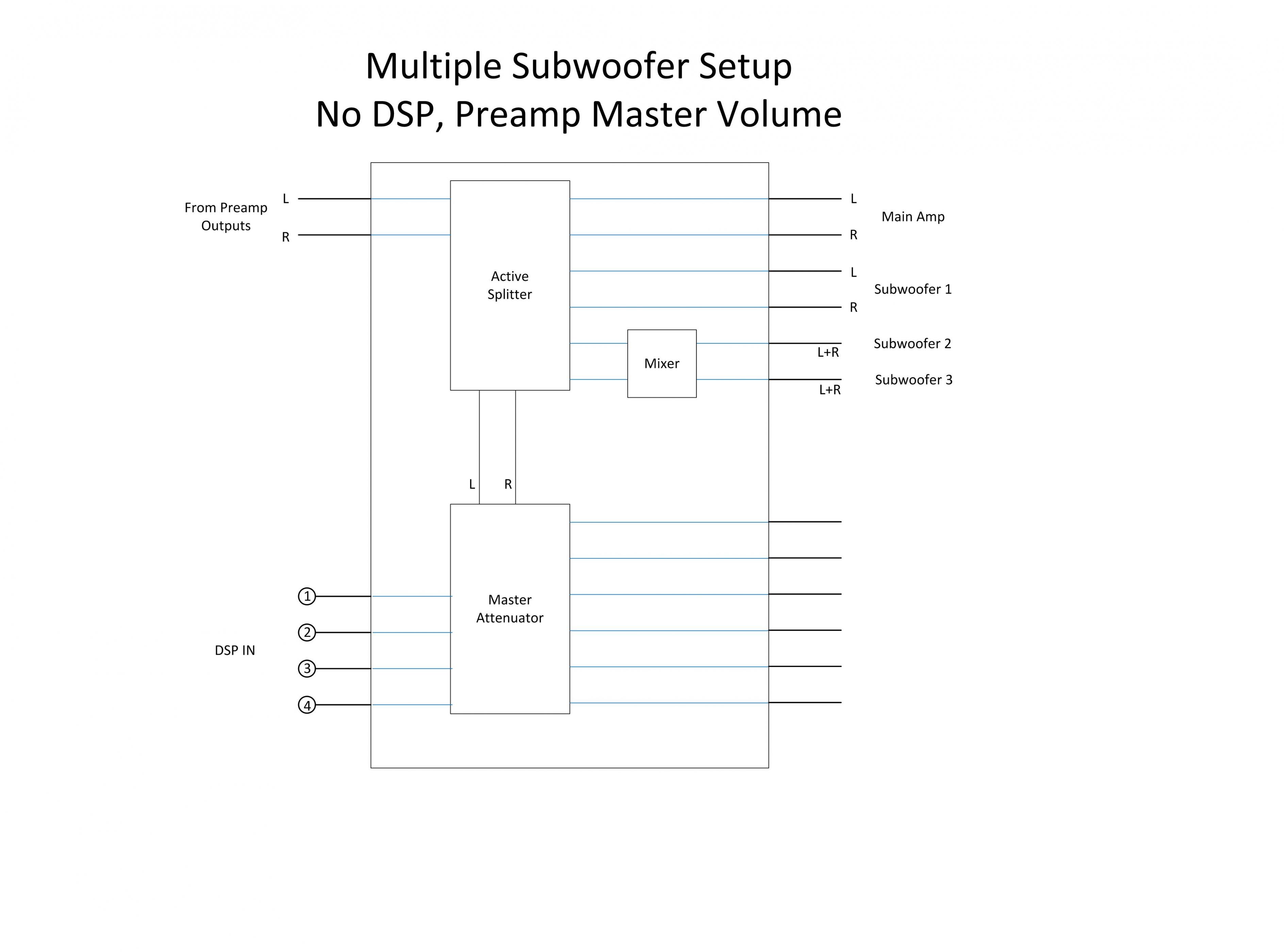

I think the box could be quite flexible. The drawings below are applicable for multiple sub woofers, but similarly it can be applied to 2/3/4 way active crossovers.
I have been researching and I am initially leaning towards using DIY B1 Pass buffers and a LDR master volume control.
If I add input selection I might be able to eliminate my existing preamp from the chain. I have started to purchase some of the components already.

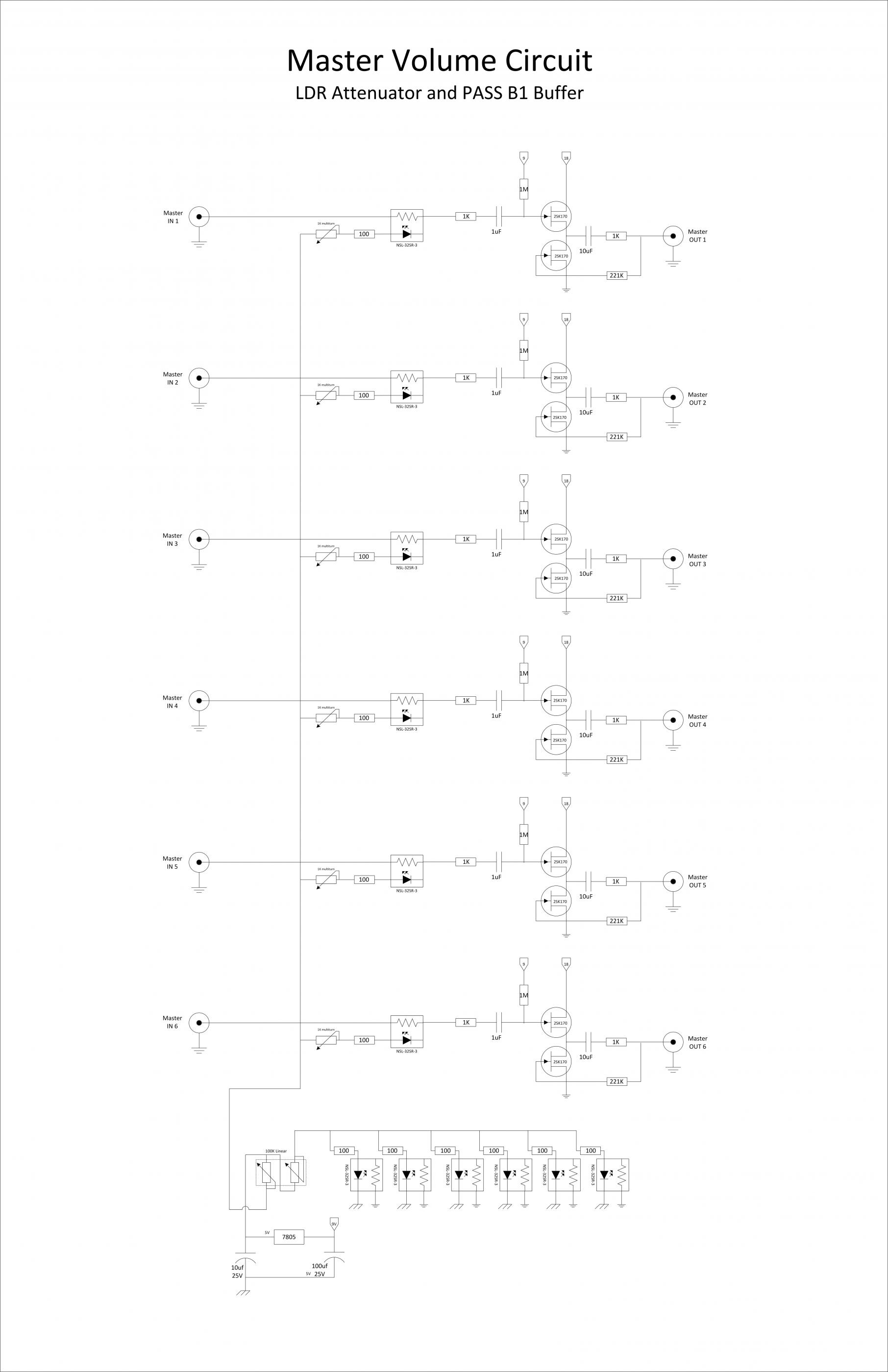

Master Volume Proposed Circuit
Here is the master volume proposed circuit, I simply took the respective designs and spliced them together.
Pass Labs B1 Buffer
DIY LDR Attenuator
There is a circuit from Nelson Pass with both the LDR attenuator and a Buffer. That one requires a complimentary to the 2sK170 that is hard to get and would not be cost effective for me. The B1 uses two 2sk170 per channel. I got the 2sk170 for $0.38 each at MCM electronics (hope they are not fakes). Bought plenty so I can match pairs.
My plan is to use a large DELL 19V laptop power supply to power it. I will definitely have to test if in the end I will have enough gain for my system. I think I will, I have >95db speakers.

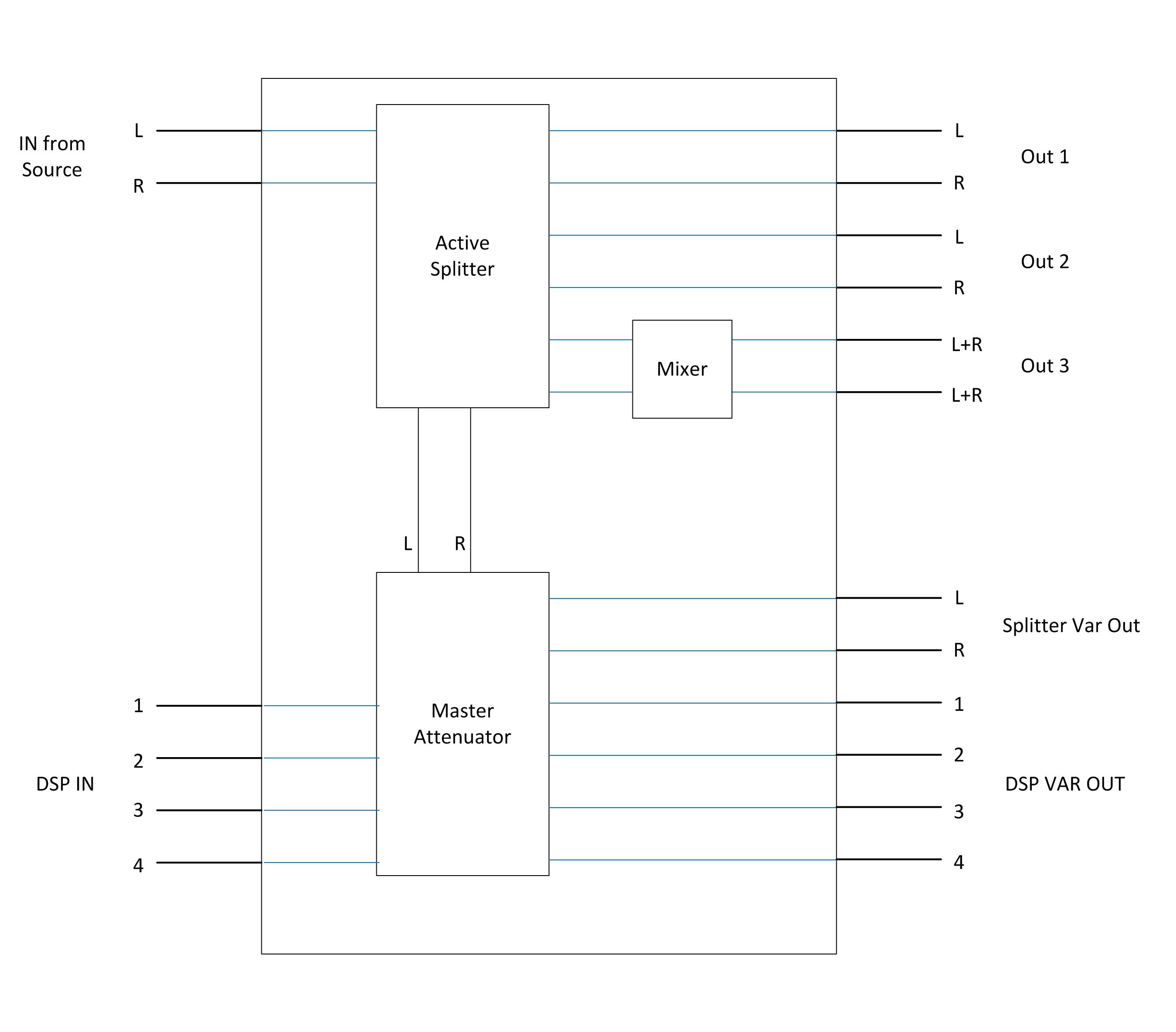

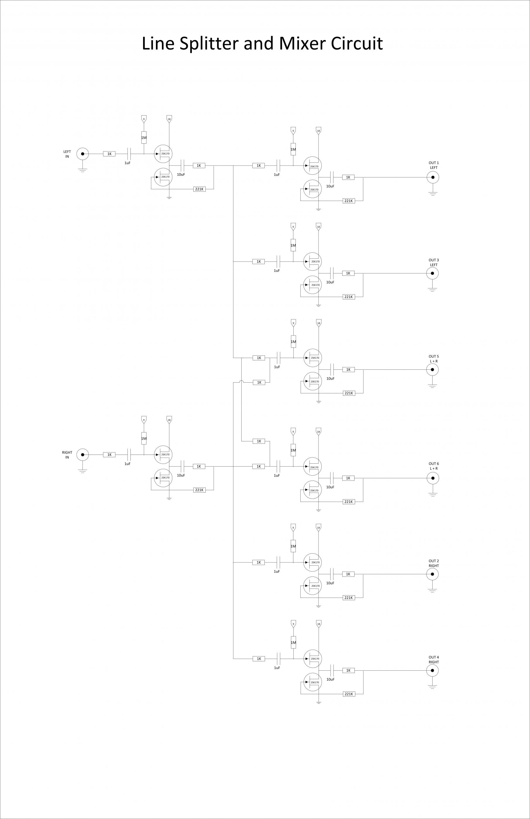

First Pass at Splitter and Mixer Circuit
For the Splitter buffers and mixers I also used the B1 buffer. I just put modules back to back. I think I may be able to remove either the 10uf Cap on the input L & R buffers or all the 1uf on all the output buffers. Can someone confirm if my thinking is correct.
Does the mixing seem correct? Will I need to attenuate the L+R outputs?

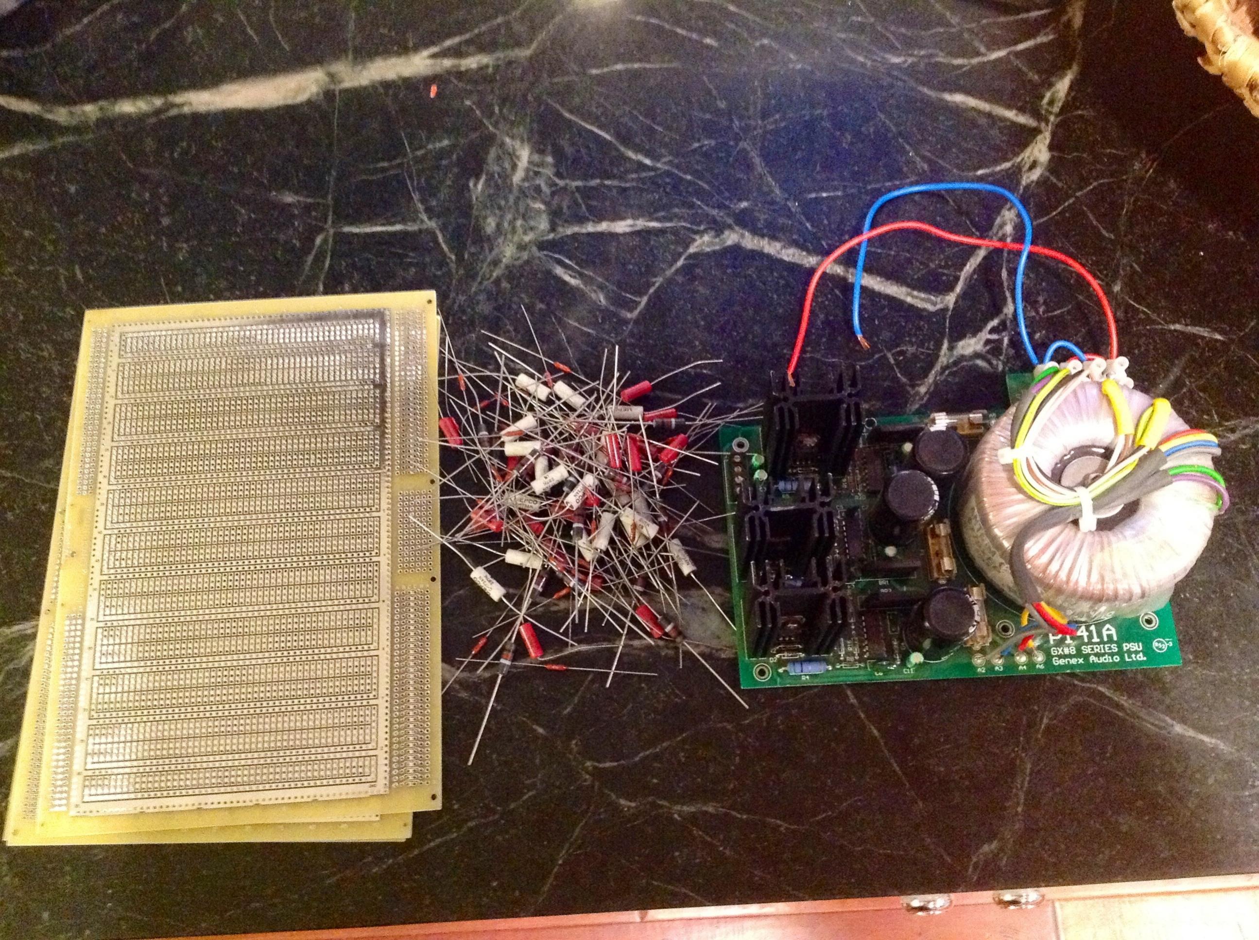

A bit more progress on the sourcing front. A trip to the surplus store yielded all the resistors needed, all 1% and appear to be of very good quality. Also as a surprise, i found a nice regulated power supply made by Genex Audio. I believe these were made for their 8 channel ADC and DAC. It puts out 5v and +- 15v. It is probably too high but changing the regulators r1,r2 ratio will change the output. Already tested with a Decade box and a 1k resistor brings it to +- 9 volt.
Lastly, found some proto boards that appear to be silver plated.

i'm not 100% sure the other outputs are configurable but if memory serves you can turn any output into bandpass that may or may not serve your application
i'm wondering what the criteria for multiple sub outputs is? there are several multiple mix matrix's units that are used for zone paging applications that might also fit the bill but if x-over and level control are required on each output you could be more in the realm of a Protea
i've personally had success in using LM 1972 N ic as digitally controlled attenuators and combined with minidsp you may well being on the way to rolling your own!
