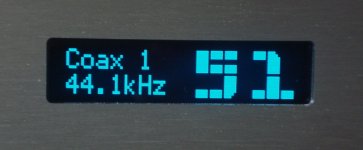

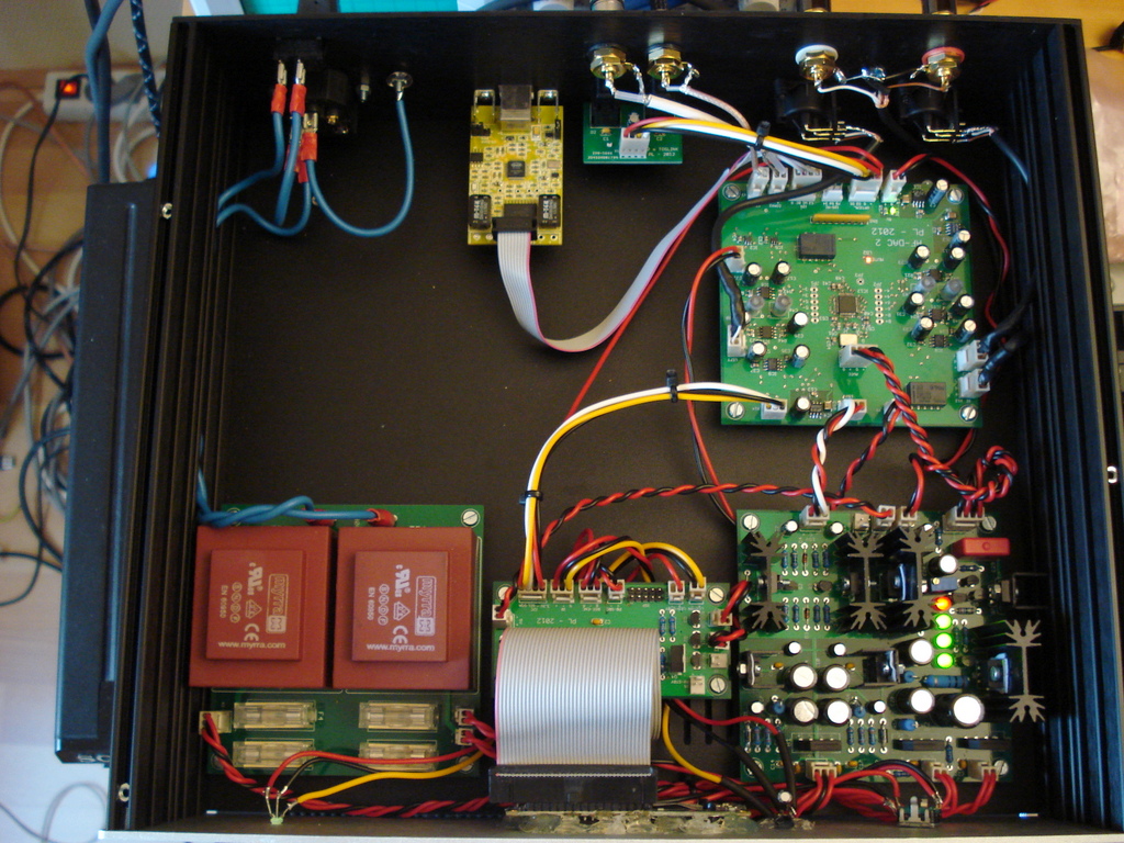

I developed an ES9016 based dac with 2 I/V converters onboard. I have an expansion board available for 6 additional I/V converters that can be stacked onto the dac board.
At the pictures you can also see the supply and controller boards.
well there you go...
