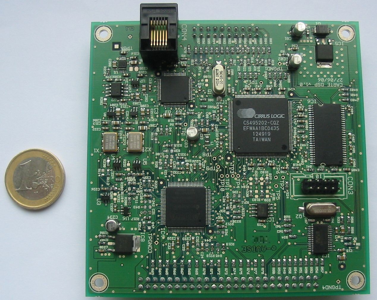

- Digital Line Level
- MULTICHANNEL DSP ...using Cirrus CS497XX chip ..help
