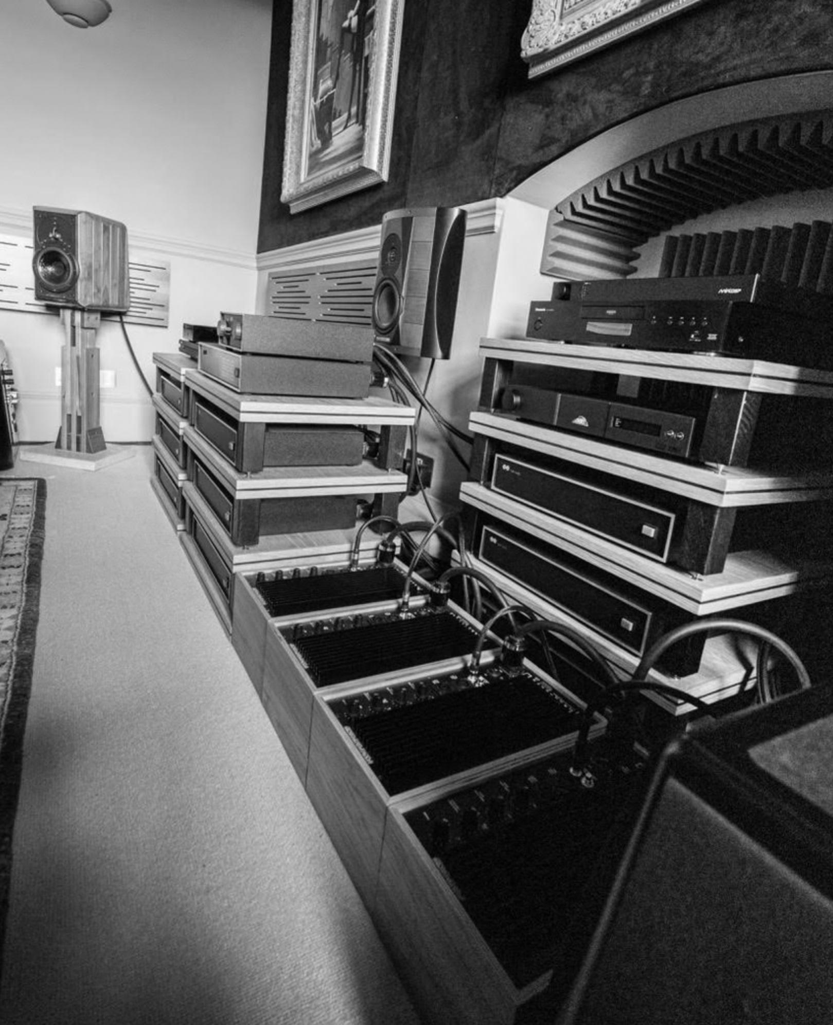

I have a 15" subwoofer I built, using 25mm plywood (you can see the cabinet with the green grille in the image of my vintage system!) and I use this subwoofer amp BSBPV500
