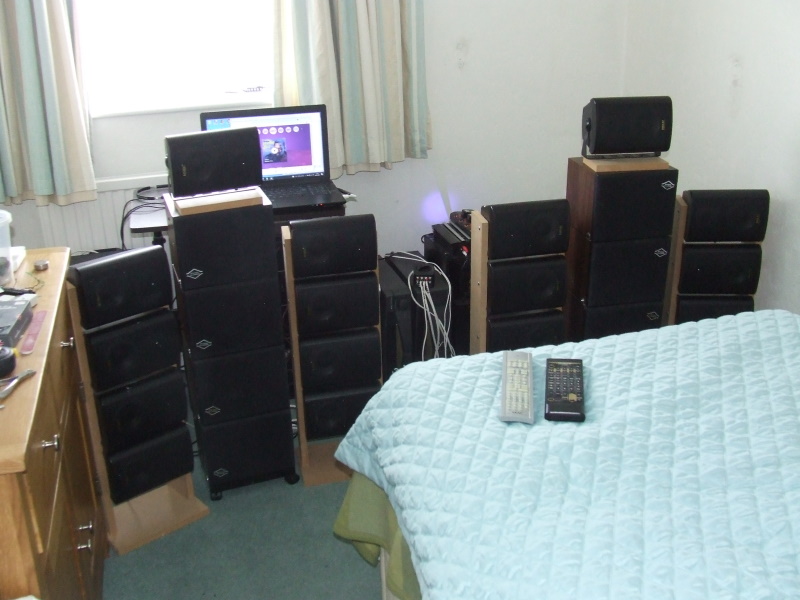

Talking of space constraints, there are 26 speakers in the attached photo, that you can see, and a further 12 you can't see! At least the bed is comfortable.
As a further twist how about turning the stacks bipolar with the sane amount of speakers facing backwards? A bit of BSC for free.
No thanks, but thanks for the thought. Shouldn't that be "INsane amount of speakers"? 😉

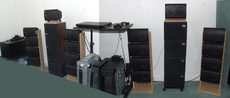

I can quickly throw together a 6 speaker system where I am now, but again it would be 3 different pairs. Might give it a try for the heck of it. What surprised me about my first try is that it didn't kill the stereo image, collapse it or make it into a uniform block. Left to Right was well preserved.
Six identical speakers ought to be much better. I hope to test it sooner or later.

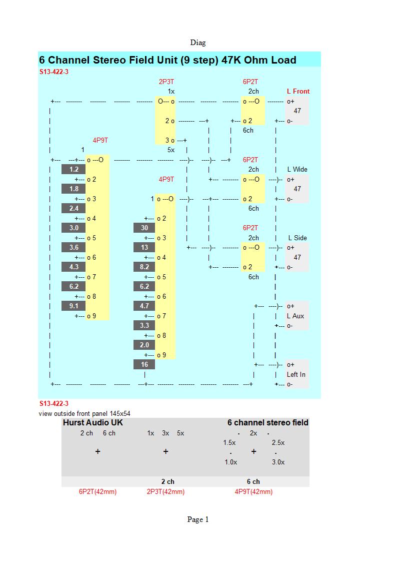

I don't see a schematic of the Stereo Field Unit circuit, just assembly instructions. Is there a schematic?
You use the acoustic time delay from the more distant, wide field speakers for added spaciousness?
That could take some time. I'm considering whether just talking you through it would be quicker? Anyway, here goes...
This description is in a logical order. It does not match the order of the actual circuit. The drawing of the facia gives you the logic elements:
1. A 6P2T switch switches between 2 channel and 6 channel mode.
2. In two channel mode a 2P3T switch switches the output between the three pairs of outputs: Front (1x), Wide (3x) and Side (5x). This is used to:
a) Provide an A:B comparison between 6 channel and ordinary stereo (1x).
b) Indicate the widest setting that is useful (3x).
c) Check that the system is wired correctly.
3. In six channel mode you can vary the setting of the width of the stereo field from 1x (stereo) to 3x the speaker to speaker (or stack to stack) distance, in 1/4 width settings.
I hope that helps...

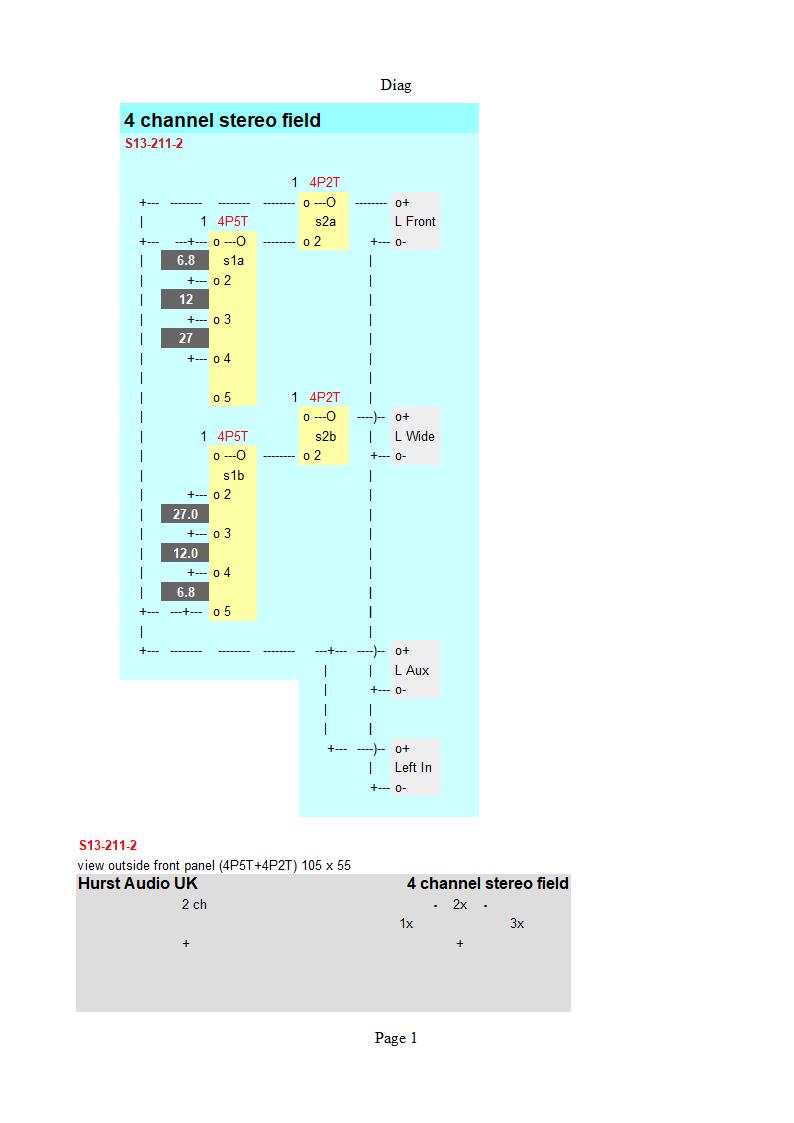

Would four matching speakers be more achievable? Four speakers can double the width of the stereo field (for a given speaker-to-speaker distance), or allow the speaker-to-speaker distance to be halved for a given width of the stereo field.

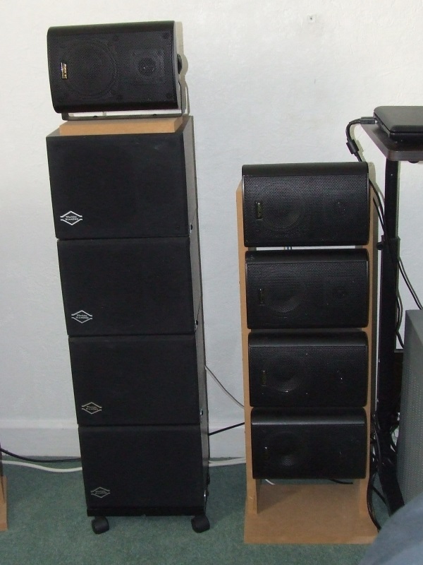

I have rearranged my listening room to place the speakers against the longer wall and I've finally had a chance to listen to the MSX-07's. What a surprise. Compared to a pair of MSX-07's the four stacks have powerfull presence and authority, Of course, I have no idea how the stacks would compare to "real" power systems, but at only 75cm (30 inches) tall they impress me!
